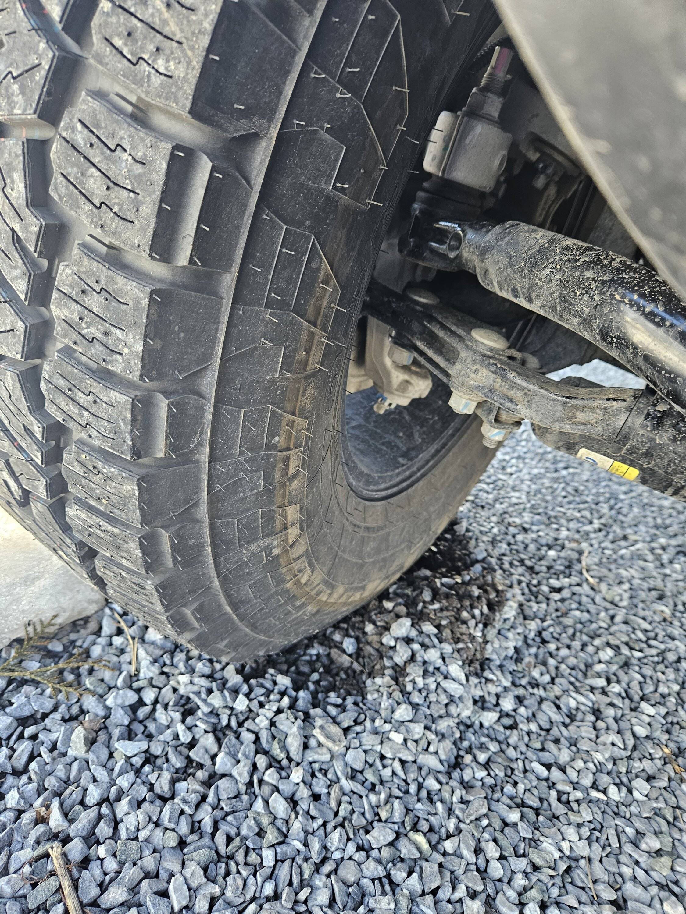

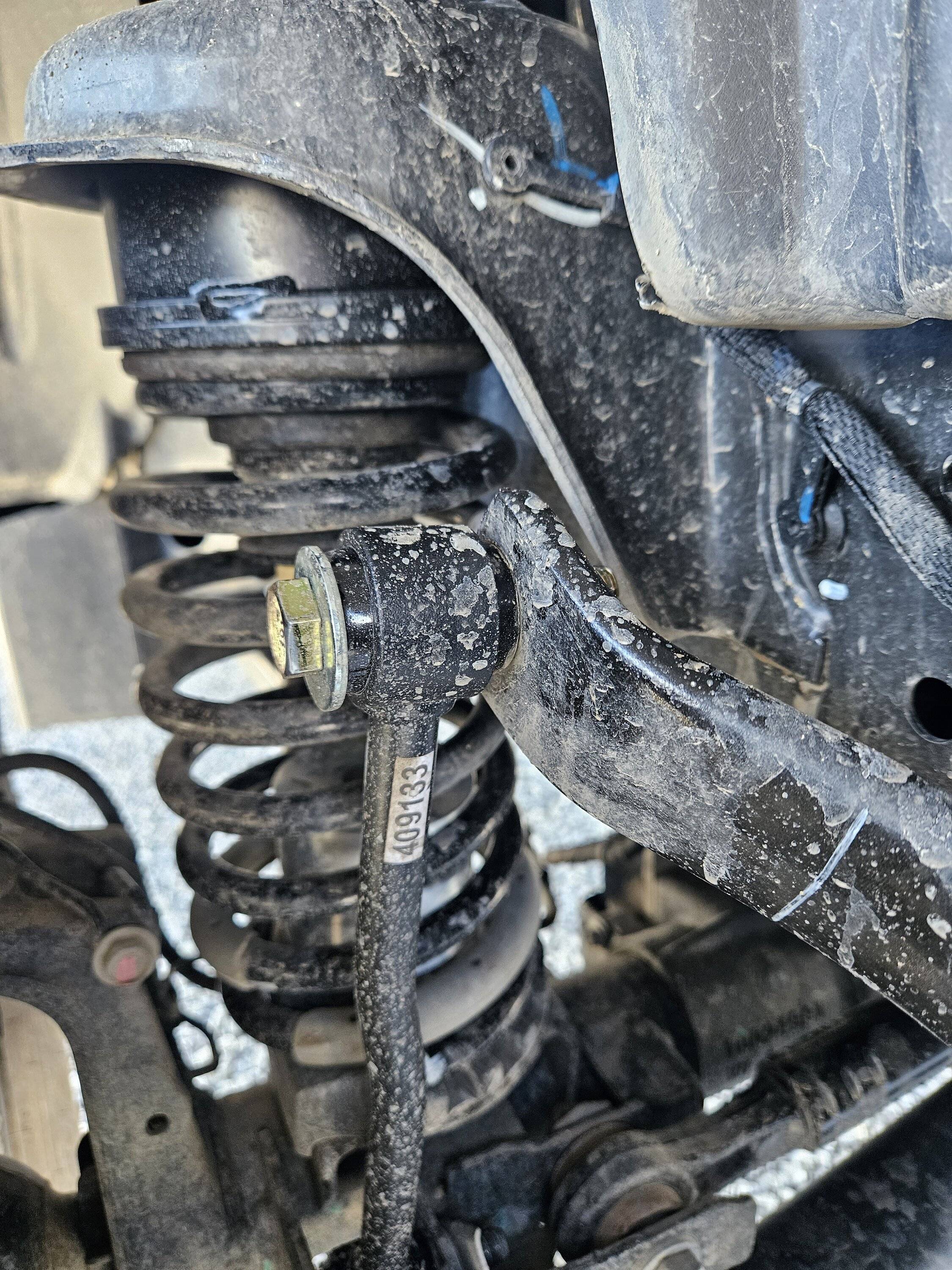

I'm wondering if we're my is not a max tow I'm having a issue. Just got lift installed today.
my passenger side tire on hard left driver side turn at full cut my wheel is slightly rubbing on the the sway bar link nut.
I had bought a set of wheel FAST HD SUMMIT but they don't fit lol. been a interesting day.
I ended up running stock wheels but just rub in reverse only full cut drivers side.

you can see the slight rub on wheel and the wear mark on bolt head.

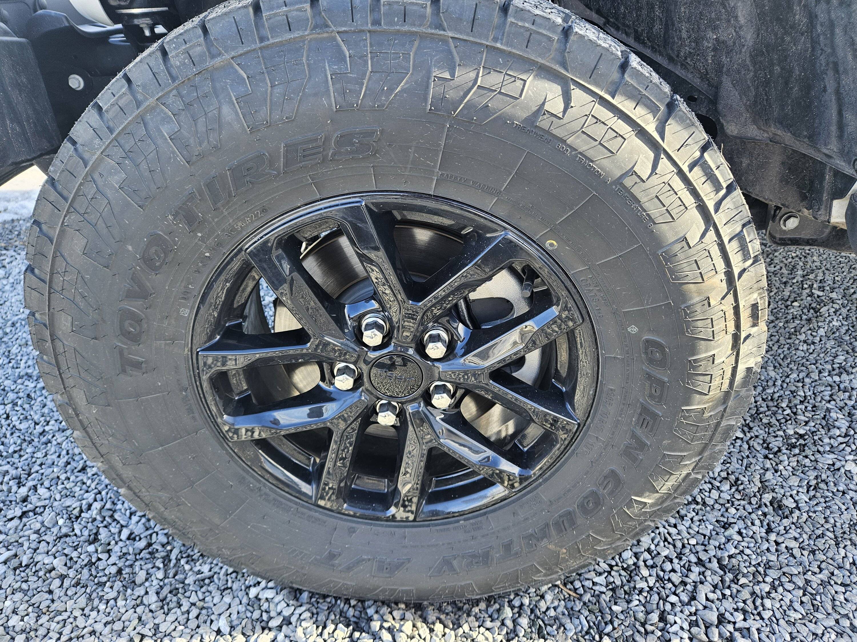

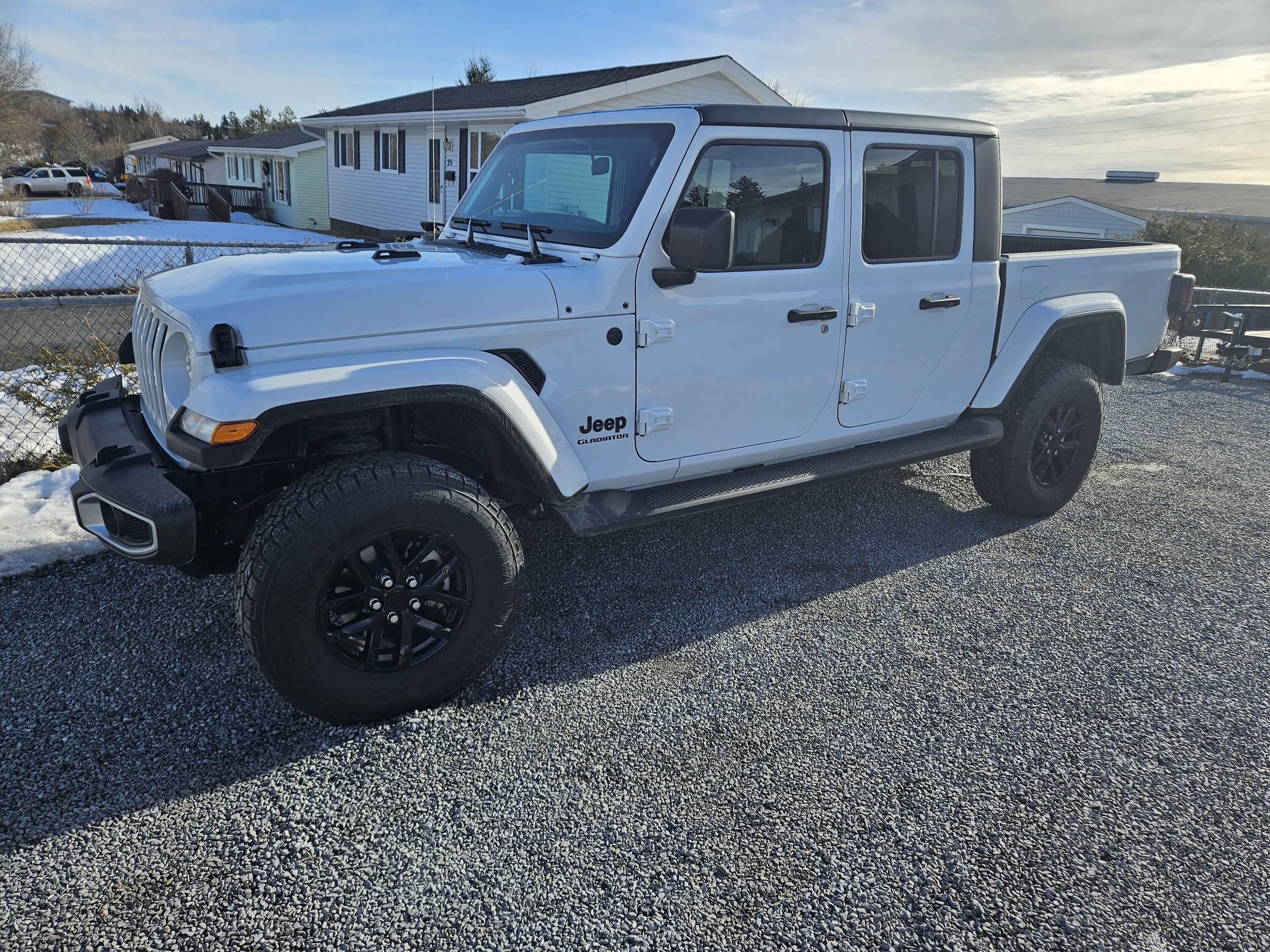

I'm running a 2023 gladiator sport s. Toyo open country 285 70 17 at3.
Debating now a running a 1/4 inch wheel spacers. not sure if i do if wheels will be hub centric still. or look for another after market rim

looks like I found the issue. The kits requires you to remove rear sway bar end links and install them on the front. And take ready lift supplied 10 inches sway bar links install on rear.
The width between the two are approximately 3/16 of a inch narrower if rears installed on front. and that should give enough clearance for tire.
