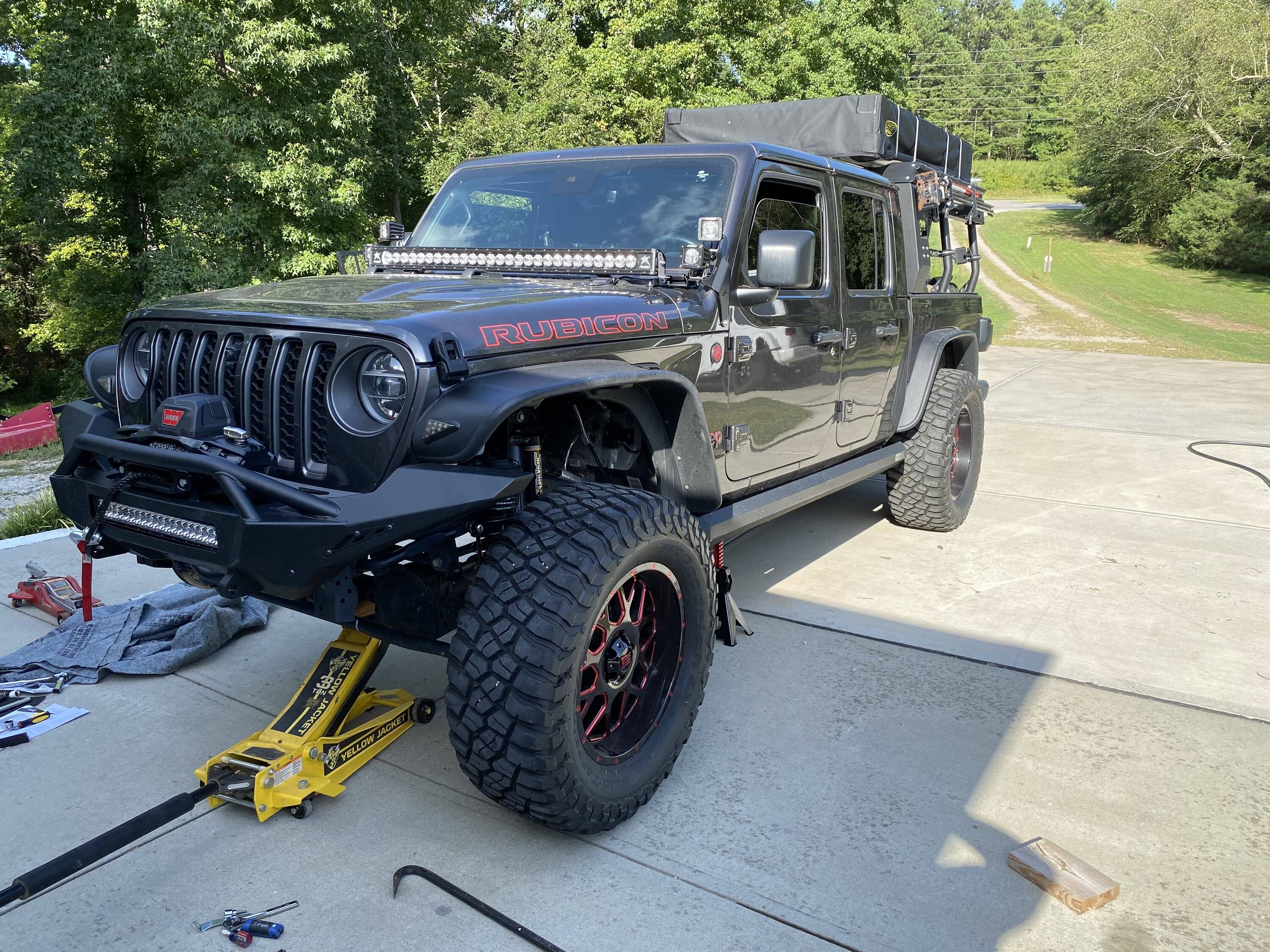

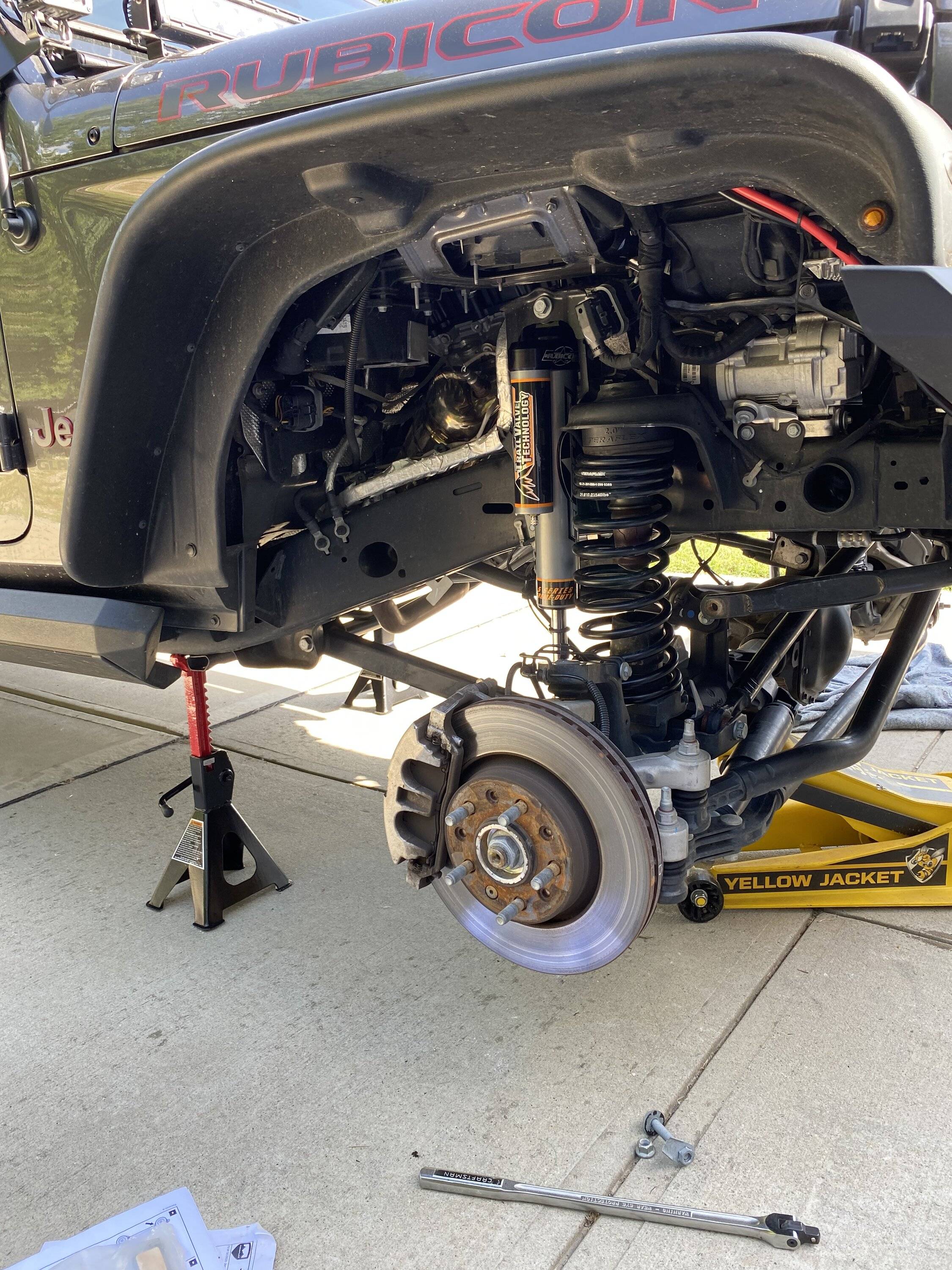

I just installed the Skyjacker 2.5" spacer lift on mine with LCA relocation brackets.
No need to unbolt the front driveshaft and I installed the brackets at the same time.
The rear is 1" and did not come with shock extension brackets
The 6 ton jackstands will work just fine but you'll need to have them extended a good bit in order to lower the axles

I would do it all at one time. Too many overlapping steps to do it separately. Definitely will need jack stands as high as you can get. You may need a ratchet strap to pull axle to line up bolt holes. Sometimes things shift while doing it on the ground.
For sure can do it with basic tools and by yourself.
