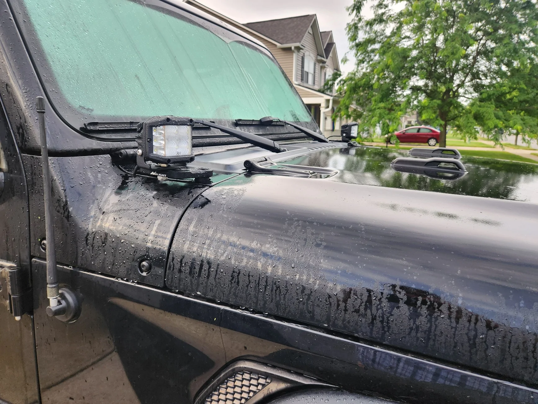

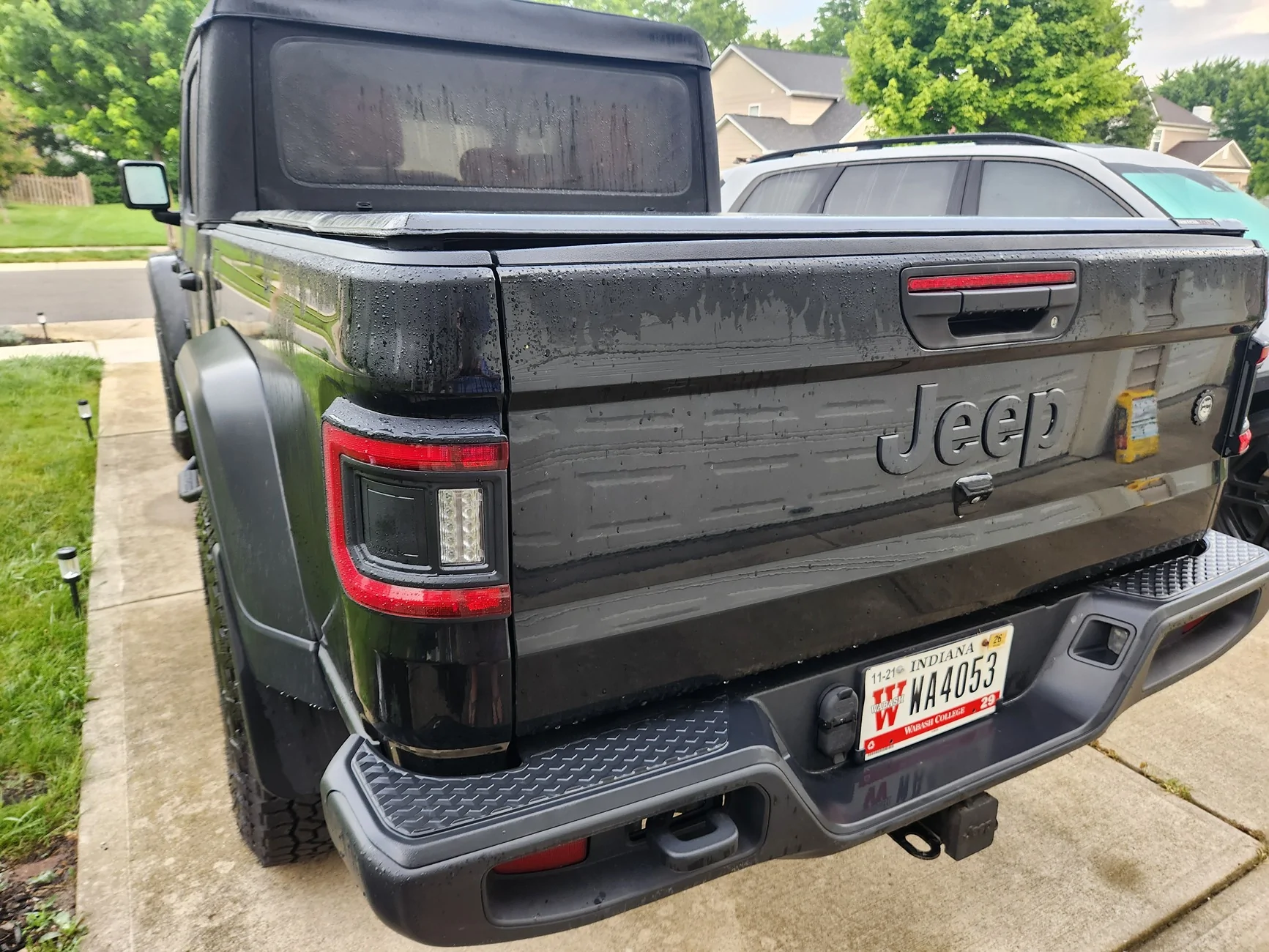

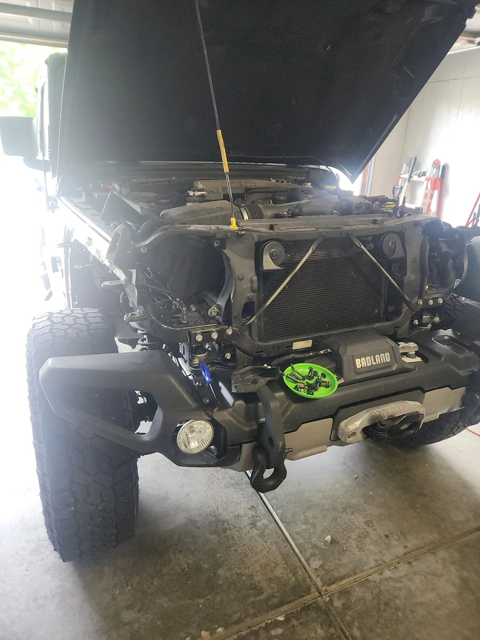

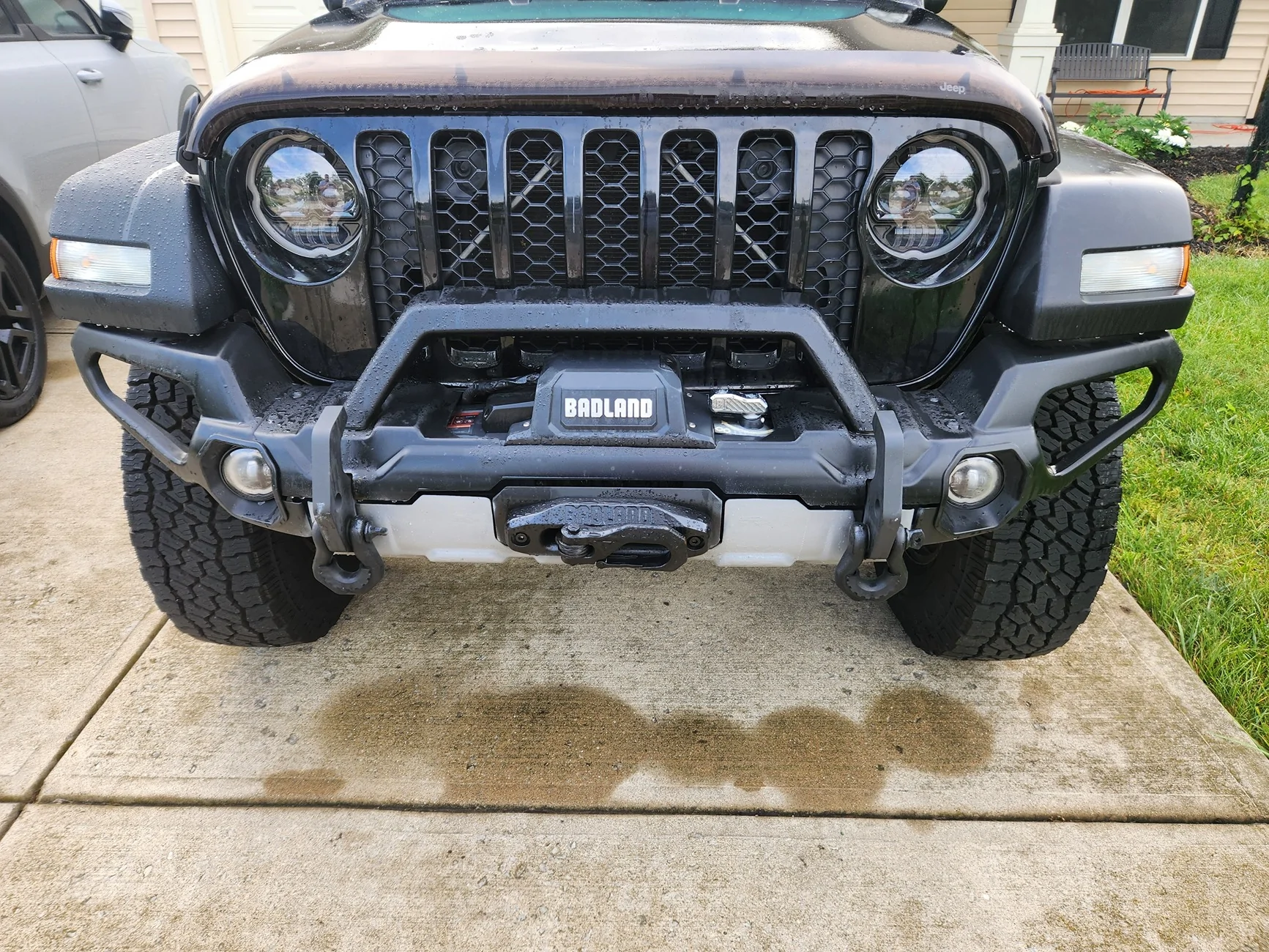

The bulbs were direct replacement for the turn signal in the OE lamp. It's cloudy and rainy but got pics I could. If you just do the turn signal bulbs, no need to remove fenders, can get to it all without too much trouble. Grill has to come off for headlights but its easy. If you haven't I recommend getting a package of Jeep fasteners. All those clips, rivets, etc that tend to break. Having a bunch handy saved so many headaches.

Also have roadshock rock lights to install but with the colossal PITA that was the turn signals, I didn't have time or patience so they'll be another quick upcoming project.

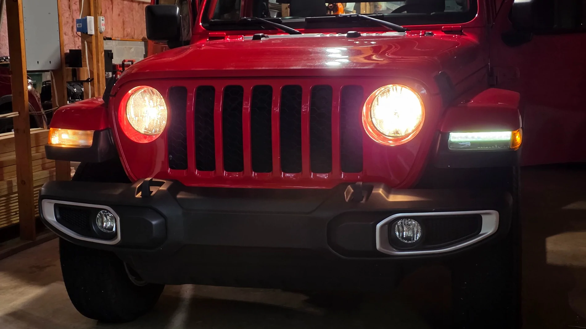

So I took a chance since I found a set (separate sellers) locally with return policies. I only have one right now, but it works and fit great. Part number 55112885AG. I was able to do it without removing the fender. Tough, but not as bad as I thought. The only issue I'm having now is DRL dropout isn't working. Here's my tazer settings:
DRL Type: USA
DRL Loc: Dedic
DRL Drop: Yes
LED FTrn: Yes
Full reboot and 2 sleep cycles were done. Also let it sit afterwards for 10 minutes. Any ideas why the DRL won't turn off with blinker activation?

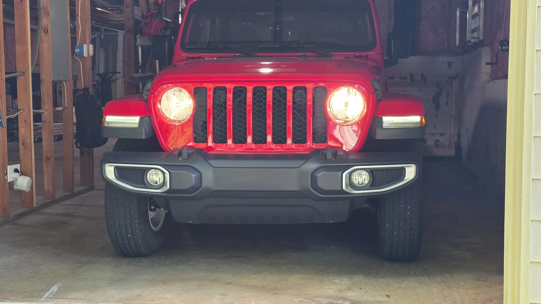

Got both installed. Oddly enough on the way to pickup the passenger side, the driver switchback function worked. Got home, installed the passenger, and no switchback. I reapplied all the settings, full reboot and 2 sleep cycles. I guess I'll let it sit and test it in a few hours or tomorrow morning. 🤷‍♂️
