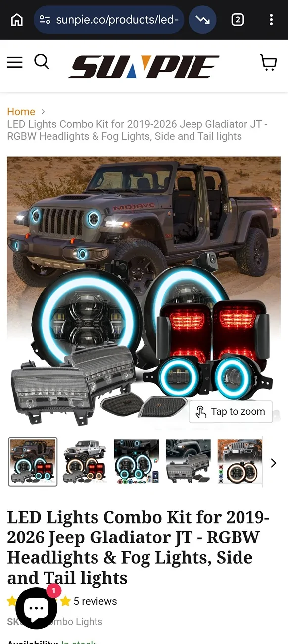

Hello, I have a 2023 Sport S with exterior halogen everything. My end goal is to upgrade all of this with as little modification to brackets, harnesses, etc. as possible. I prefer OEM or at least OEM looking as much as possible, but would consider smoked lenses. I'm mainly having trouble finding things based on fitment. Everything seems to exclude Sport due to depth issues and it's borderline confusing. I found this kit that looks like it would work, but I don't really want all the RGB style or even the halos. I know of these part numbers but get conflicting information on fitment.
55112884AG and 55112885AG
Jeep Gladiator 2023 Sport S Full Exterior LED Upgrade Screenshot_20260607_075104_Chrom

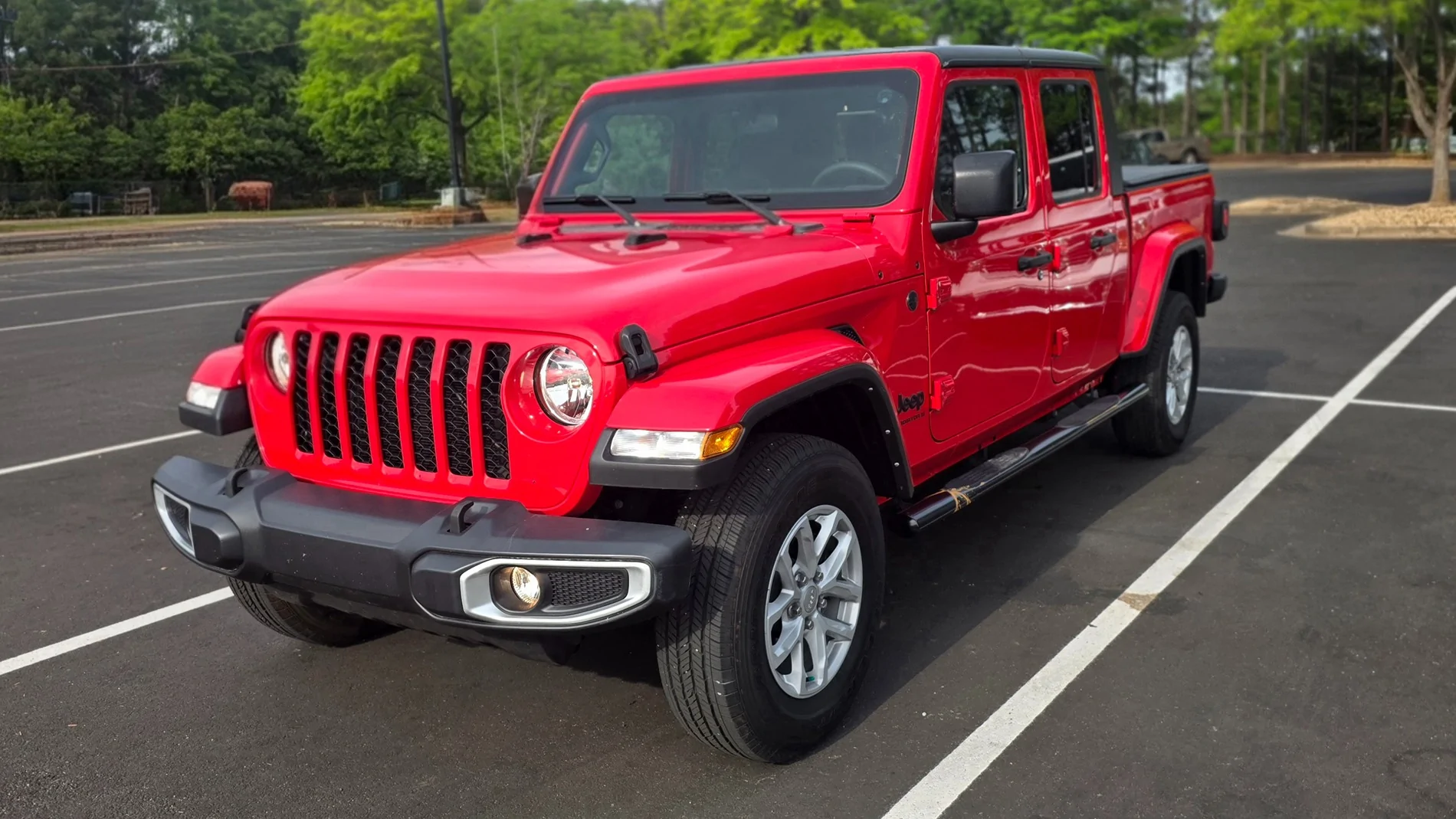

But I do want to upgrade all the lights that are included. Could you all please help with some options or part numbers of what I can replace with? I do have a Tazer already as well and here is my Jeep for reference. Thank you very much!

I, personally, would pass on a kit. Kits lock you in too much for my taste. You can find way better options if you mix and match manufacturers. If you like the all inclusive form of that kit make a note of what lights it replaces and then just knock it out 1 at a time.
For manufacturers you have a plethora of them. Morimoto, Oracle, Diode Dynamics, Combat Off-road. All of those definitely have OEM fitment products that will achieve your goals. I’m sure I missed a few in there.

I have the sunpie fog lights i put on my steel bumper. They work well but i think i will end up going with the raxiom brand when i am ready to do full kit. You should take a look at them.

I have a 2022 Sport S and most the confusion is based off the single bulb fenders lights, you have the 2 bulb lights. My experience was that you can ignore the won't fit Sport/Sport S warning. Make sure you're 100% sure you want the fender lights because they are a PITA compared to the other lights. If you do them make sure you have plastic rivets to replace the ones you need to drill out and spare fender clips because you will break some of them when taking off the fenders. You will see sellers saying you don't need to take the fenders off and some even have videos but what they don't tell you is they have already had the fenders off before and were missing a bunch of clips. Technically you can do it without fully removing the fenders but it is way easier to remove them. I've done it both ways so believe me.

That's a very good point. I've looked at many of those manufacturers, but the confusing part is mainly the fender lights. It seems like fitment depends on trim type, painted vs non painted, tow package level, the alignment of the planets and what phase the moon is in, hahaha
This is all true. Since you know you have a Sport, only thing you need to know is if it’s a Max Tow or not. Fenders are slightly different. I don’t see the tale tell lip on your fenders so I’d guess it isn’t a max tow. If it gets too confusing with all the options just figure out which lights you really like and message the company. Most of them will respond within a reasonable time. Especially if it’s to make a sale.
