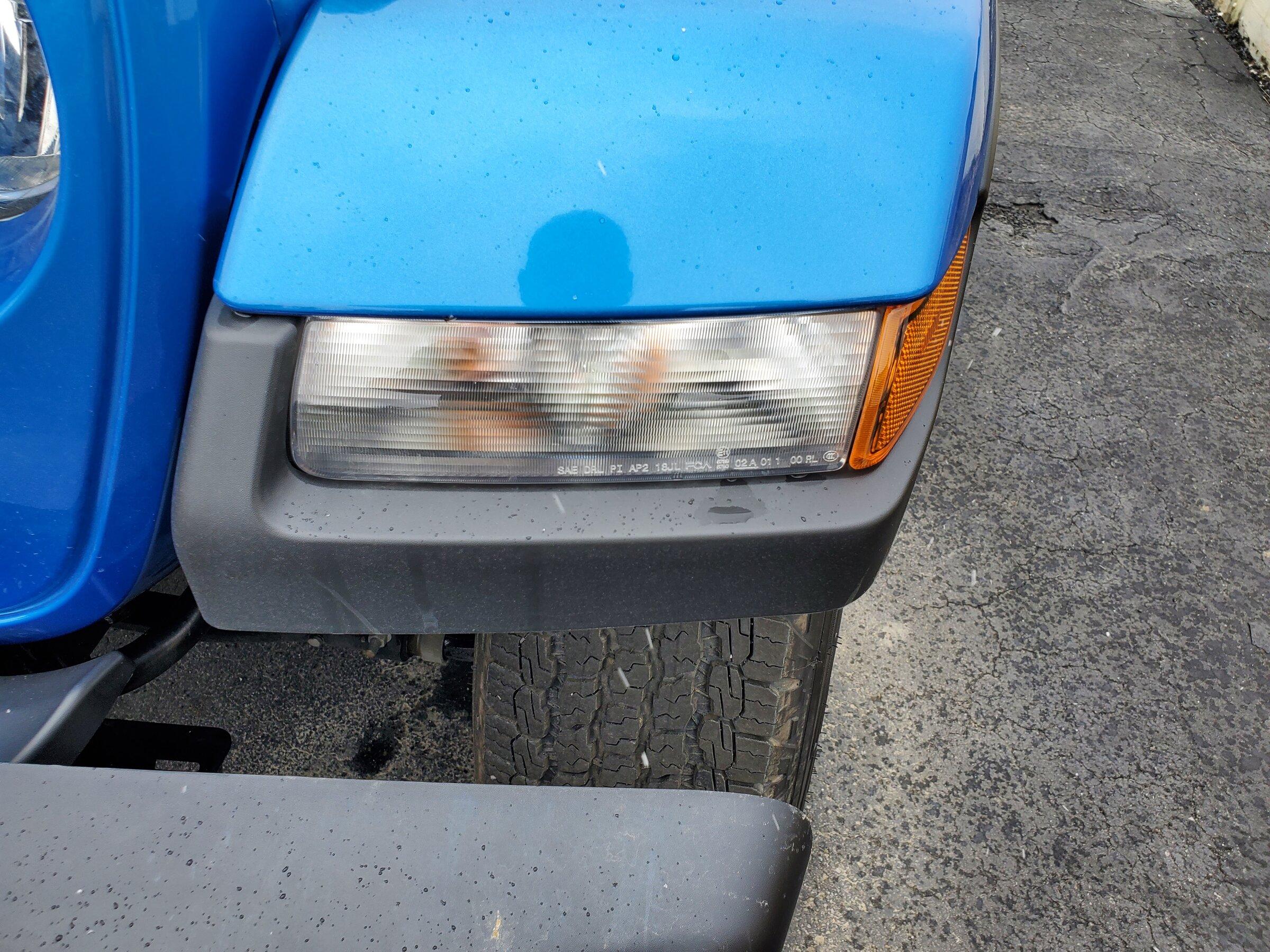

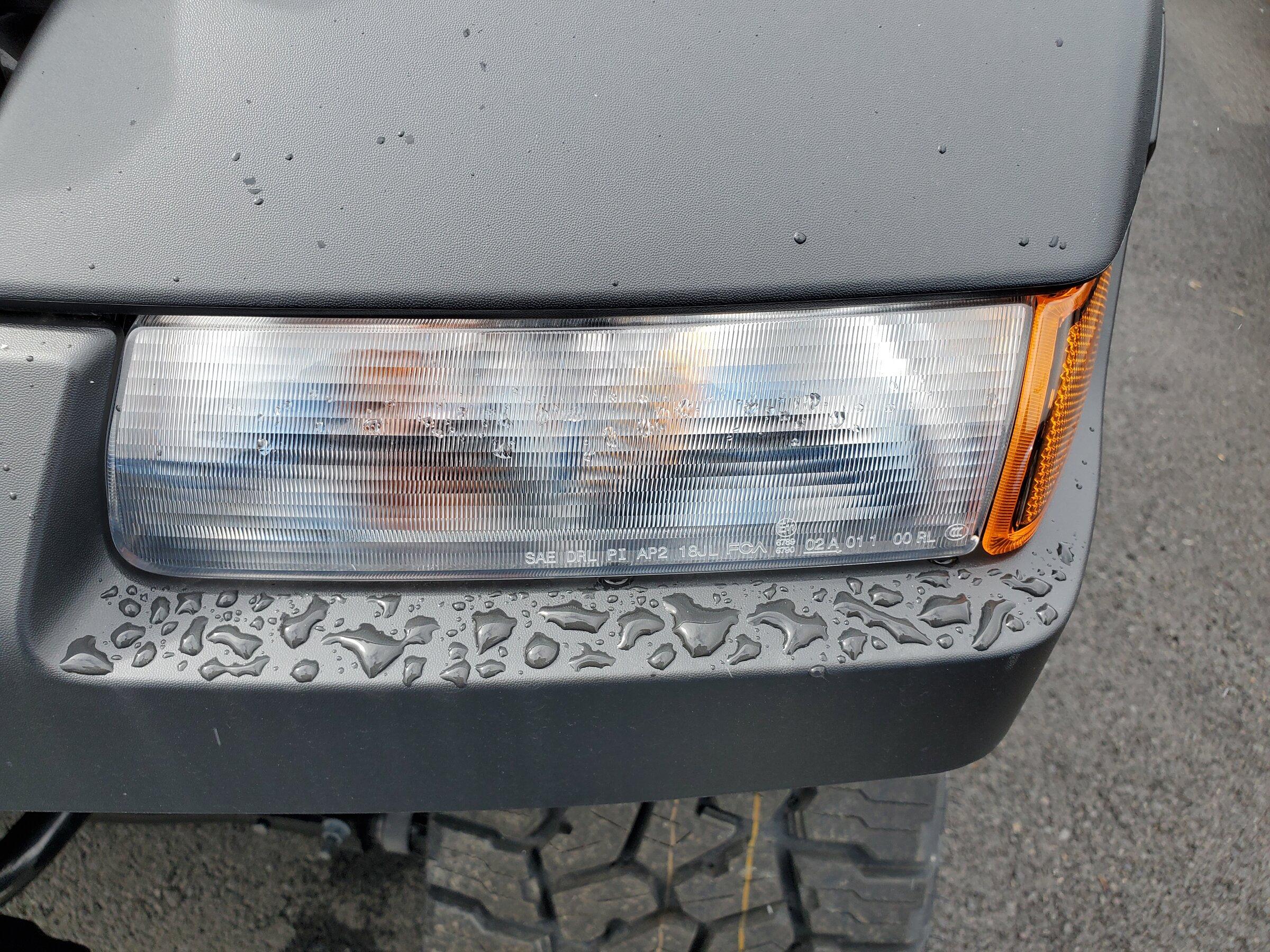

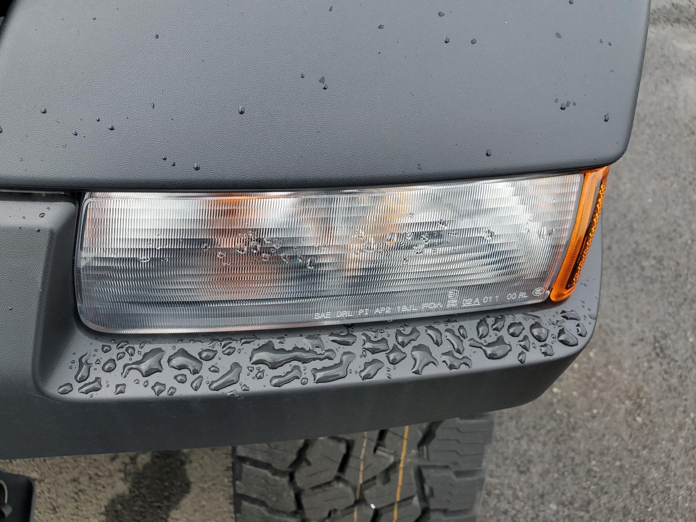

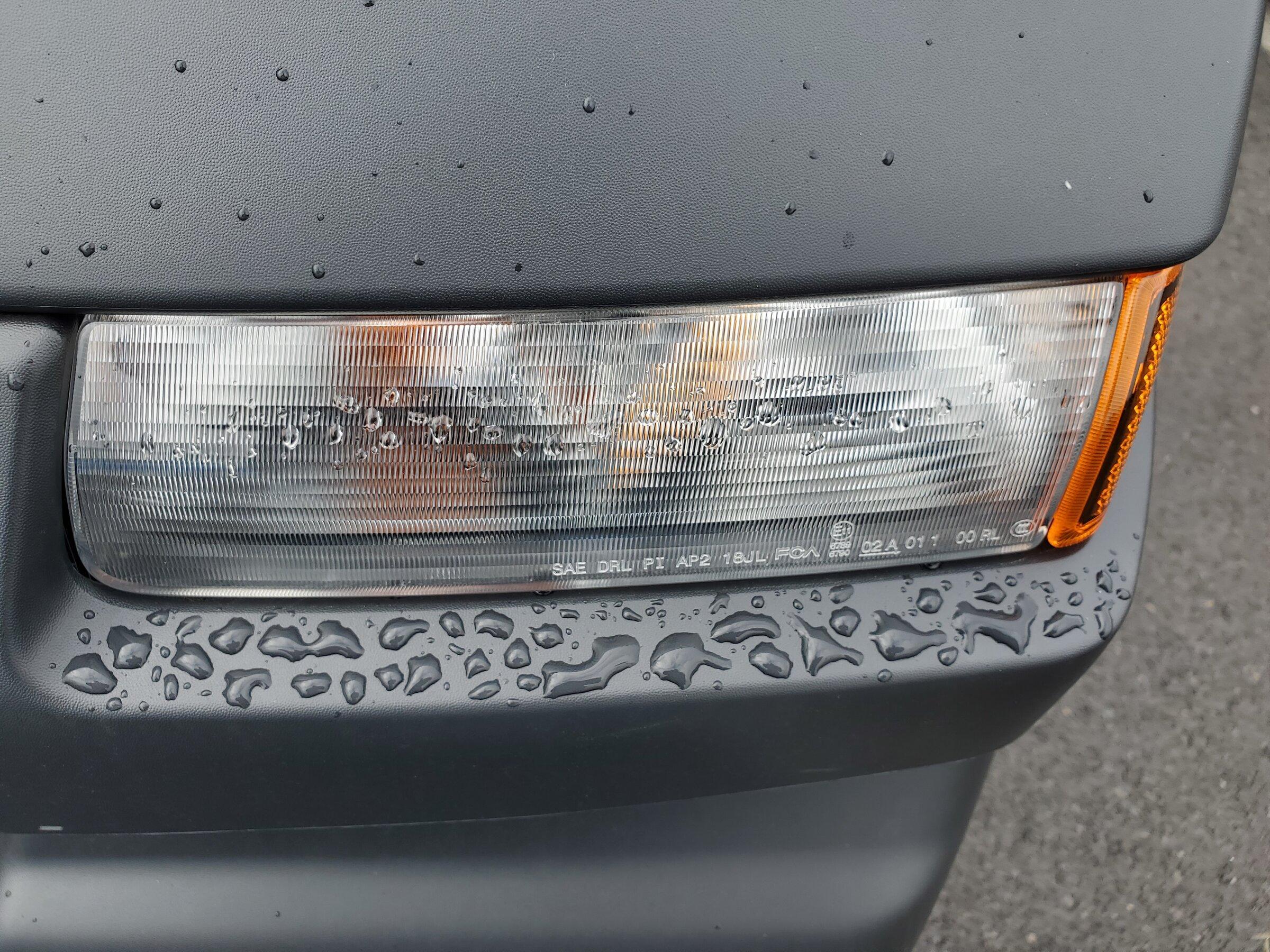

I'm looking at aftermarket LED DRL/turn signals but they all say will not fit Sport or Sport S. I can see differences in the fenders on some models but the lights look identical. What am I missing?

Top to bottom 20 Sport, 22 Mojave, 22 Sport, 22 Rubicon and my 22 Sport S.

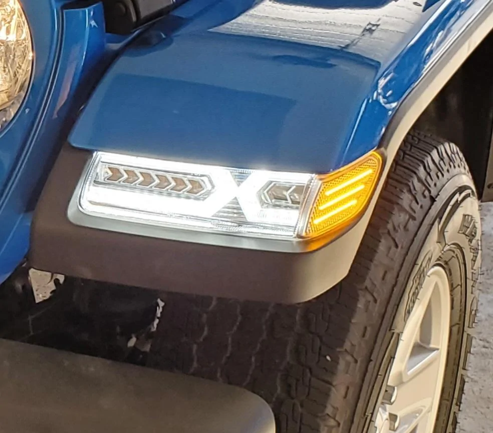

I have these lights and love them. So there’s 3 different Turn/DRL housings; the solid yellow turn/night light, the dual halogen setup (turn signal inside, DRL outside), and then LED (DRL on top Turn on Bottom). Those lights only work with the middle 2-bulb style with halogen turn signal and DRL which is the ones that you posted photos all have. (Attached are before and after photos)
Jeep Gladiator Confused about fenders and DRL/turn signals (Sport or Sport S fitment). 339B15AF-6315-410B-8FA9-535475F97FF1
Looks good!

I’ve had those lights installed for well over a year now with no issues at all. I love how distinctive they are especially at night. I don’t have a tazer or anything, so I just used metal zip ties for the capacitors, and tied them around some metal supports behind the fender liner to act as a heat sink.

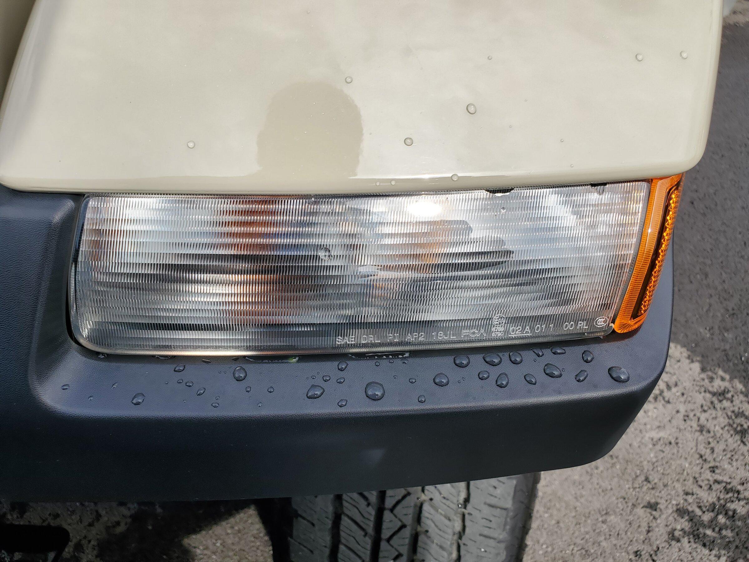

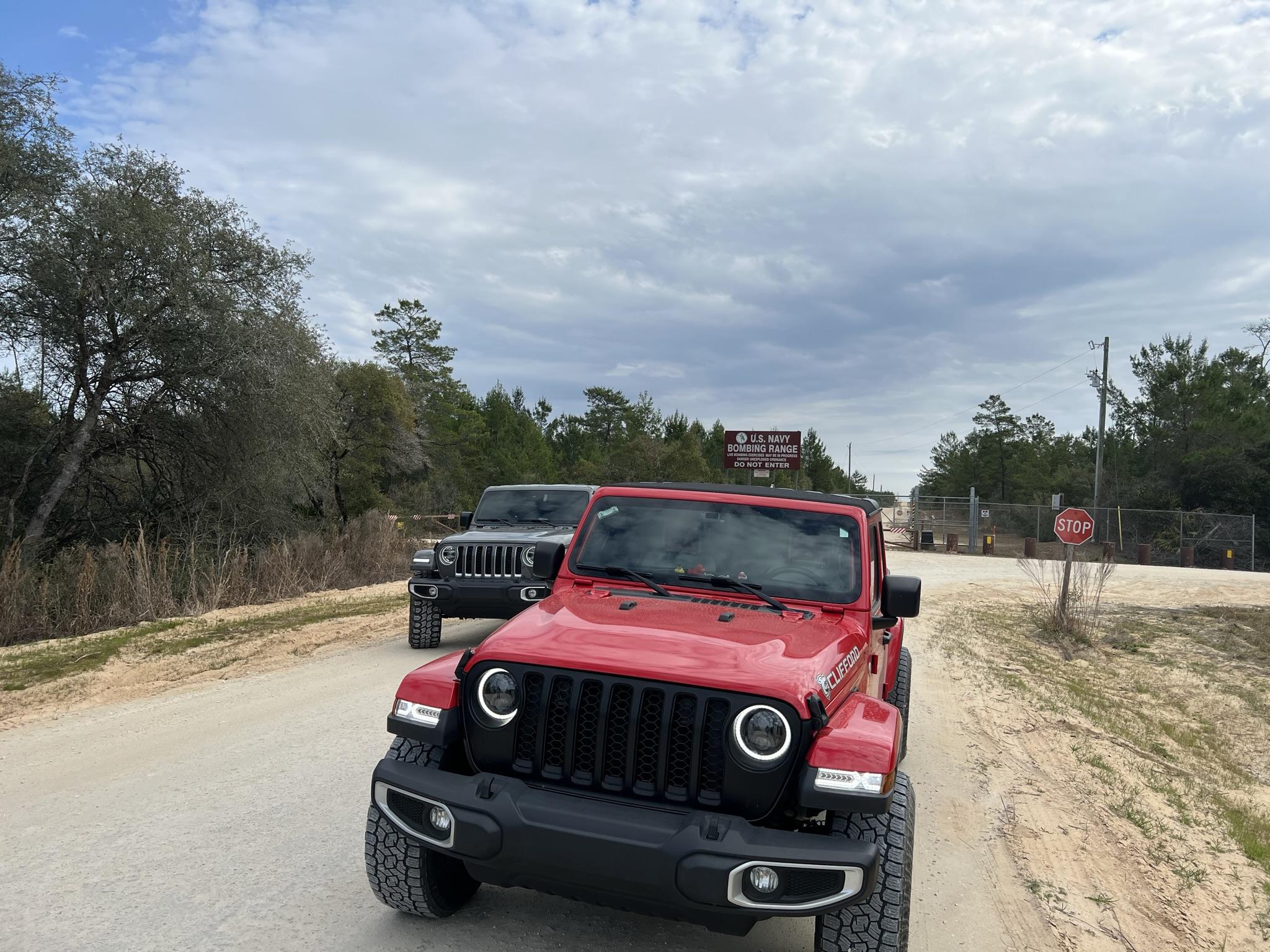

I installed these on my Sport S today.
Jeep Gladiator Confused about fenders and DRL/turn signals (Sport or Sport S fitment). 20220409_174247
Here's what I had stock.
Jeep Gladiator Confused about fenders and DRL/turn signals (Sport or Sport S fitment). 20220327_122010
If your stock lights are the same as mine then I'd think you're good to go.

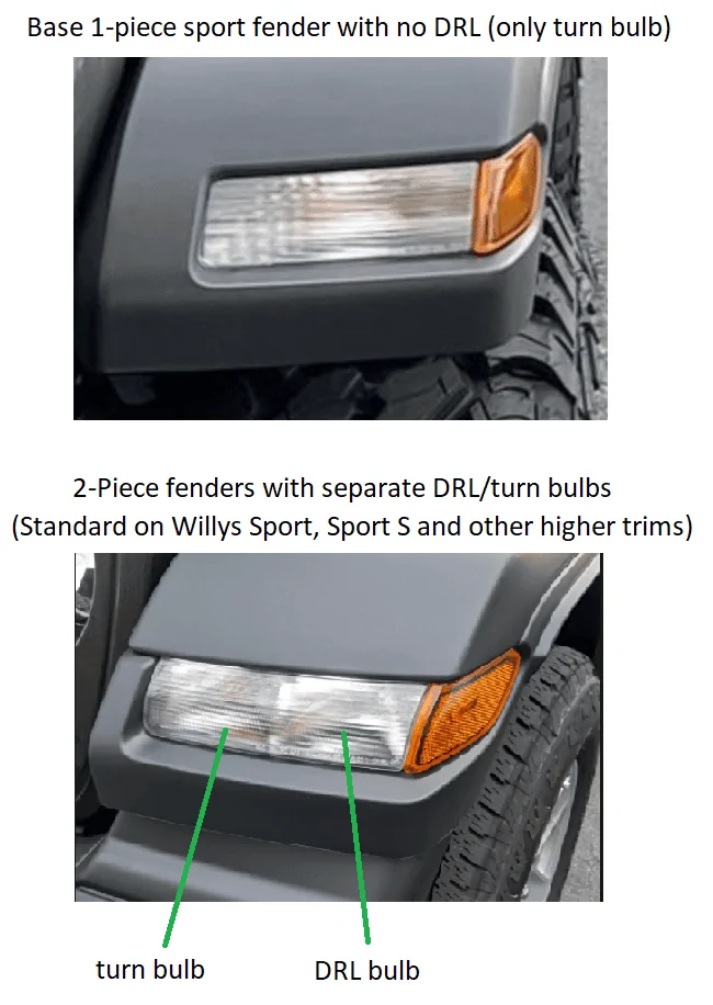

Here's a comparison pic of the 2 OEM halogen fender light types. The top pic is the base model halogen fender light on sport trims. The lower one is the version that comes on Sport S, Willys Sport, and other higher trims. The mopar LED fender light is the third type but has identical size/shape to the second image. If you have the base sport one, your options are more limited with aftermarket versions as it's not a common trim and has different dimensions than the DRL one. If you have the halogen DRL one (with separate turn/DRL bulbs), almost all aftermarket lights work.
Note that any aftermarket lights that require you to "chop" or separate the fenders (base sport fenders can't be separated) and include a new fender brace to support the chopped fender will require you to choose whether you have the base fenders (sport S/overland type) or the "high top" fenders (Rubicon/Mojave) that sit higher on the fender and require a different brace than the base fenders.
