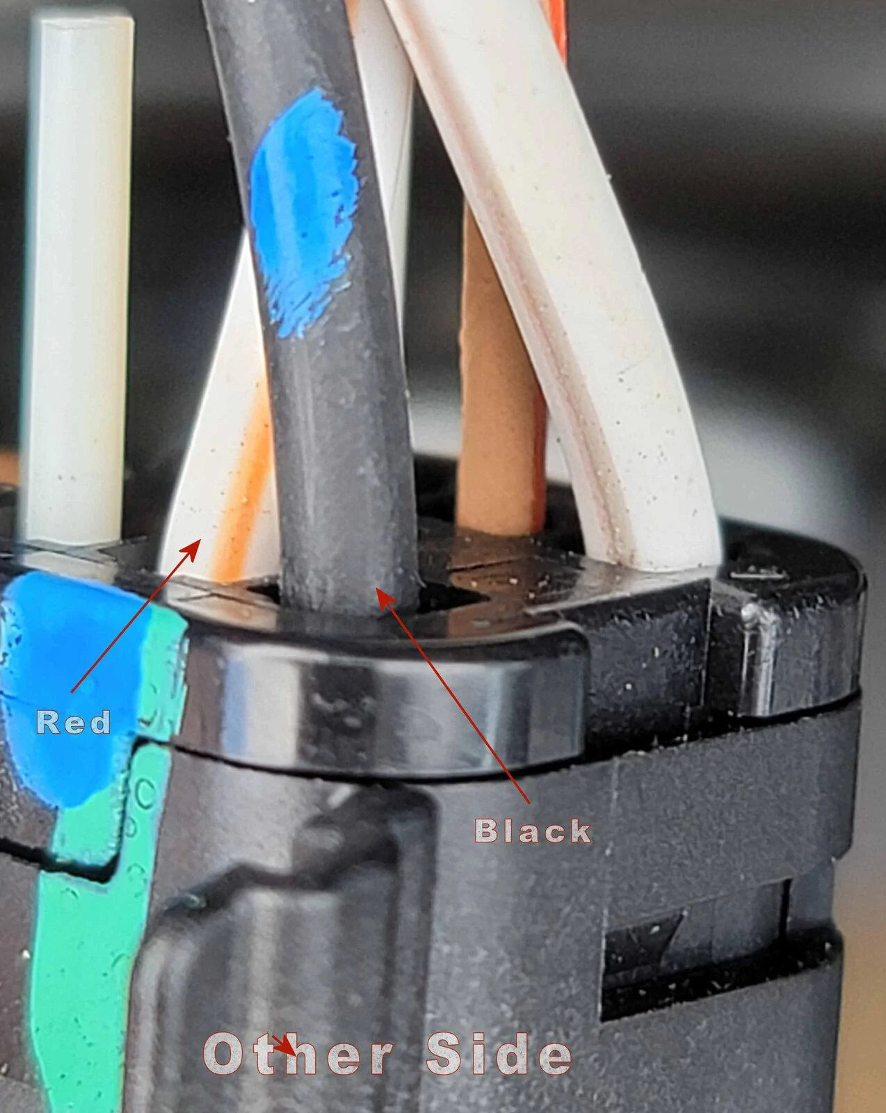

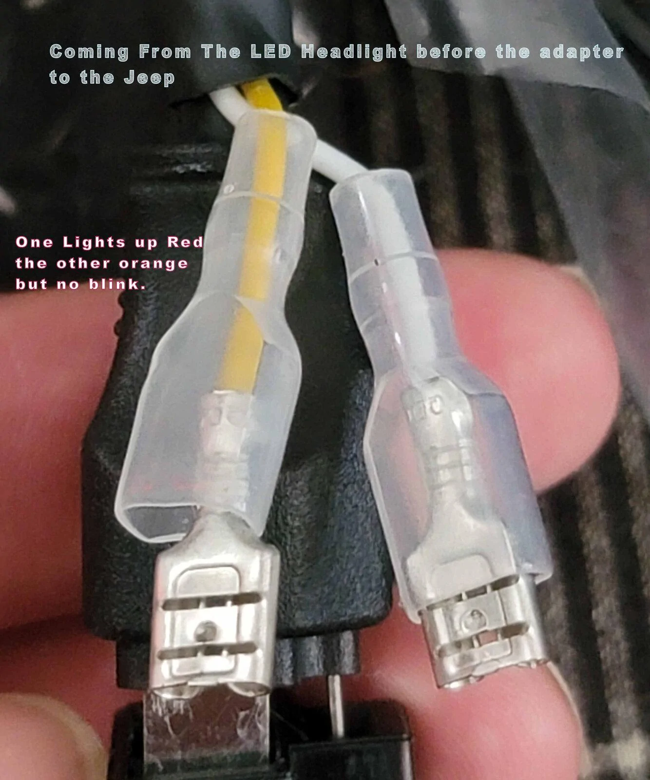

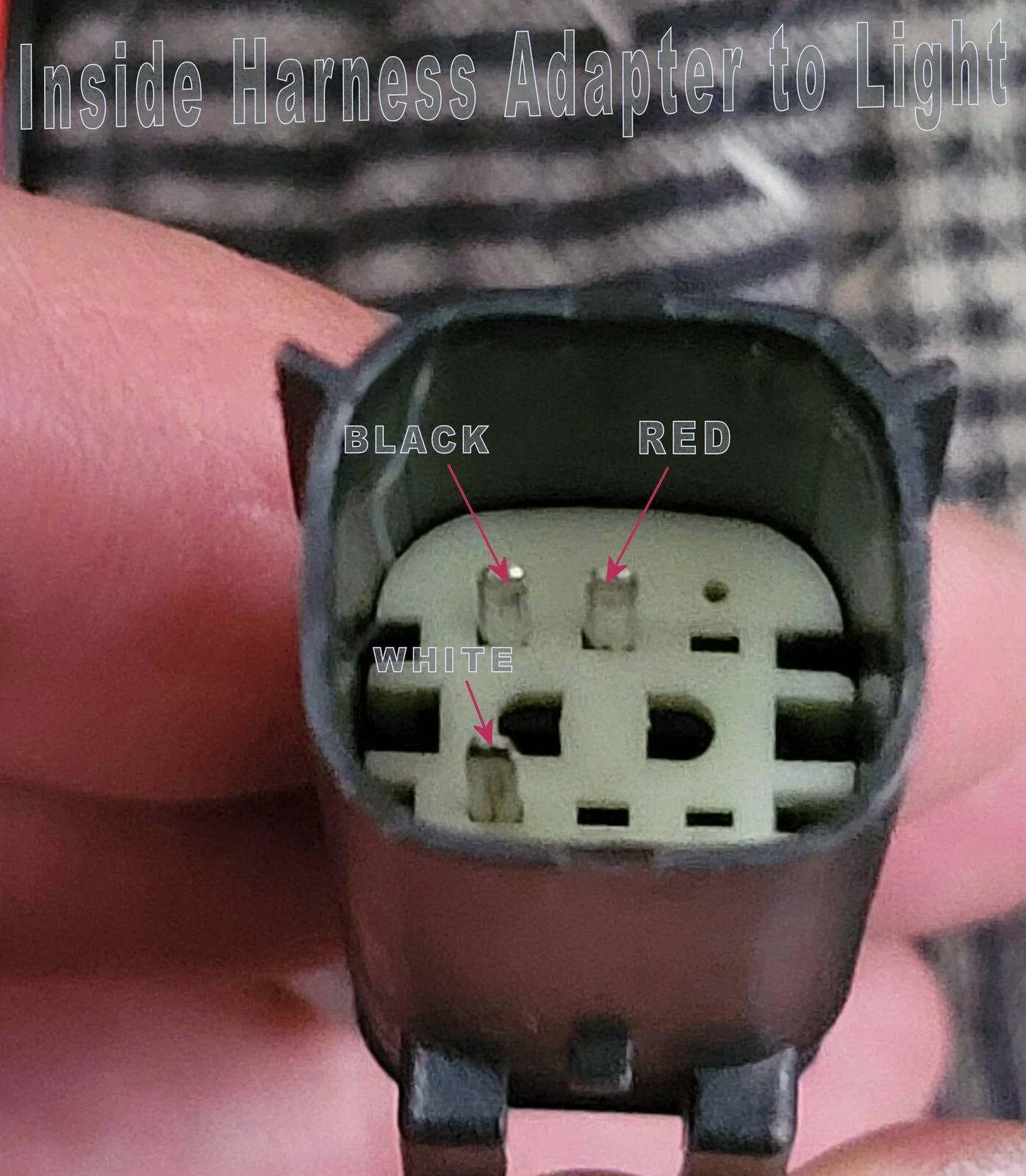

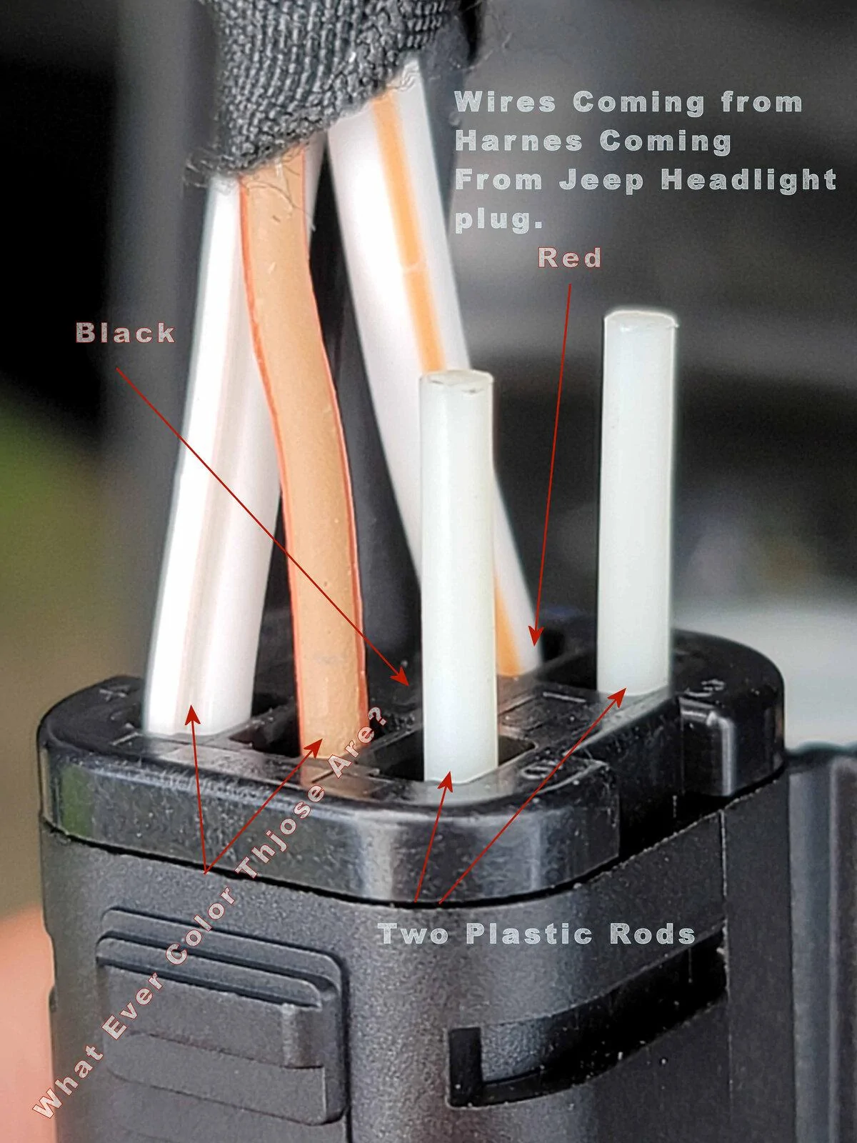

Any chance I could get a copy of that wiring diagram to wire the halo led lights with the halo is suppose to be flashing orange with the blinker? The halo on mine is red. I have a harness but when I hook it up it only does the headlights, there are two wires coming out of the headlight. I have a 2021 Gladiator Sport 3.6L Automatic. Would be great help if someone could even just tell me what the extra wire is for. I'm assuming, Red & Black is Low Beam, and white and Black is High Beam (Maybe).
