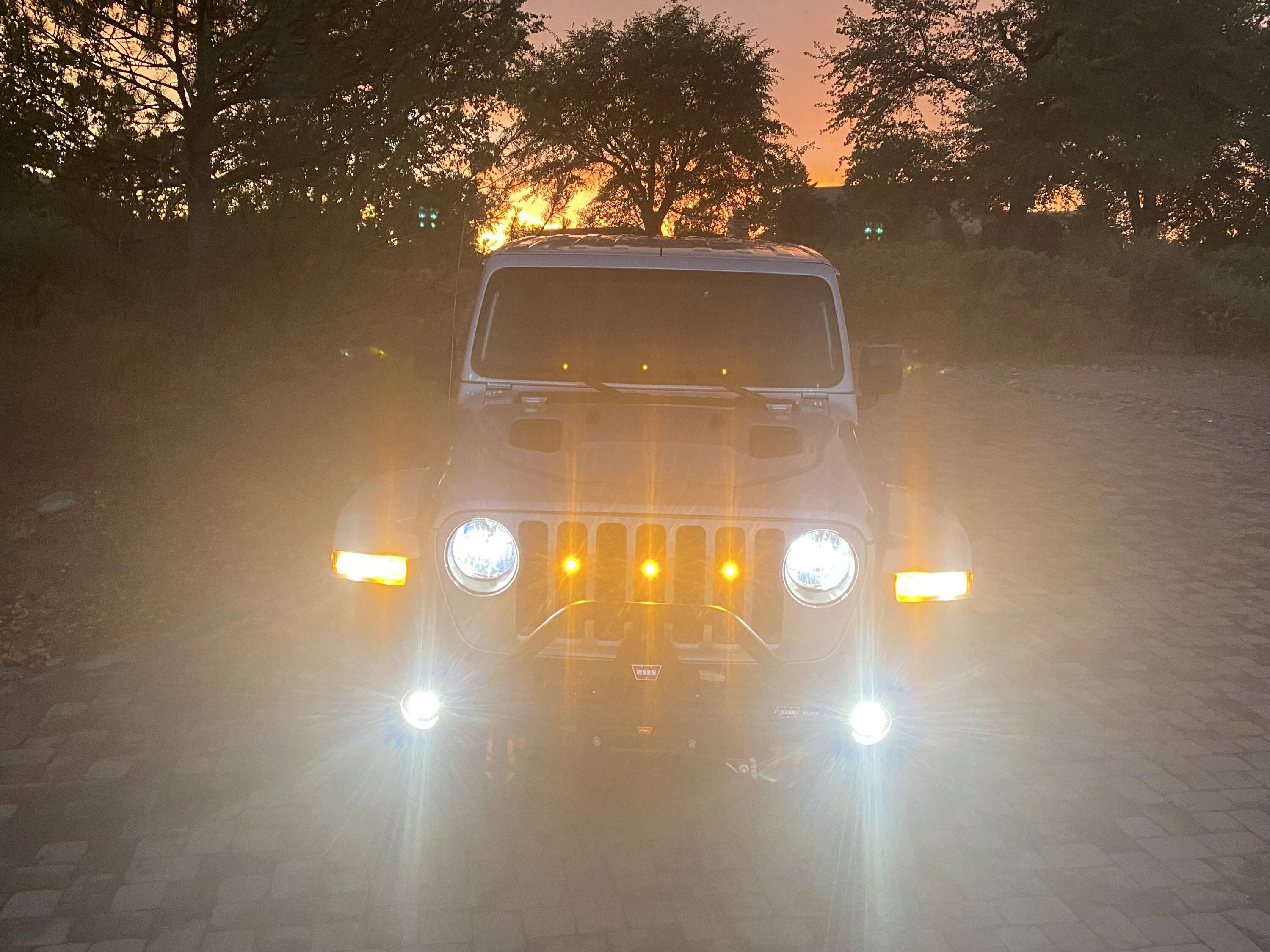

I recently replaced my headlights, running lights and turn light bulbs with these :
Running Lights
https://www.amazon.com/dp/B07WXTVHD3?psc=1&ref=ppx_yo2ov_dt_b_product_details
Turn Signals
https://www.amazon.com/dp/B07H6TDYZR?psc=1&ref=ppx_yo2ov_dt_b_product_details
Headlights :
https://www.amazon.com/gp/product/B073ZDLKT9/ref=ppx_yo_dt_b_asin_title_o03_s00?ie=UTF8&psc=1
Super easy, super cheap, work great. No regrets. No problems needing to "switch" the onboard computer to LED's with taser or etc.. Much better looking than the halogens.
I replaced the fog lights with Baja Designs pods and they are FREAKING bright. Love em.
While I was in and doing things, I also put on a set of pre-runner grill lights by Oracle and tapped into the marker lights for power. Nice vibe. Here's a pic of the final results:
Jeep Gladiator New fender lights/turn signals? headlights
