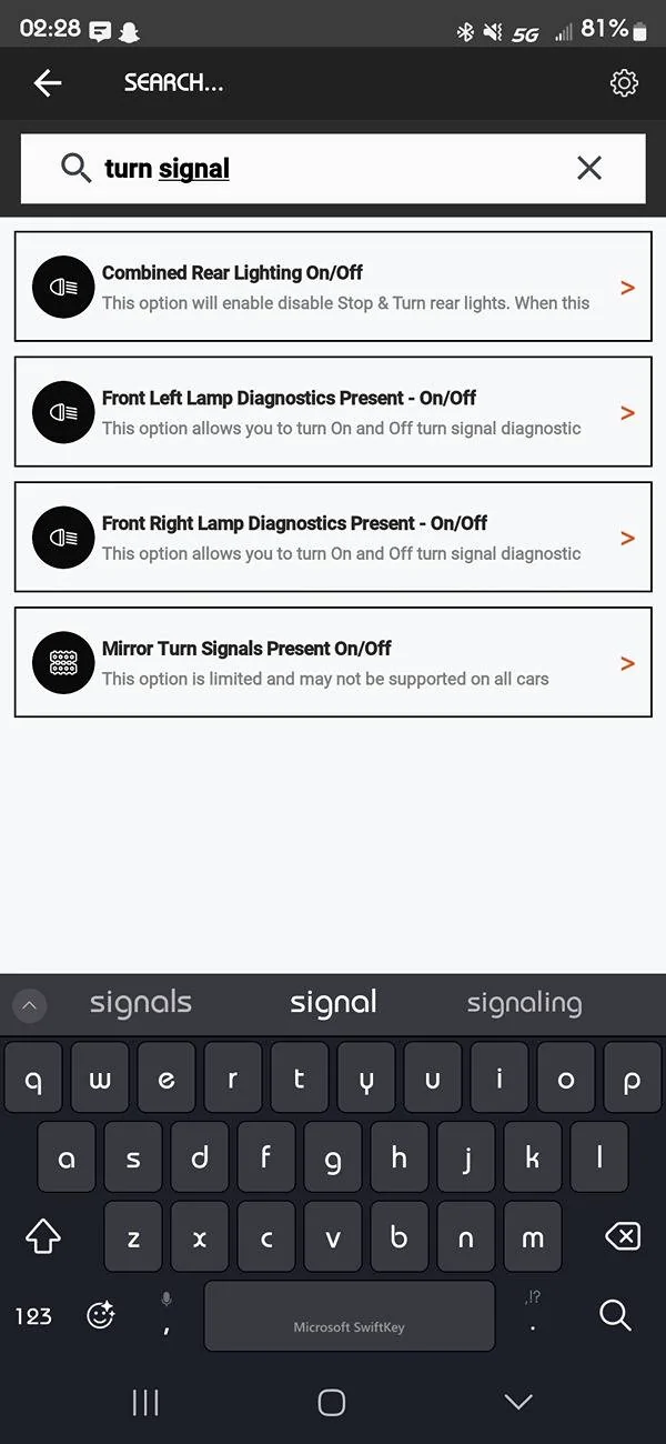

2021 Overland. Switching from halogen lights to a new set of LED lamps for the fender turn signals. I've done my headlights and tail lights already and made the switch in Jscan with no problems. But I can't seem to find any settings for the turn signals. I reached out to Jscan on facebook, and whoever messaged me back said that there are no settings for turn signals for my vehicle. Can anyone confirm or deny that? I found it odd. There's LED settings for every other light possible on the truck. I'm not having any hyper flashing or issues, I was just told a while back that it's good to tell your ECU that you now have LEDs in instead of halogens, so I just wanted to make the switch. If anyone can help me out, I'd appreciate it. Thanks!

When you go to the app do you not have LED Lights Settings -> LED Front Turn Lamps Present On/Off option under adaption tab?
I see something called turn lamp diagnostics? Which is what I showed to Jscan, but he said that was not for the turn signals.

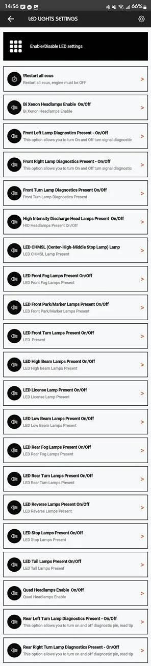

These are all the LED light settings I have

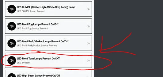

You have the option. I think the problem is you were looking for "turn signal" instead of "turn lamp".
OK. That's what I figured. But jscan was telling me to search for "turn signal" so I was stumped. Thank you so much! Do the turn lamp diagnostics mean anything or need to be changed?

I don’t believe you need to mess with the diagnostics. Just LED on or off.
