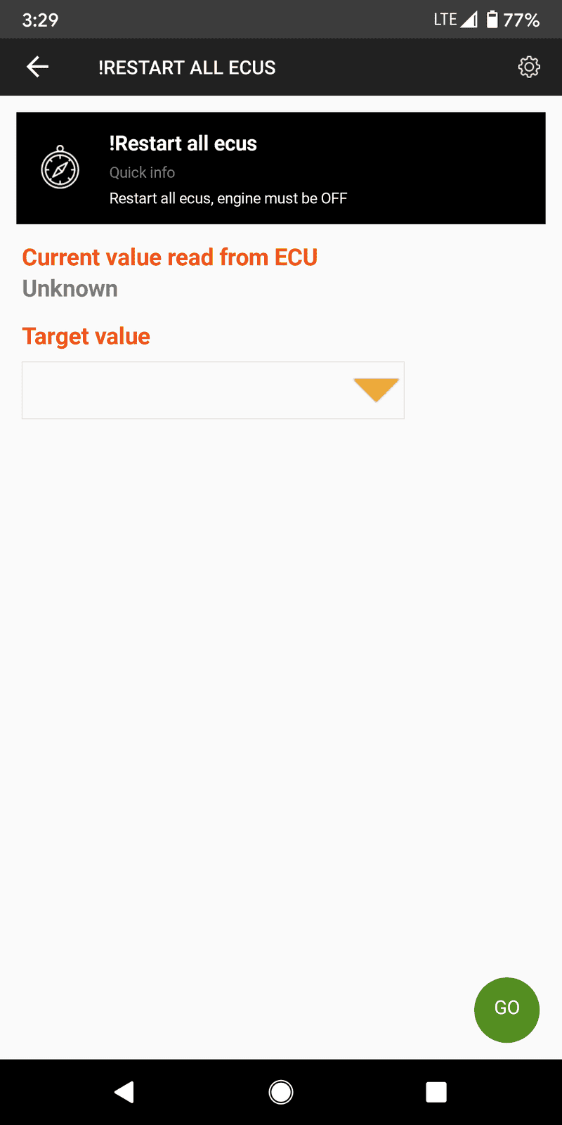

Just installed this set of lights on my Gladiator today: https://www.amazon.com/gp/product/B085XZ69T5/ref=ppx_yo_dt_b_asin_title_o02_s00?ie=UTF8&psc=1
They come with anti-flicker devices, but I didn't install them--I figured I could use JScan, and I test them before installing and they seem to work fine.
However, I'm still getting a fast blinker indicator in the cab (green arrow is blinking faster than usual) and a notification that my turn signals are out (which they aren't, they do operate without issue).
Which JScan settings should I be looking at? I currently have set:
DRL - Day time running lights - settings > LED Dedicated DRL Present to ACTIVE
LED Lights Settings > LED Front Park/Marker Lamps Present > ACTIVE
LED Lights Settings > LED Front Turn Lamps Present > ACTIVE
I'm not sure what else I am missing? Maybe they take a few cycles to actually read from the ECU? I see there is also a Front Turn Lamp Diagnostics Present setting, not sure what this is used for?

I did a Restart all ecus > All modules - Power On Restart at the top of the LED Lights Settings menu, and still got the same Turn Signals Out message.

OK, well went back out to play around with it some more, this time I just left the right blinker on, and it seemingly resolved itself. Let the left blinker on, and it also went back to normal operation. No more message! Just had to be patient... :)
