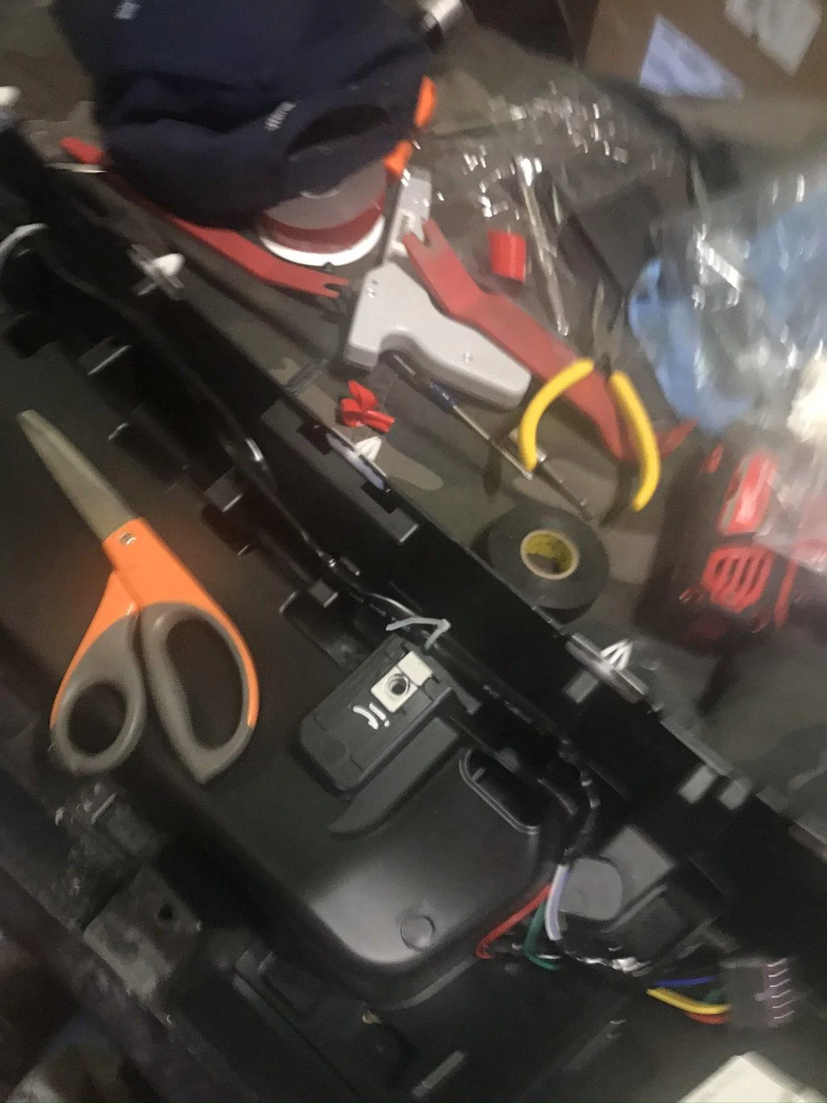

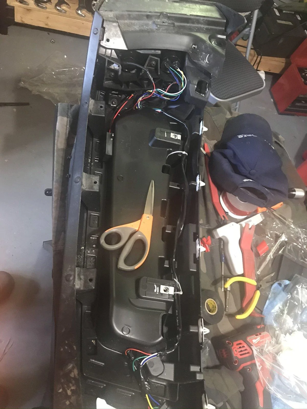

You just have to take the fenders off and peel the layer back, get about 5 screws out, swap out and connect. Get your fenders back together and back on the body. YouTube has a couple of good videos for this specific installation.
