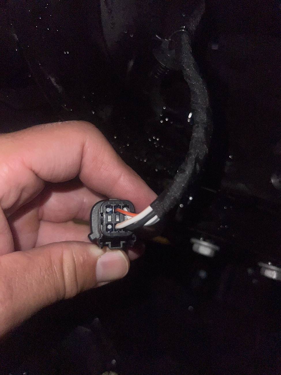

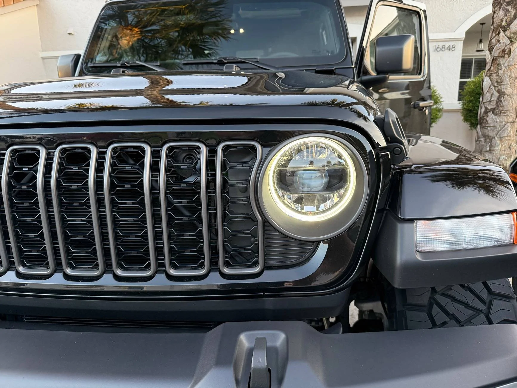

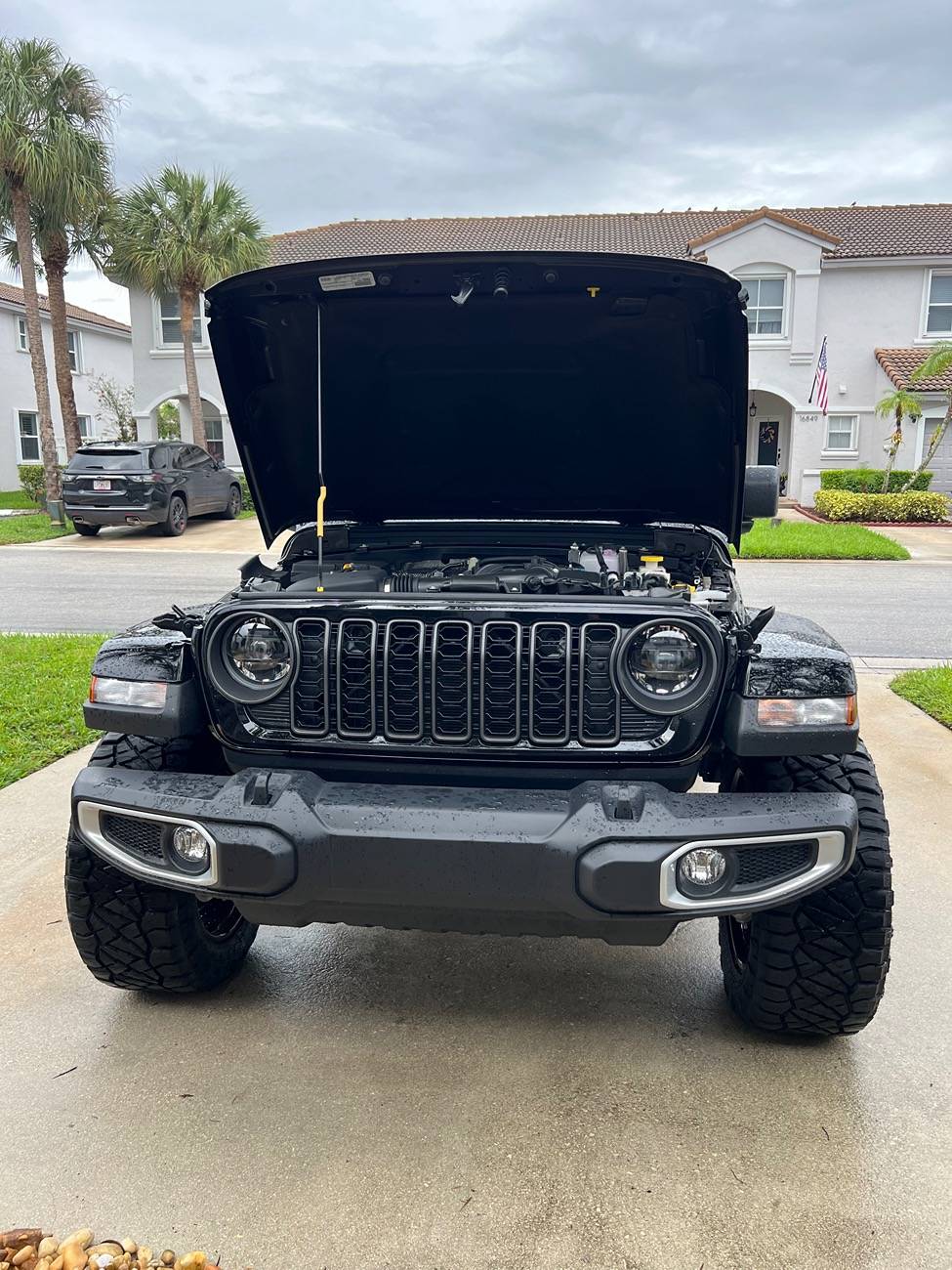

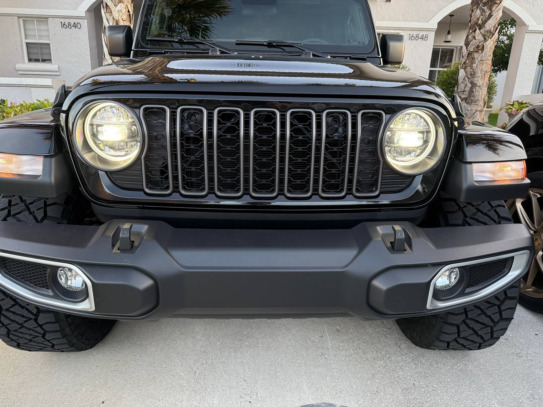

Just picked up a 2024 gladiator sport s. Read many forums here regarding oem headlamp upgrade. I purchased the black bezel headlamps 68596461AA & 68596460AA worried I had to rewire and add the extra wire. In case anyone is wondering apparently the 2024 are pre wired someone here had mentioned this but I can’t find who it was to thank him. Got the JScan and activated the lamps. Works 100% no rewire or anything I have attached pict
