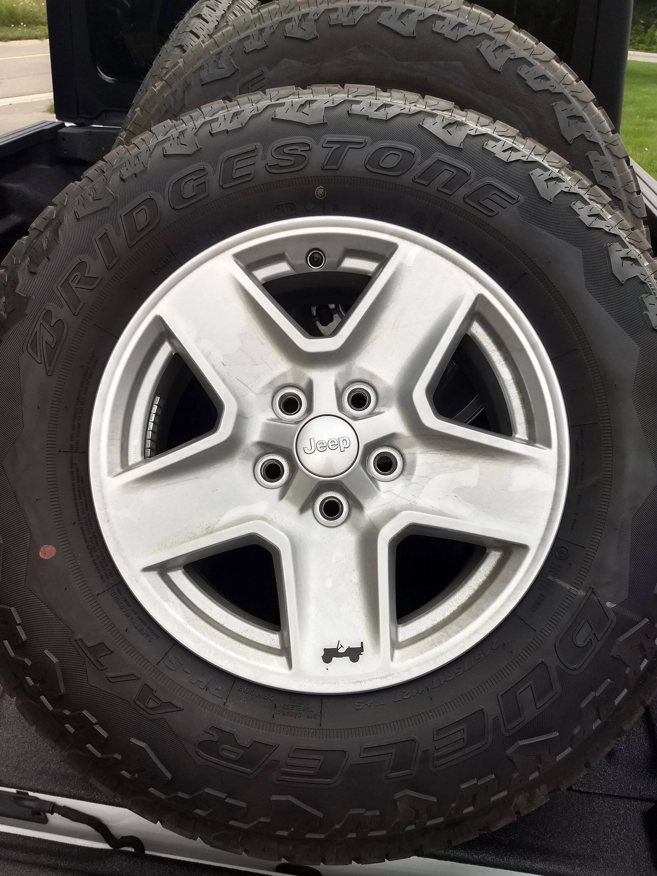

Correct on the sub 32" The Bridgestone dueler's measured in a t 31.5" I changed them out at 5k for larger 33" tires, don't regret it especially when getting into some mud but i'm still amazed at how much traction those Dueler's got off road, not to shabby for a factory tire.
Yeah, that's the number I seem to recall
So the max tow got 31.5, the Overland got 32.2 and the Rubicon got 32.8
