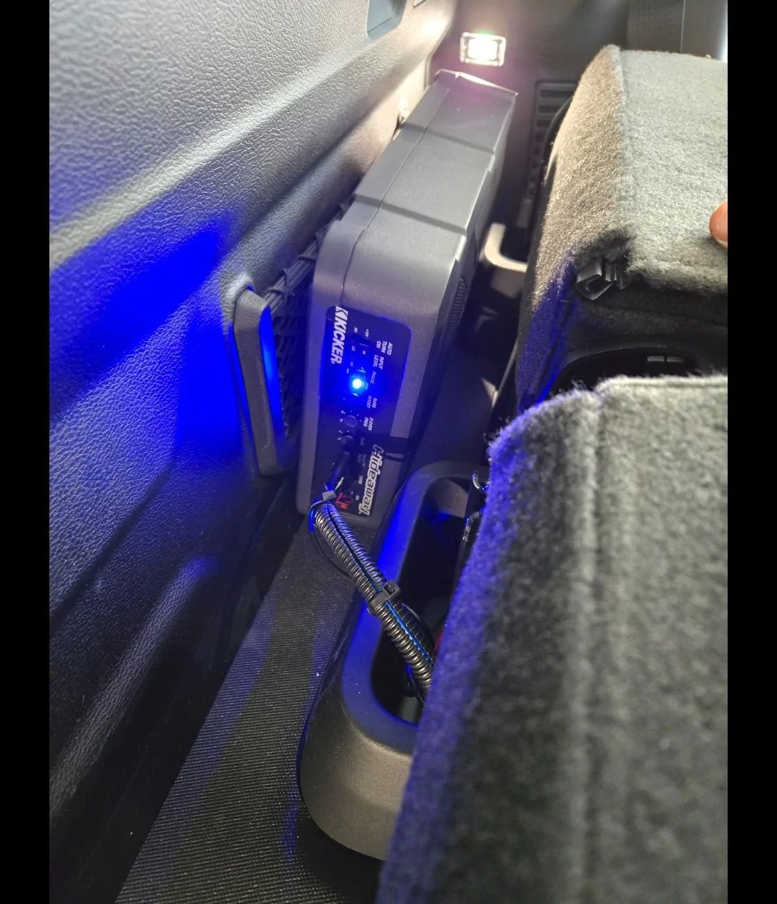

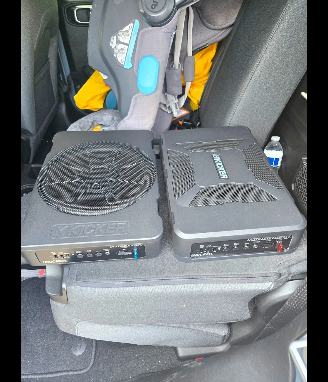

I have the 8 inch Kicker sub and it sits perfectly behind the rear passenger seat on the drivers side without the need to attach it to anything.
I purchased both the 10 inch and 8 inch kicker hideaway subs to compare .
Both of them fit behind the rear seat of my 25 gladiator.
I played with the settings , and the difference is barley noticeable.
So , I kept the 8inch and returned the 10inch.
They use the same wiring harness .
