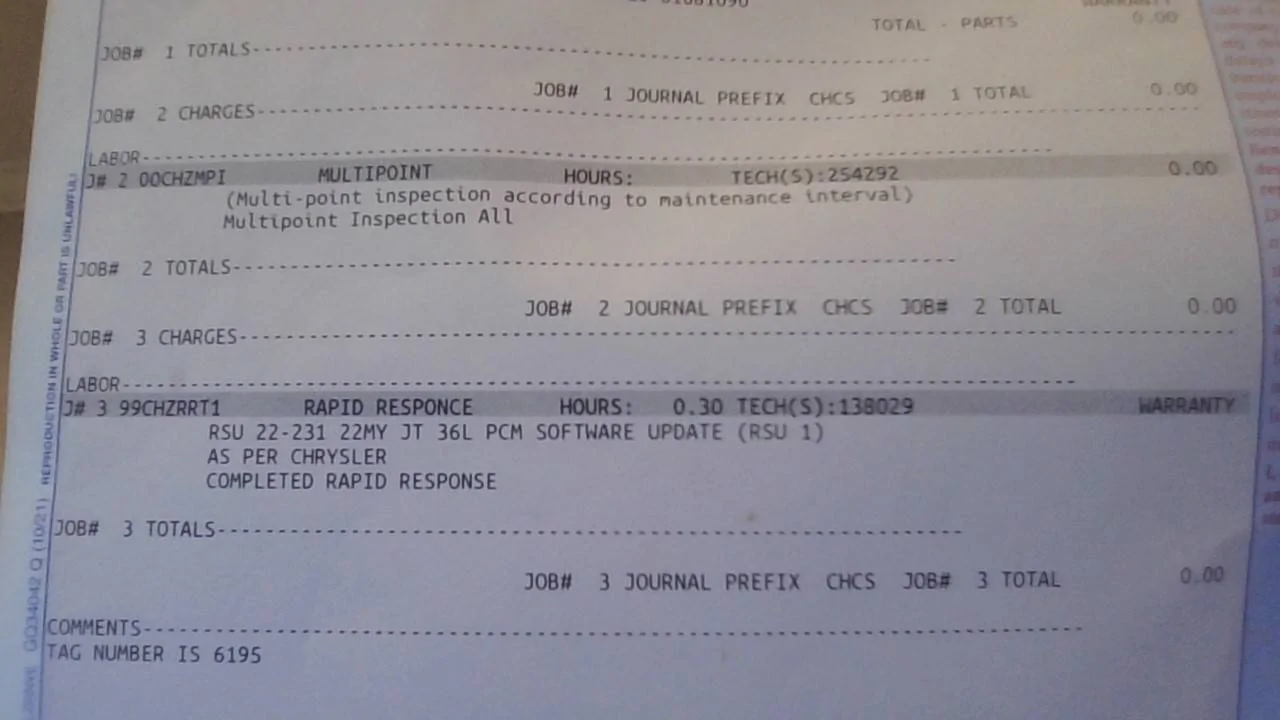

Went to my local dealer today for the second oil change and was informed there was an outstanding PCM update (I had one done late last year under a recall campaign). The update on my paperwork is:
* 01 RSU 1 [RSU 22-231 22MY JT 3.6 L PDCM SOFTWARE UPDATE ***] 103 W
After I got home, I noticed that my cigarette lighter outlet and Oracle halos didn't work. I went back, they reviewed and told me that the fuse in the add-a-circuit fuse tap wasn't up to the circuit demands and replaced it. Everything worked after that. What I'm having trouble with is how the fuse worked w/o issue before the update. Does anyone know what this update does? Why would the fuse cause issues post update?

Took mine in for wave service, and to get my ambient temp sensor issue from 3 weeks ago on record (it's working great lately) and they said mine was listed for the same RSU 22-231
They didn't give any other detail as the guy was normally just the one who lined things up for service as they came in.
It says (RSU3) at the end of that line on the papers so there must have been others - the 22 indicates 2022 year for that RSU.
Didn't feel or sound any different when I got it back.

I just received the update today. What does it address?
Jeep Gladiator 22 Rubicon - PCM Update, no cigarette outlet power WIN_20230301_15_48_38_Pro

Interesting. Just got back from my first wave service. Mine says RSU 1. Maybe my imagination but seems throttle response is better, but wish I could find something that explains what it up grades.
