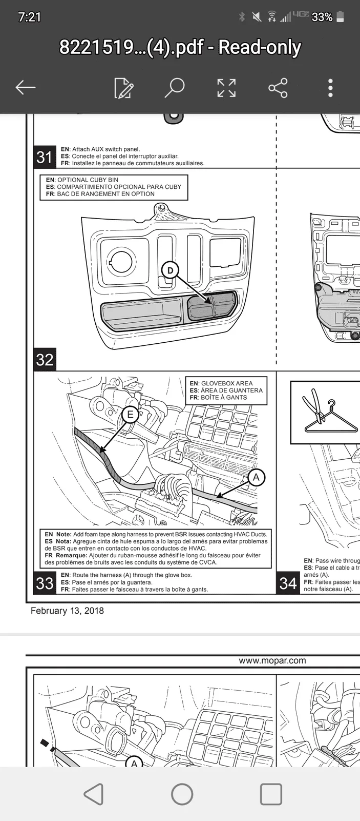

Attached the OEM diagram for a 2020 factory install. I assume the kit mirrors this.
Do not know why they would change it for a mid year 2021 with the PCM change as claimed?
As an engineer myself I would think FCA has a process to roll changes like this with their MOPAR department having buy off on the change to drive their kit changes and part number rolls if the Aux kit has changed effectivity.
