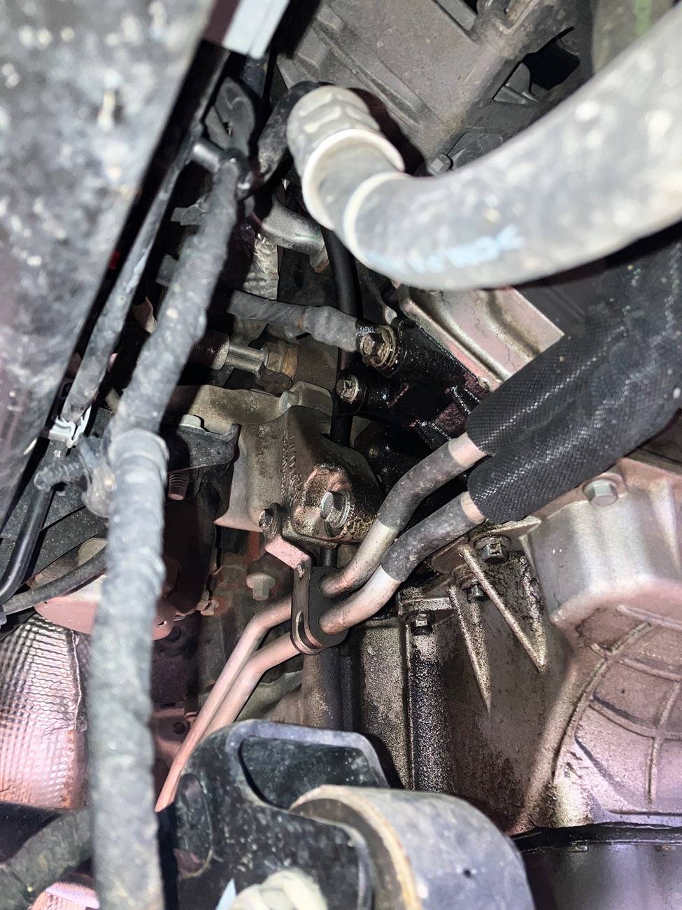

I hate to resurrect an old post, but I have a leak now in the exact same spot. The original leak turned out to be a cam position sensor o ring or gasket?
They put dye in, but I really hate to have them work on it.

Same here.
Did they look at it at all yet? They just found mine today. I read a lot of horror stories about taking something apart to fix it only to have it worse after. Not sure what to do? I have 1000kms left of the bumper to bumper warranty, and they are going to do a full inspection Wednesday before it runs out. But I still have the 100,000 warranty left.

I just found it today when looking to see if I have block heater. 45,000 miles currently.

Ok. Well on that note, you can see my block heater in the picture if you need reference.

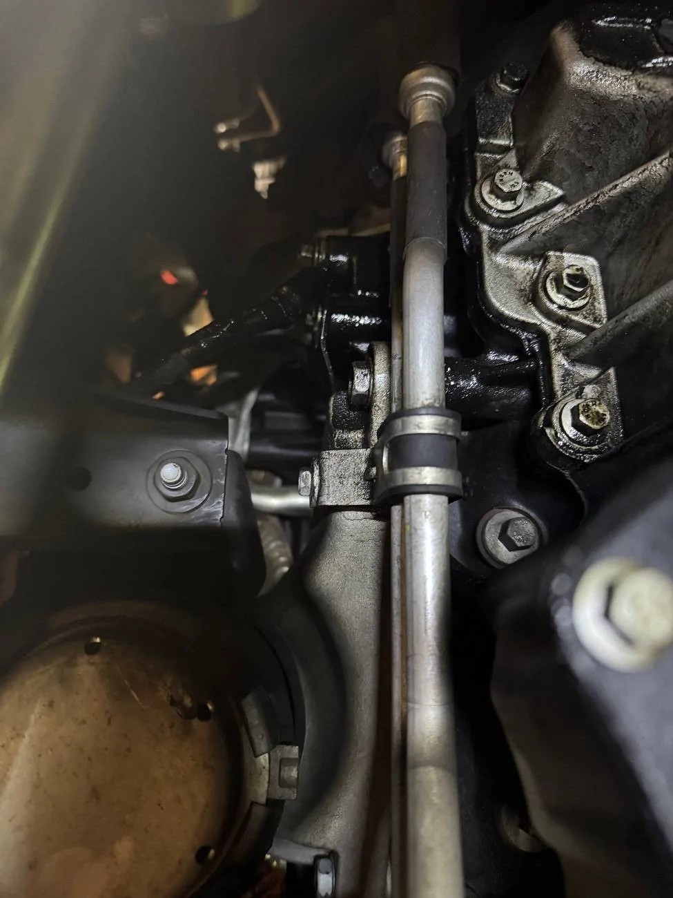

I confirmed it!

Appear to be leaking from the bed plate. It's a two piece block. It's major works to resealed. Technically a deep teardown, trans, crankshaft etc

I’ve also read that the oil dipstick is right above that spot. So here’s hoping. I don’t have anywhere warm to look at it right now but I take it in Wednesday. I’ll mention it.
Mine appears to be from above the bed plate. I also understand that wind as I drive can spread it around.
Here’s hoping it isn’t that. I’ll live with the leak before I let them tackle that!!! 😳
Lol this is exactly what i am doing as i don't want them to tears the whole motor apart. Mine is minor as i had caught it early. I cleaned up the area really well then applied two layers of Honda bond rtv along the seam, where the bed plate meet the block and forward toward timing cover. Been over a year and hasn't leak again.

This is for the 3.0 diesel specifically.
I took it back in and they said I haven’t been driving it enough to see where it’s coming from. That and the tech that put the dye in didn’t clean the area where the oil was on the side of the block, so they had to clean it all and wait longer. 🤦‍♂️
They did say they think possibly the oil dipstick tube.
We’ll see.
