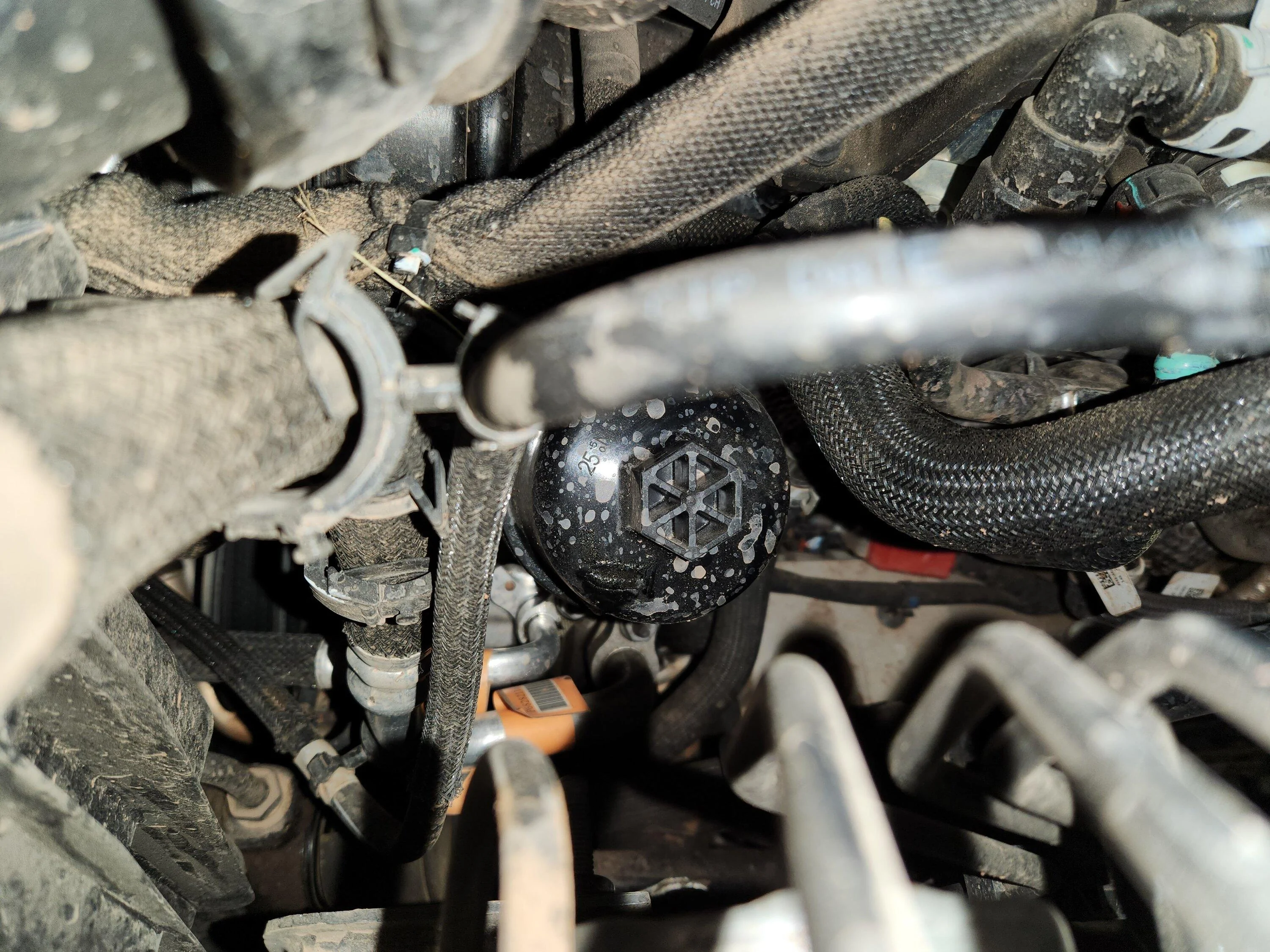

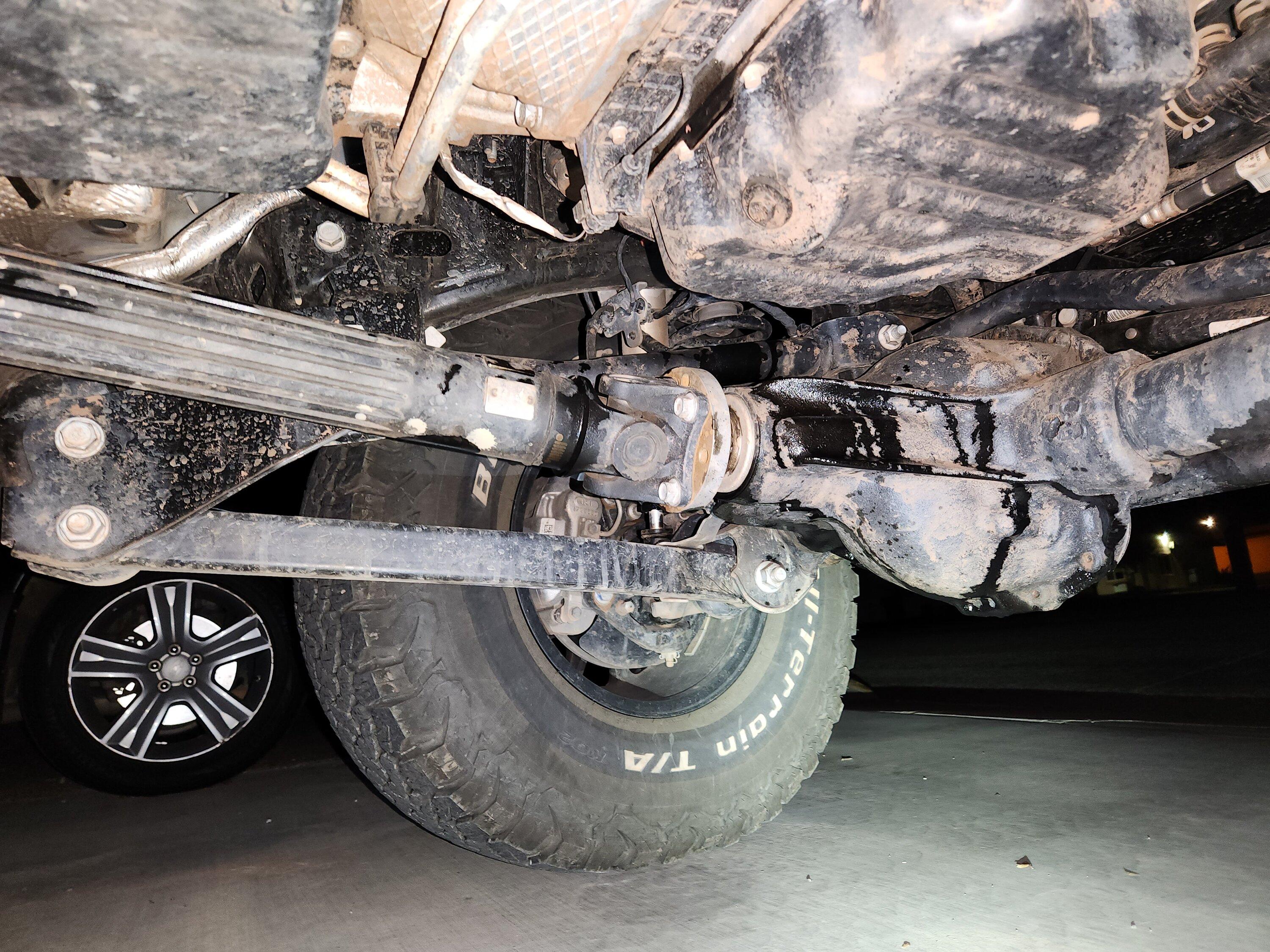

Here are a few pics of the oil trail
Jeep Gladiator Oil leak 20221121_201553
Jeep Gladiator Oil leak 20221121_201621
Jeep Gladiator Oil leak 20221121_201508
Jeep Gladiator Oil leak 20221121_201658

Looks pretty significant. Need to get under it and see whats up
Oil is like blood. It doesn’t take much to look like that. It crawls/wicks.
On a diesel, your oil will look like that after 50-100 miles or possibly less. I still can’t wrap my head around the required oil not being diesel specific.

Did you have a filter change just before this? Looks like during the change a mess was made and the remnants dripped down to the surface, and any residual laying in the crevices heated up and dripped down. My first WAVE change looked like that and I had a friggin shouting match at the dealership to go clean the shit up. Useless, dont give a shit workers at the dealership. Changed to another place and its been night and day

Same for me, first Jeep Wave oil change was a complete mess. My truck was dripping oil for a week even after cleaning up as best I could reach.

Im guessing it was a few ounces. Its only been about 5k miles since my last change and I have 43% left on my oil life monitor.

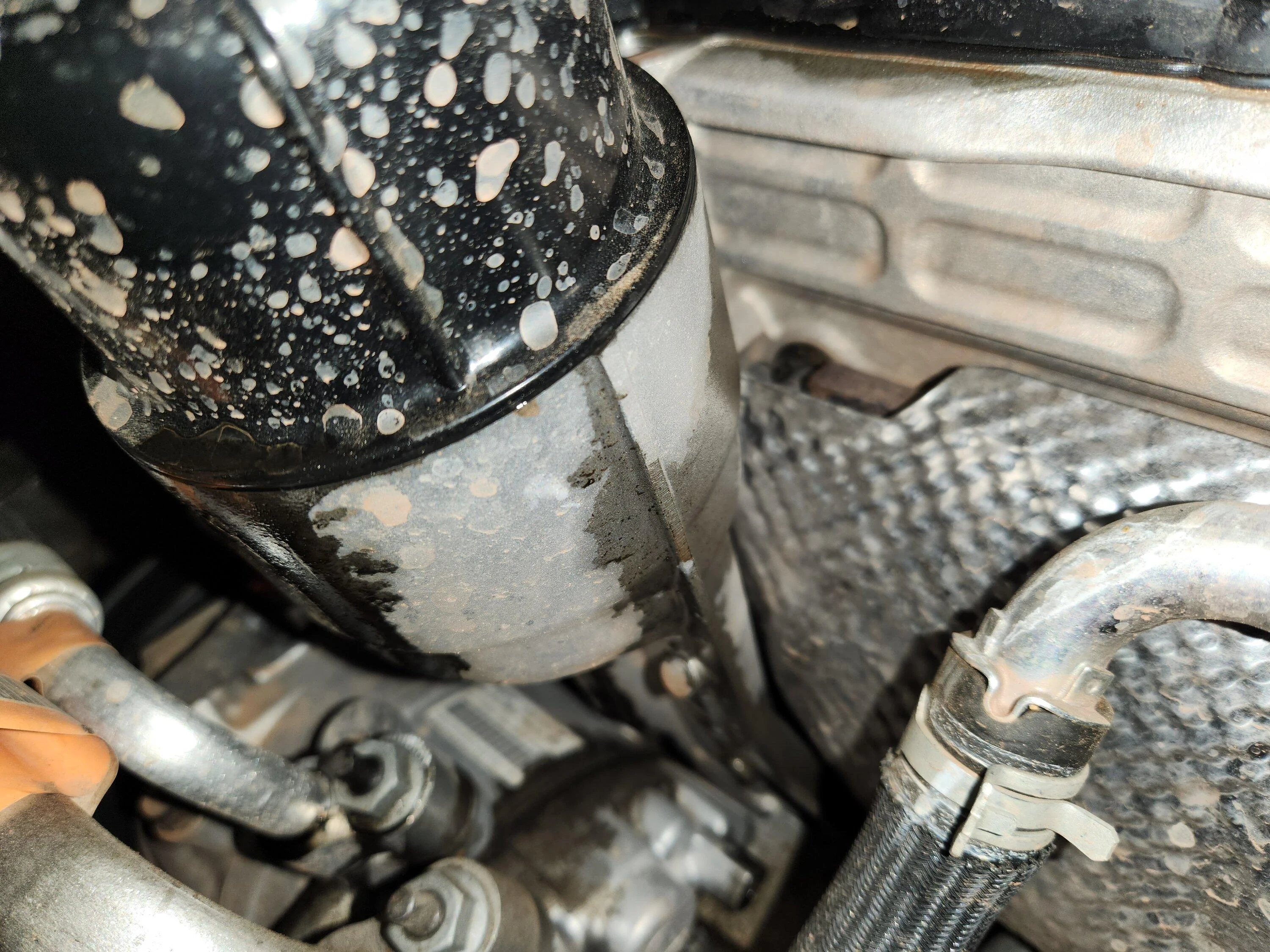

Got it back from my freebie oil change and they said it was the oil filter housing. His guess was it just got cold enough to make the plastic shrink enough to let some oil by. They also had a JL Ecodiesel there with the same issue and said they could only replicate it first thing in the morning after a cold night. He mentioned that the JL leaked a lot more than mine did.

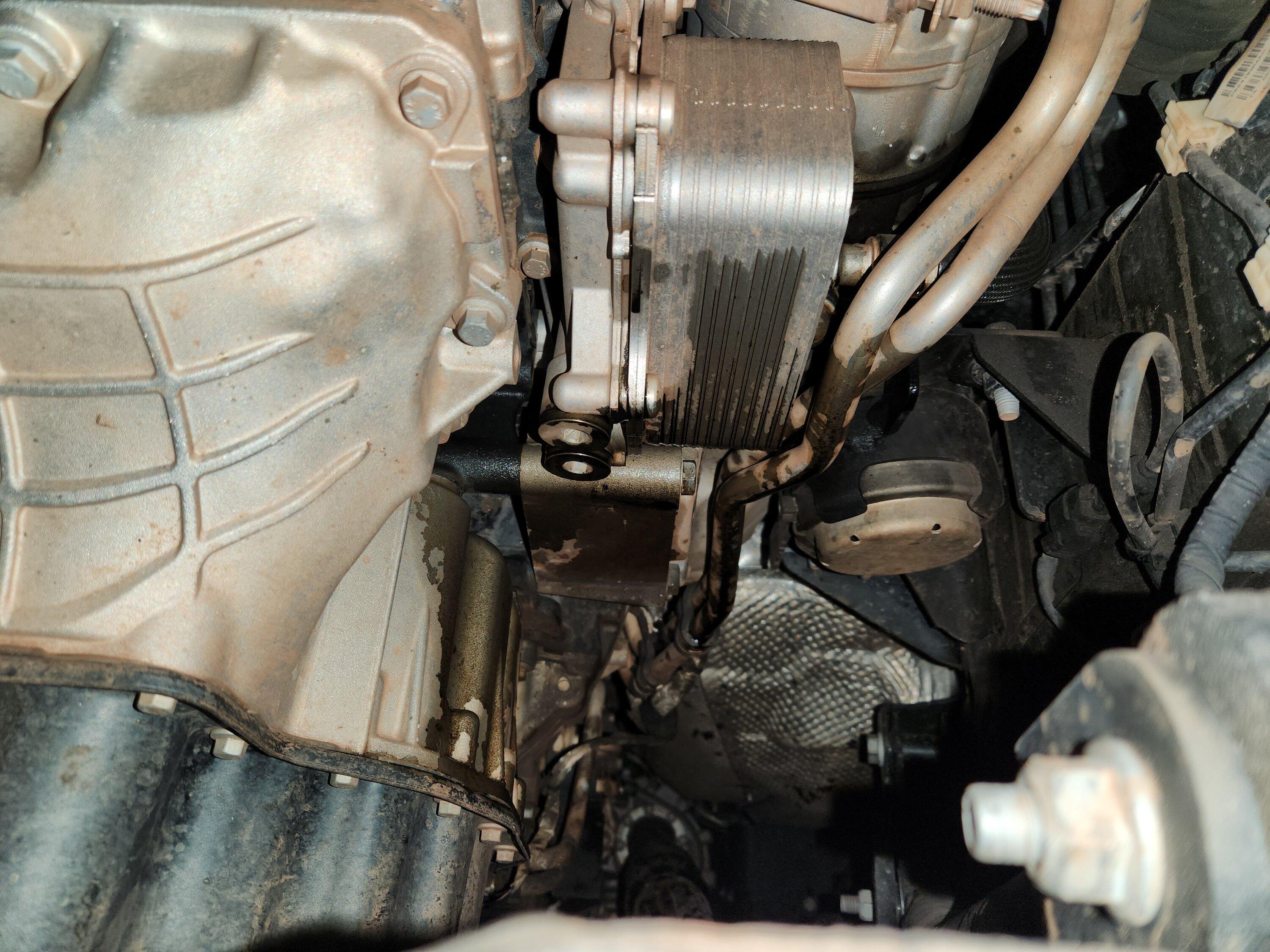

in my Promaster group, there are many instances of failure of seals around the oil cooler. And the recommendation is that if your seals leak necessitating removal of the intake manifold to repair, at the same time replace the OEM plastic oil cooler (really just a heat exchanger between oil and coolant since it serves to warm the oil during start up) with an aluminum oil cooler from Dorman.

They just did their service and replaced the O-ring along with the filter and told me thats what it was. Seems like an odd fluke to me...

Looks like I’m having a similar issue. I’m in SoCal so it can’t be cold temperature related. Barely gets to 40s at night. I need to take it in. I see the filter housing has a specific torque spec on it. I wonder if they even bothered to torque it (Or if it makes a difference).
