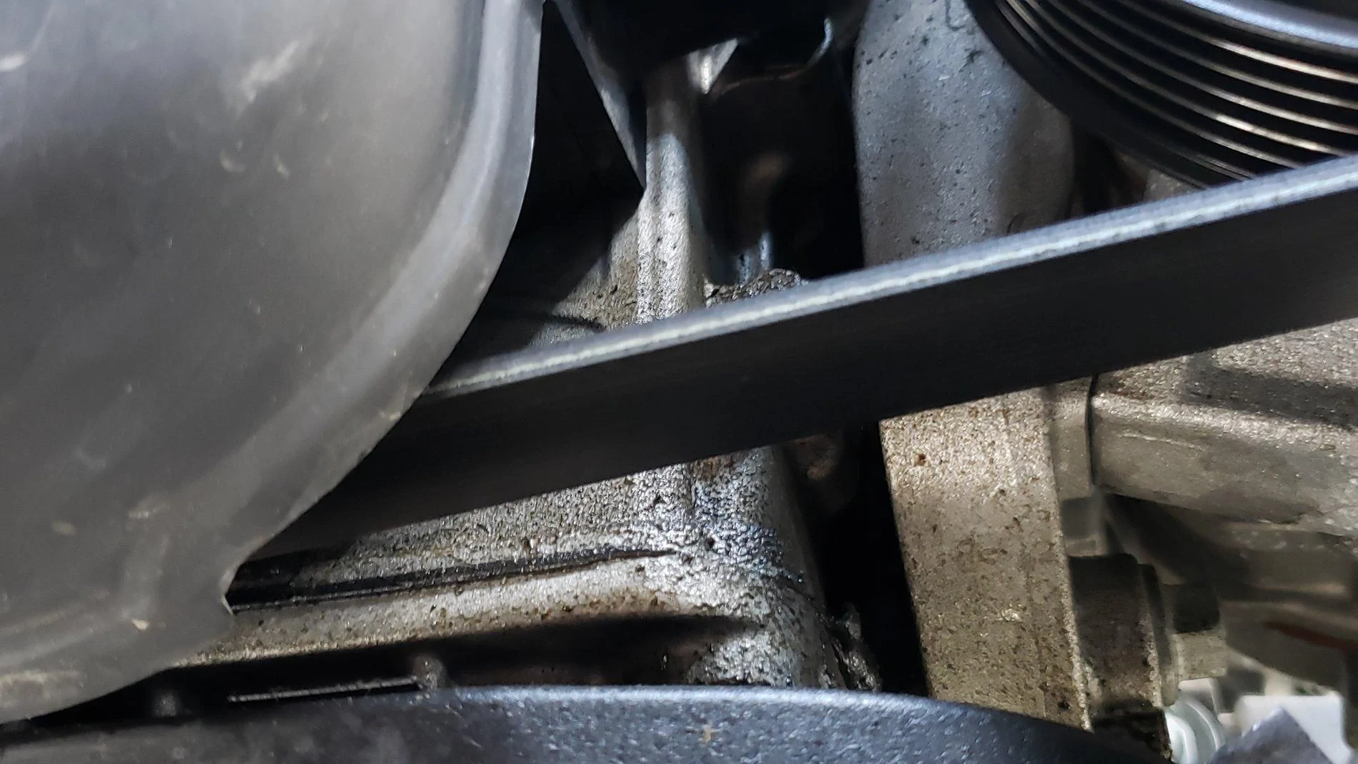

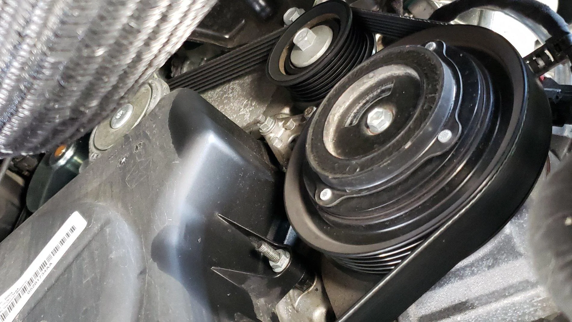

12-15-21: Got a call today. They said they put dye in it, but still don't see the dye. Going to drive it some more and see if the dye shows up. I don't think it should take long because as you can see in my photo above, it's leaking bad enough to drip off the pan bolt heads. Actually, it looked worse than that by the time I dropped the truck off.
Anyway, they also said this will "likely end up being weeks to complete" due to the fact that they have two diesel technicians, and those guys are both knees deep in diesel repairs right now. Additionally, "Chrysler only allows 5 days of rental coverage" and I need to call them personally to plead with them for more time. @JeepCares is there any way you can assist with this?
If I cannot get a free loaner while the truck is being repaired, I'm strongly considering moving on to another brand. 4 of our last 5 new FCA products have spent significant time in the shop now, and it's getting a little ridiculous.
I feel your pain. I also have an EcoDiesel with a similar oil leak.
This is our first Jeep and I like the vehicle. I can even pardon a problem as long as it gets fixed, but the dealer service has been pathetic. I've got the dye in ours now and they had to spray some type of white deodorant looking spray on the block/oil pan to try to determine where the leak is coming from. This leak started at 1,100 miles. Nothing gets done unless I get pushy and start calling/e-mailing everyone. Maybe I've just been spoiled by the brand I was so loyal to for years. They just didn't have a convertible truck with a diesel. :)

Mine called me and told me he will have a update on parts (oil cooler) on the 28th Dec. Its been at the dealer since 24h Nov.
At approx 1000 mile, i saw a little oil residue underneat the oil cooler as well, at the mating surface. I torque the bolt 1/10th of a turn and it's stop leaking.
They replaced my oil cooler seal once already and it started leaking agian. They also "resealed" my timing chain cover.

Woooo! I get to go back to the dealer tomorrow for yet another one. This new EcoDiesel has a leak too!
Going to be interesting to see how long the wait is for parts THIS time now that we're in a screwed supply chain world.
For whatever it's worth...
The dealership ended up trading me out of that Gladiator and into a Toyota truck they had on the lot. I didn't keep the Toyota long and went back to Ram and Jeep trucks not long afterward.
But, they did eventually fix that oil leak and sold the Gladiator to another family. That family had lots of problems with it too, and about 5,000 miles later it had a small underhood fire on the side of the interstate. They took it to a dealership somewhere in south-central KY and it sat there 3 to 4 months with no resolution with around 19,000 miles on the clock. That family got sick of it and traded into something else.
