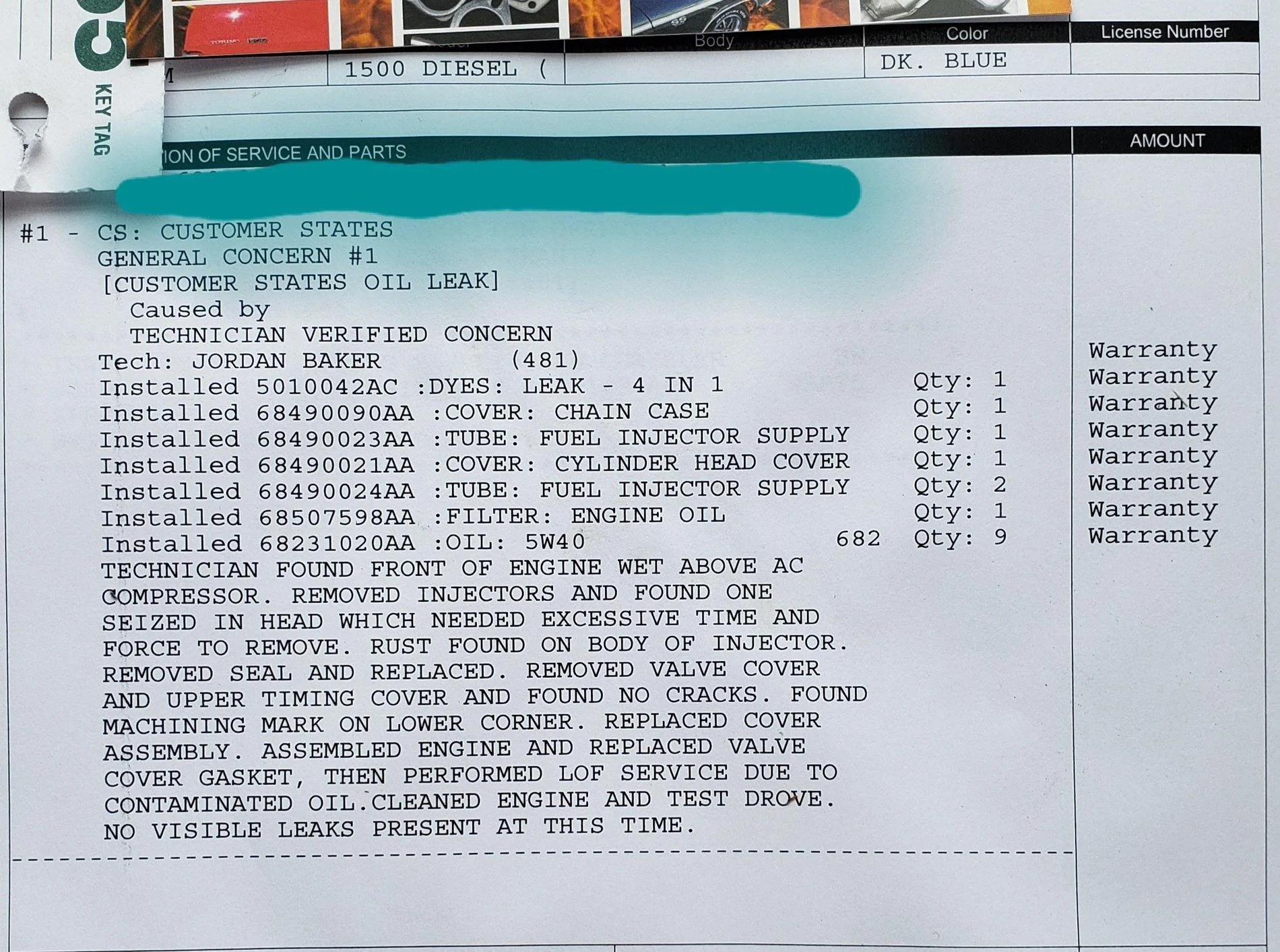

She's home! Running good and dry so far, but solidified in my mind that I don't want this in my driveway long term. Injector rusted to the head and timing cover spitting oil at 5,500 miles? C'mon man...
"Machining mark on lower corner" Sounds like a QC problem on the cover. Hopefully that does not become a widespread issue. Good to know about the injectors, might need to do a little preventative maintenance on delivery and apply some anti-seize on the threads.

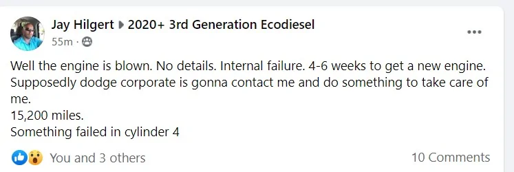

And...another fully blown engine. This makes three now that I've seen on forums and owners groups this year. I'd rather have oil leaks than grenading bearings.
