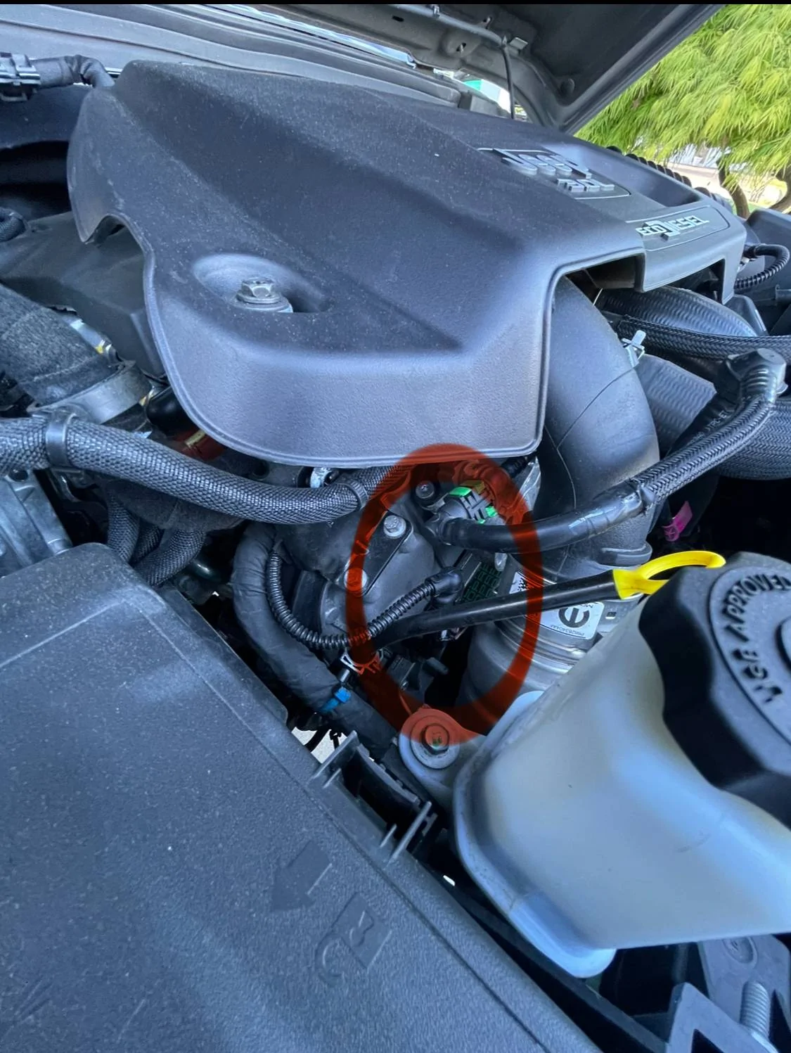

Just got mine back from the timing chain cover leak. Took him 5 days. I smell burning oil right now like there is a pcv valve hose off or something. I’m trying to wait it out to see if it’s just residual burning off.
I also have a slight bird chirping sound when the throttle is pressed. Like a vacuum leak or something somewhere or a cracked plastic vacuum line. Not sure. Been trying to drive it more and replicate it to be able to show them when I go back.

As a follow up to my previous post, all is good so far with mine. The chirping sound I heard was a vacuum line not seated properly. Which was also causing the oil smell cause that stopped as well at the same time I fixed the line.
Hope yours goes well this time around!

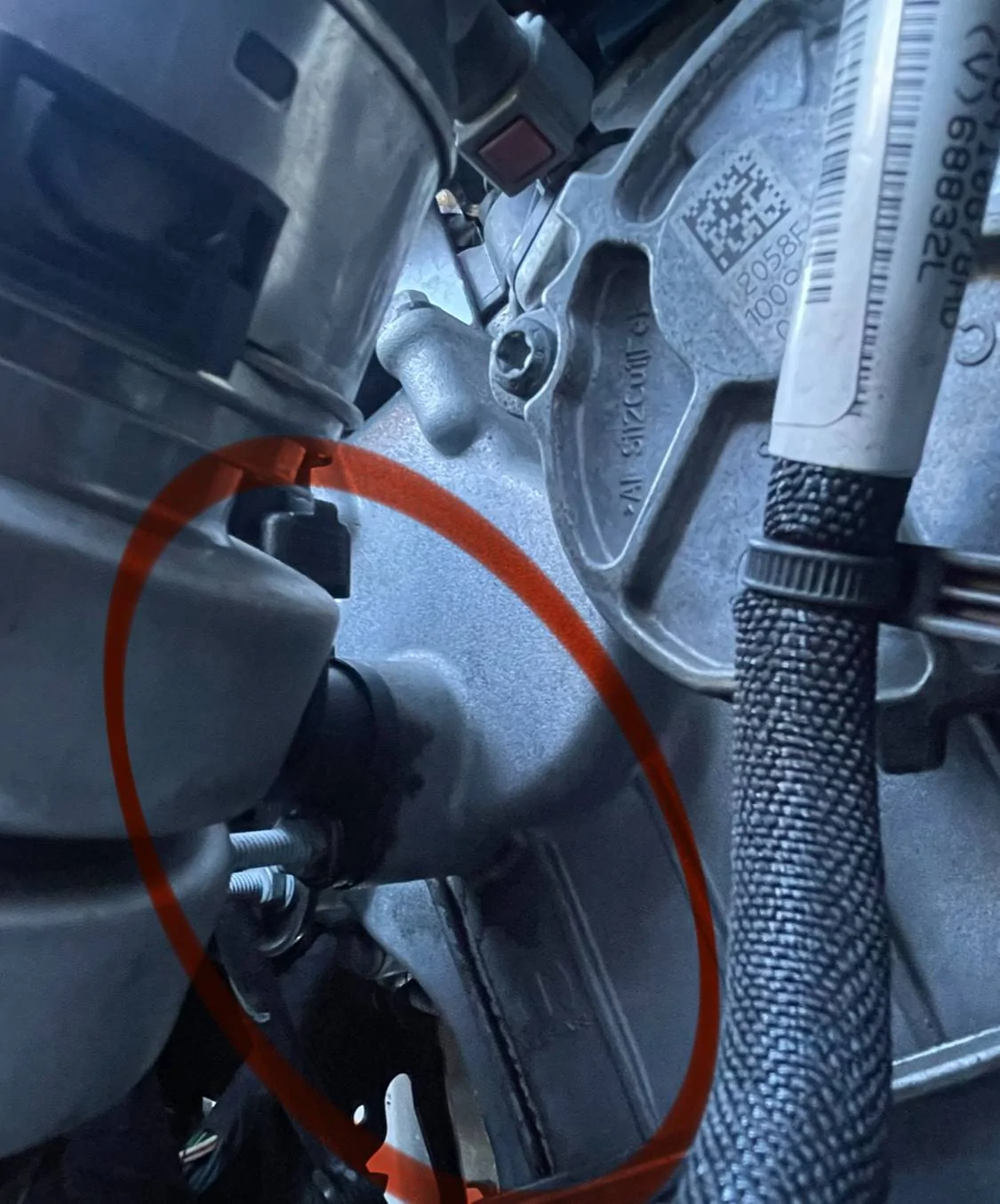

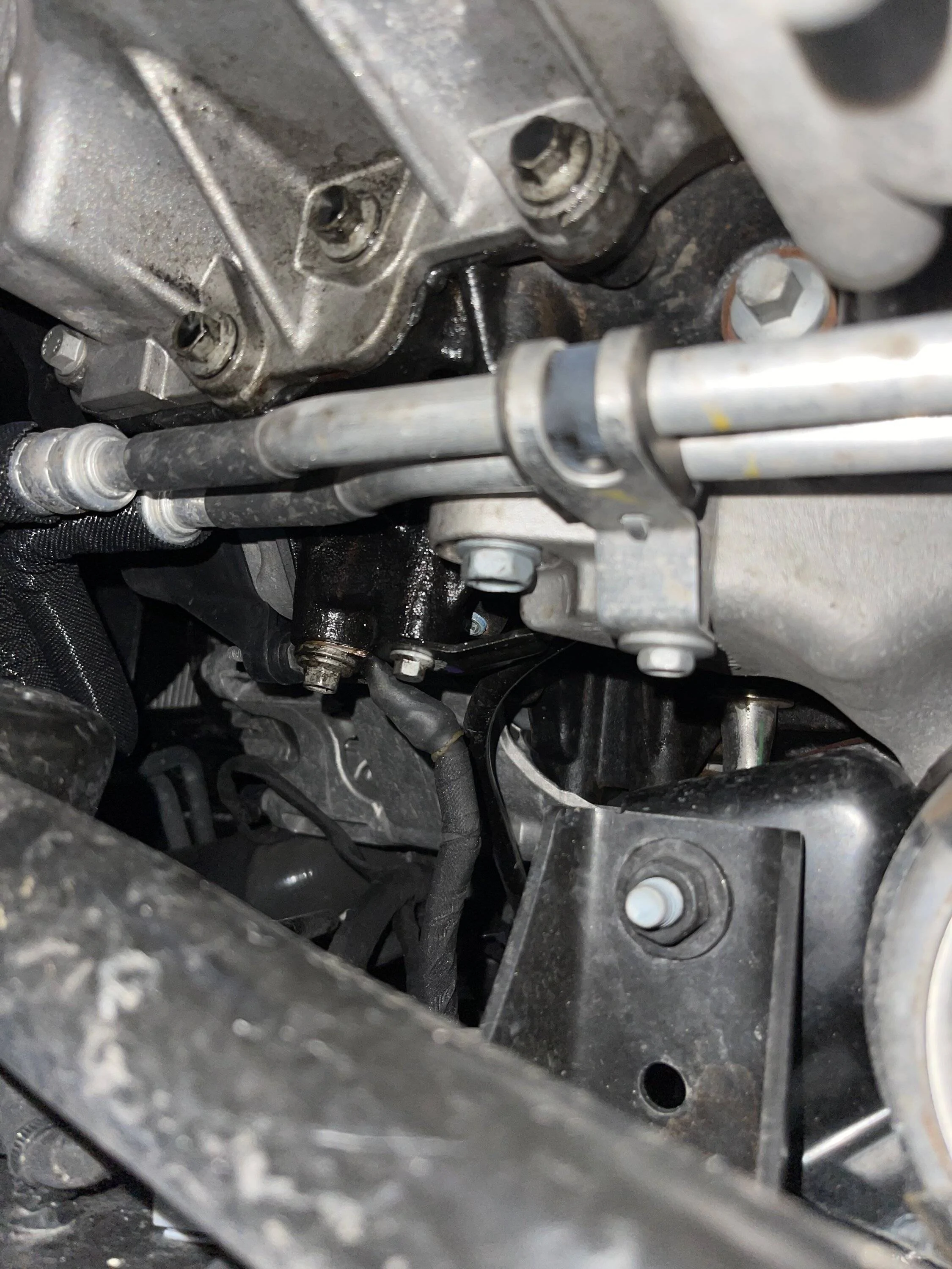

Lol this is exactly what i am doing as i don't want them to tears the whole motor apart. Mine is minor as i had caught it early. I cleaned up the area really well then applied two layers of Honda bond rtv along the seam, where the bed plate meet the block and forward toward timing cover. Been over a year and hasn't leak again.
I've got what looks like a leak starting in the same place.
I do wonder what you mean by catching it early, it's not like you fixed the problem by adding gasket to the outside of the seam? Unless I misunderstand. Hopefully it's not an issue that continues to worsen but who knows. I can live with a small drip once in a while and/or some rtv on the outside of the block to stop it.
Mine leaves a couple drops when I park it after getting it properly warm, like after a long highway drive or if maybe I get a little throttle happy on my way home from work. Otherwise it doesn't drip after normal drive-around-town conditions.
Caught it early before a bigger mess to clean up. Mine was extremely minor, just little sweat with oil. However, the rtv only lasted a couple years. I cleaned again and applied some JB weld this time lol.

Back in the day. Chevy Vega's would leak through the block. The fix was to clean the block really good with brake cleaner. Then smear JB Weld or Belzona over the area and let sit over night. You had to work the stuff really good into the pours of the block.
