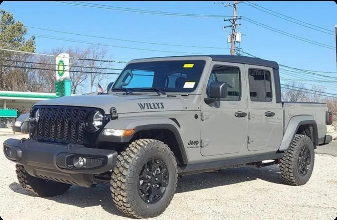

Hello everyone, im new to the forum and the jeep world as well. Just wanted to know if I can run 37s on stock gears? Its a 2021 gladiator, automatic 8 speed, 6 cylinder willys package. Or should I stick to 35s? Thats how my current jeep sits, I believe its on 32s

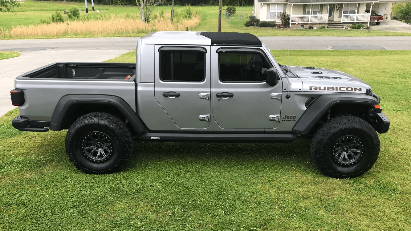

You didn’t say what gears you have but I am running 37 inch tires on my rubicon gladiator with no problems and it has 4:10 gears that is stock so yes you can run 37’s with stock gears

Im actually not sure what gears I have, where would I be able to check that?

It should say on the window sticker and I am not sure if it’s on the door jam sticker or not mine gear ratio was on the window sticker this my gladiator with 37 inch milestar Patagonia tires it rides great but I like I said I have 4:10 gears
You jeep has 3.73s. Yes you can run 37's, but say goodbye to using 7th and 8th gear. I would plan on a re-gear, but try it and see how much it bugs you. Some people aren't sensitive to being undergeared. I'm not one of them and would say get ready for 4.88s or 5.13s
Your Willys will have 3.73 gears. Rubicon, Mojave, and Sport S with Max Tow are the only trims to get 4.10s
