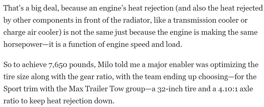

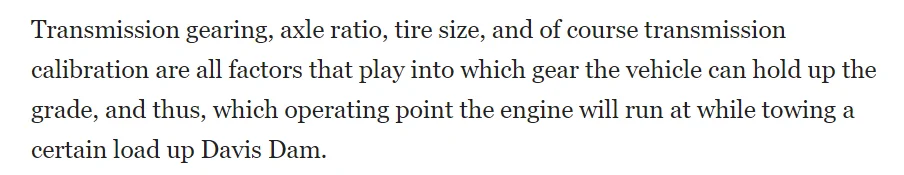

Tires as a component of engine rpm at final speed, not as factor of rpms on initial start??
This would only apply from a stop where a different gear cannot compensate for additional load. If I'm going 30mph and the load calls for 2500rpm, the trans will find the correct gear.
We should be working from the beginning (initial and acceleration) rather than final (whichever the established constant speed is, where dynamic forces are minimized/ mitigated with inertia.)
Gear selection is the servant of engine power/ mph. I think you're trying to have the tail wag the dog here.
Again, acceleration/steady mph or rpm shouldn't be the concern. Braking should be the focus. I'm sticking with my very vague initial assessment. You can get up to 55-65mph no matter what gearing you have.
With 40s, I would guesstimate that you can safely tow 30% less than stock. Probably even less
