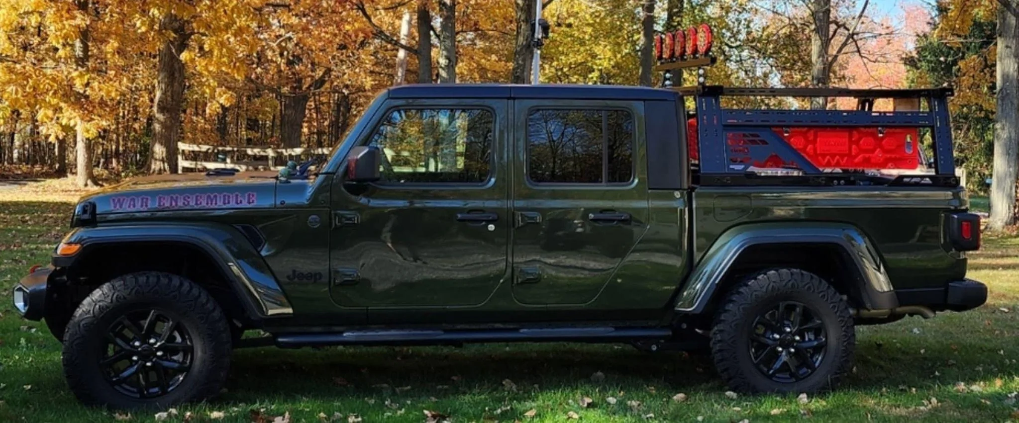

Thanks for all the tips and tricks for my wiring job. Got the lights wired yesterday and it was far easier than I was making the job out to be. I'm not positive I love the height of the bar though. The lights blast over the cab and have zero deflection, so I might just leave it as is.

they do look pretty high but ill bet they throw a great amount of light.
mine are much lower and the cab does get in the way a little but gave me a great excuse to add a couple to the front bumper as filler light and now its perfect.

It is about 2" too tall, but I can fold it flat or since I made it QD, I can remove it completely. When I add a shooting platform, the bar will be perfect height for a rifle rest, which everyone needs, lol.
