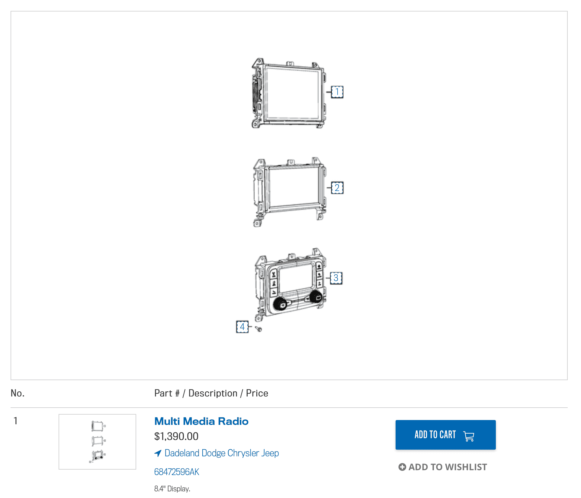

Hey guys new Jeep owner here and new to the forums,
Can anyone assist and tell me which of the following part numbers is the 8.4 screen WITHOUT NAV
Thank you
68517321AK
68472623AK
68472622AK
68472621AK
68472599AK
68472598AK
68472597AK
68472596AK
I have a 22 Sport S Export Model with the 7" screen.
All item descriptions just have them as '8.4" Display'
Any help would be greatly appreciated

Further Information:
My 7" screen does have the functional compass app if that is part number modifier.
& I do have the upgraded Alpine Sound Sytem
Thank you
68517321AK
68472623AK
68472622AK
68472621AK
68472599AK
68472598AK
68472597AK
68472596AK

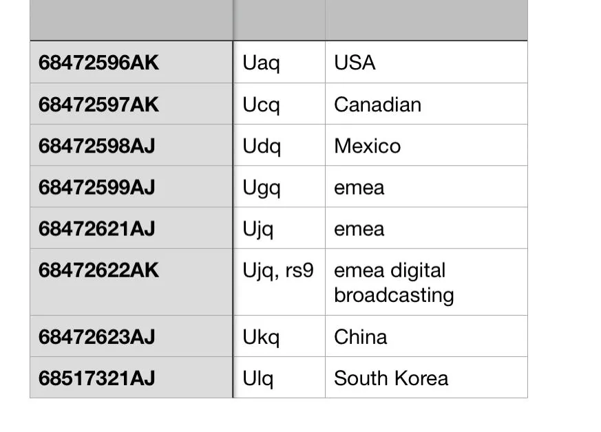

d7000
Oct 12, 2022
MO
2021 Gladiator
From my searching the correct radio for USA vehicles is 68472596AK. The other radios are for other countries.
