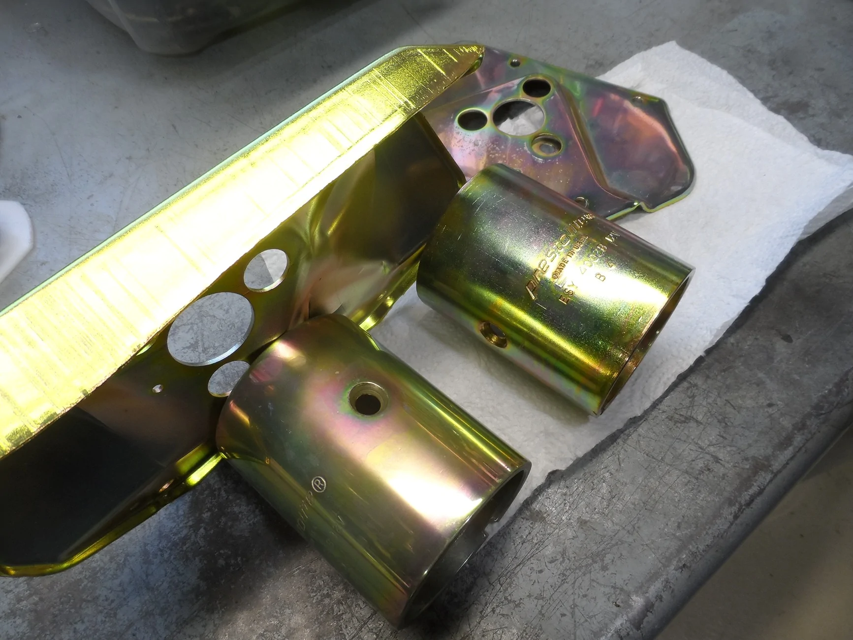

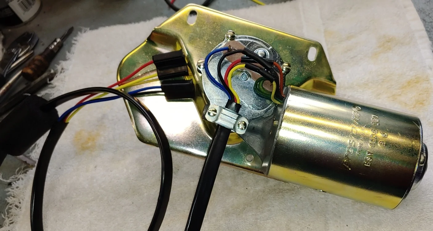

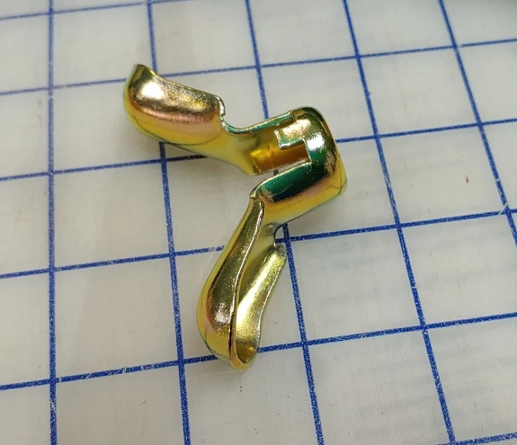

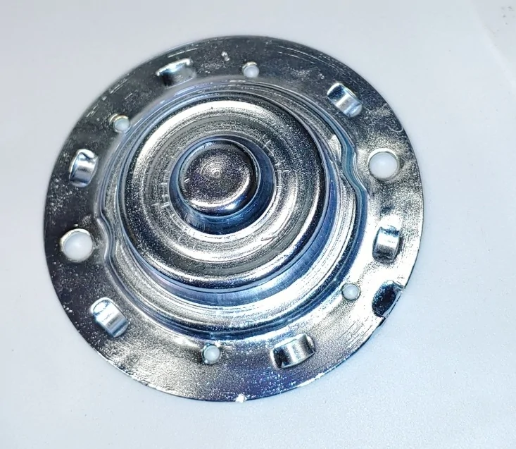

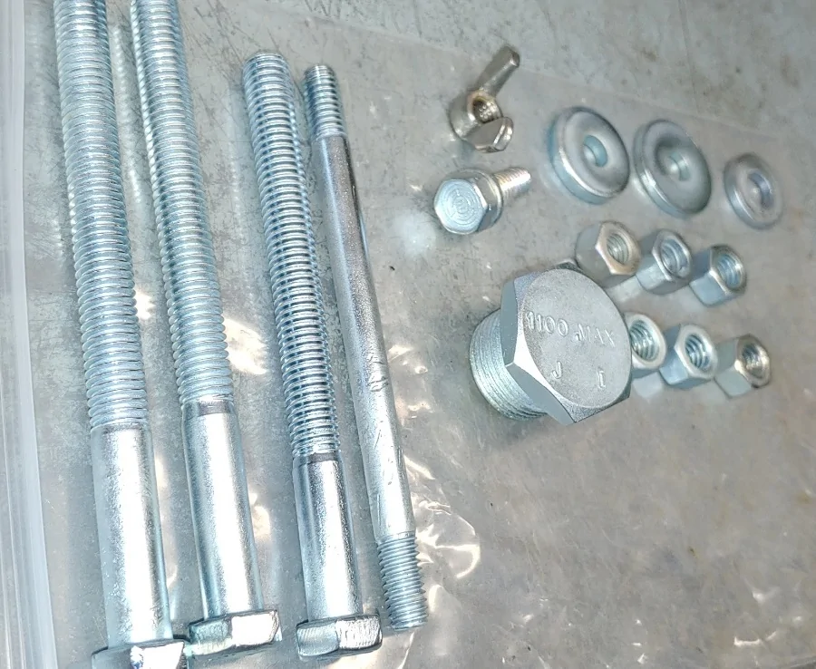

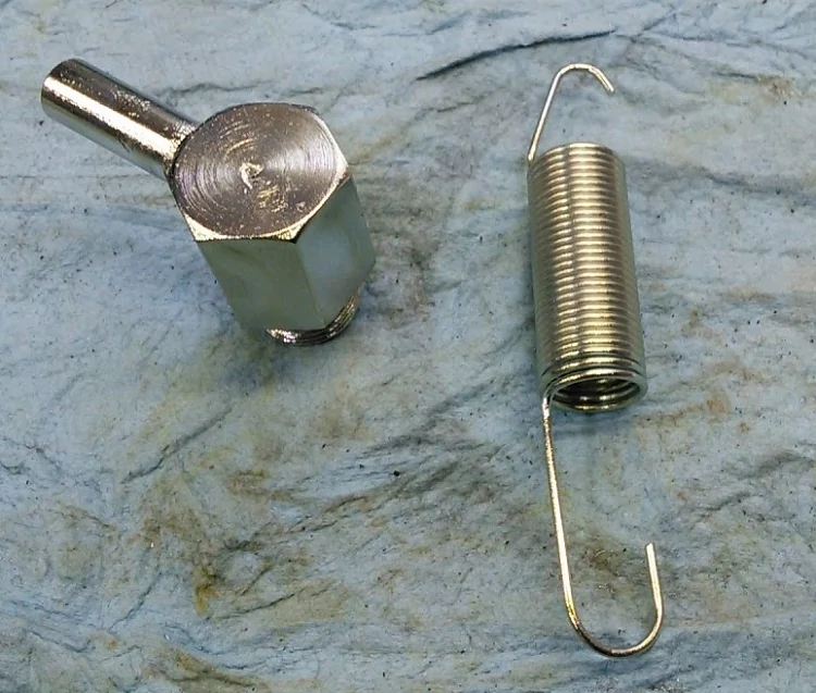

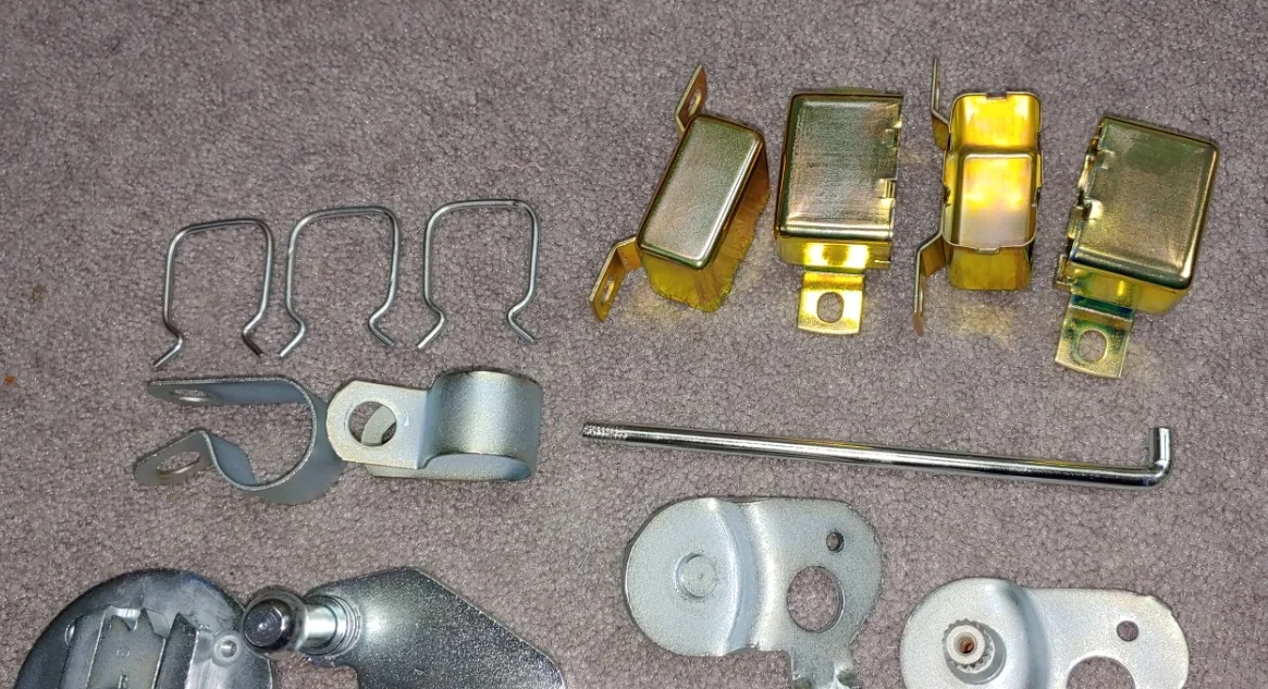

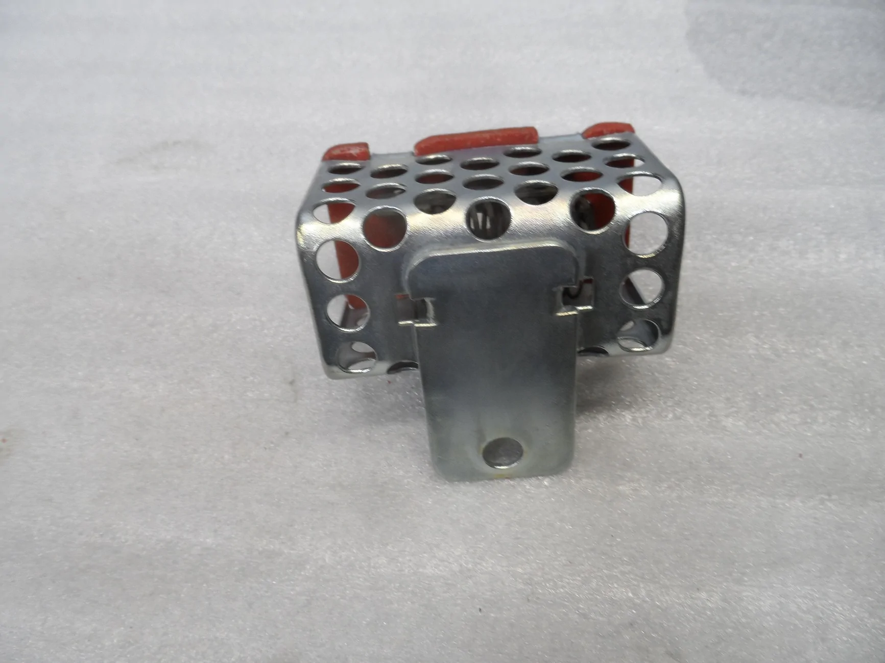

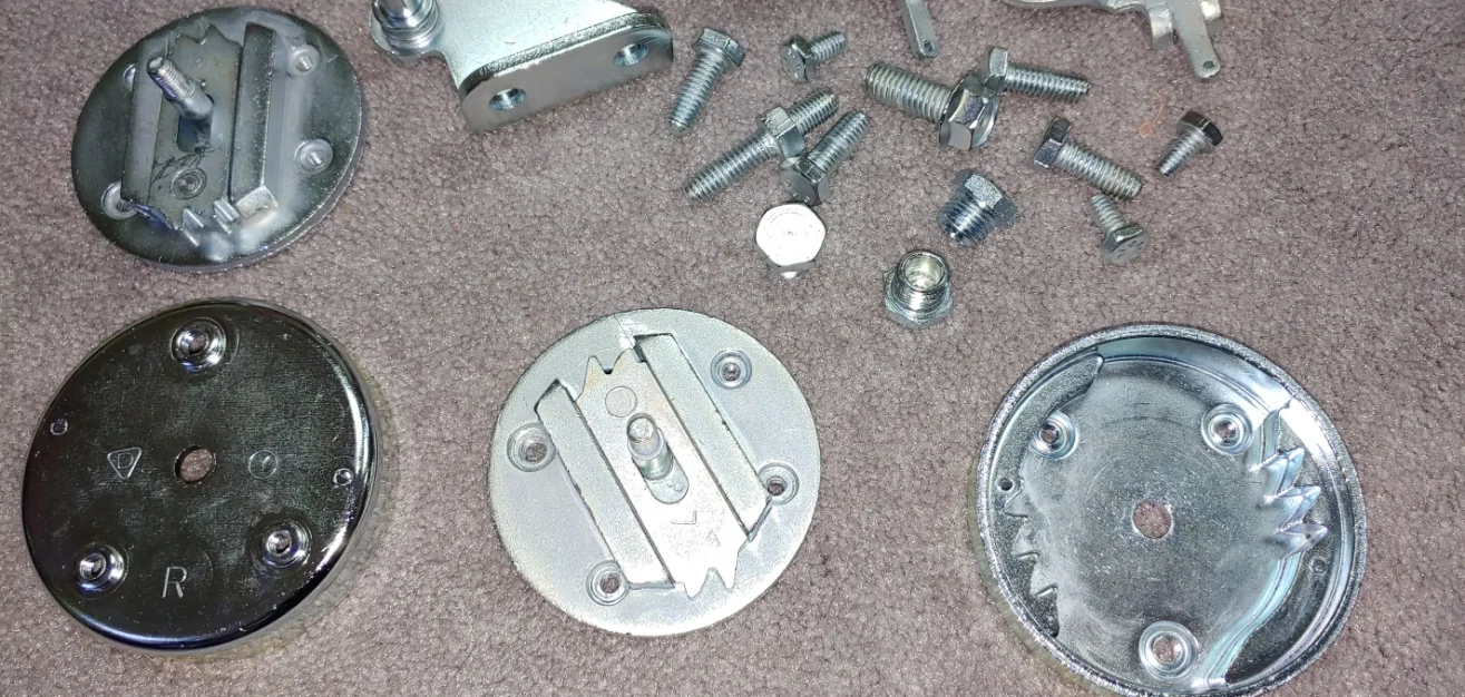

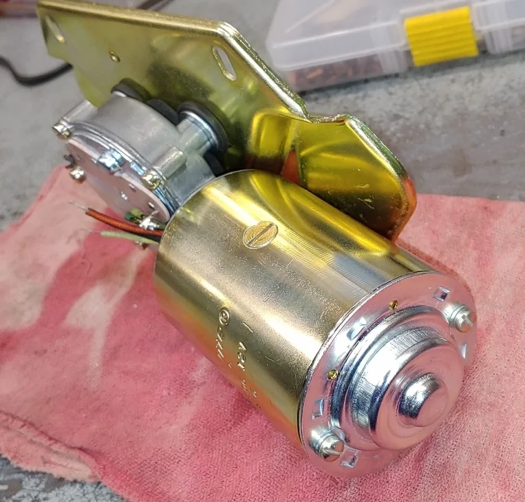

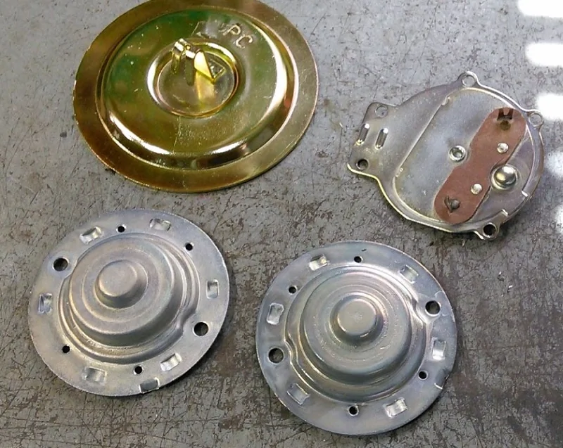

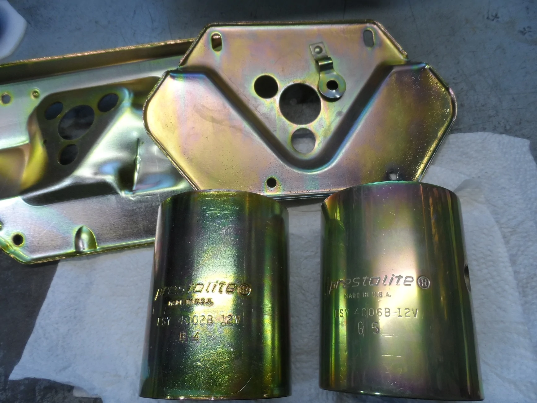

I do this for restoration of classic cars.

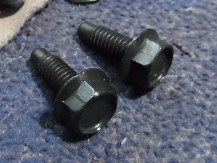

I plate in zinc - yellow zinc, black zinc and clear/blue zinc.
The color depends on the passivate used, but it's all zinc.
Zinc is active and will quickly go to a white zinc oxide. The passivate (commonly called chromate although there are multiple versions) makes the zinc's outer layer more "passive" and less likely to quickly oxidize.
Zinc plating is "self healing" in a way in that if it gets a scratch or gouge, the zinc will still tend to protect the steel below, being it's so active.

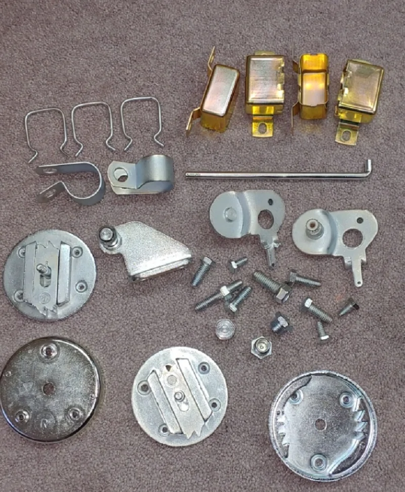

I would like to add, reinforce, actually, what they say in their blog -
Caring for Gold Zinc Chromate Coatings
To keep Gold Zinc parts looking great and lasting longer, follow these simple maintenance tips:
  • Avoid Harsh Cleaners: Strong acids or alkaline cleaners can wear down the chromate layer. Use mild soap and water instead.
  • Wipe Off Moisture & Salt: If you drive in wet or salty conditions, rinse your parts to prevent buildup.
  • Apply a Light Protective Coating: A spray wax or light oil coating can help seal the surface and extend its lifespan.
  • Minimize Scratching: If the coating gets scratched, it exposes the base metal. Be mindful when handling or installing parts.
I've seen harsh cleaners actually take the yellow away, which means it's already eating into that outer protective layer of the zinc plating.
Some SOAPS will do this!
Zinc platings after passivation are rated using the "salt spray test" - how many hours they can survive (more detailed than that, but that's the basics). In other words, yes, salt will eat into it, so if you drive the beach or salty roads, wash it off, but avoid harsh car wash chemicals.
I've found a coat of a wax or even Eastwood clear, does a decent job - it lets the color show while protecting it.
100% agree with their care "guide" above.

If Metalcloak uses plating like this - which is more expensive than paint or powder coating or other processes, it could suggest they aren't cheaping out on the part finishes.
If you are concerned about appearances, it can always be plated again.
All of the parts you see that I did - were originally plated decades ago. The wiper motors are from the late 1960s, some of AMX reclining seat parts were from a 1970.
Some stuff sent to me really hasn't been all that bad - and it's had no care in many years.
Follow their suggestions, you won't have crusty Jeep parts, unless you prefer that look LOL
