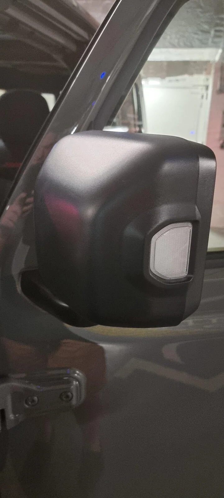

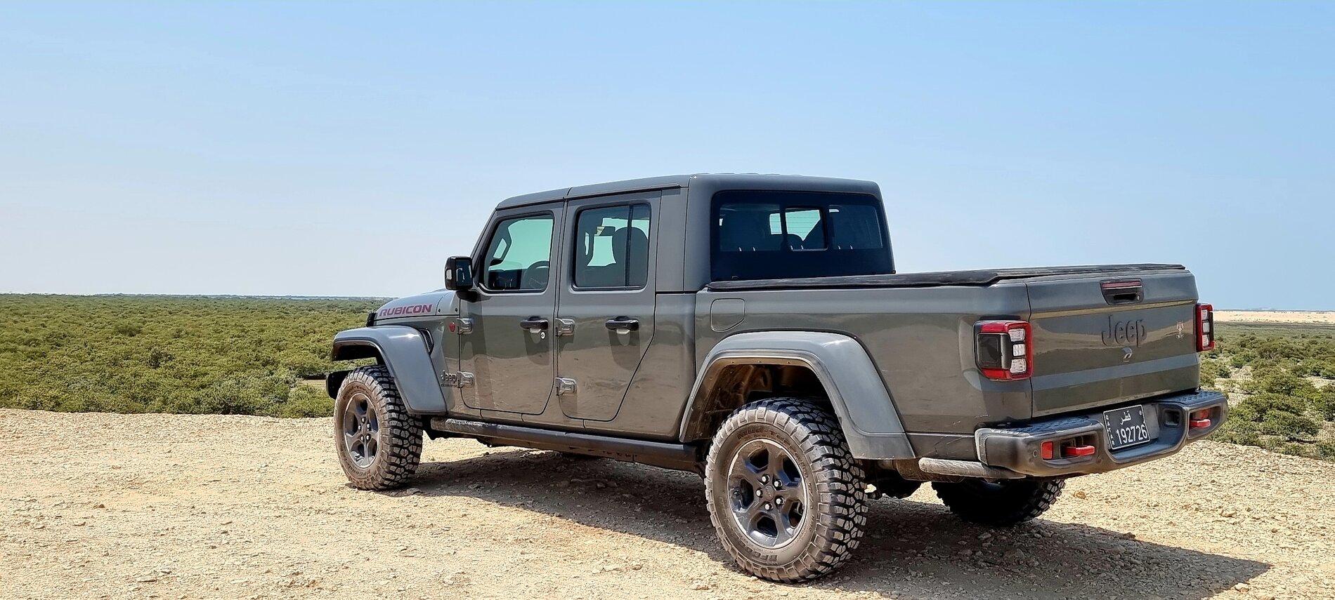

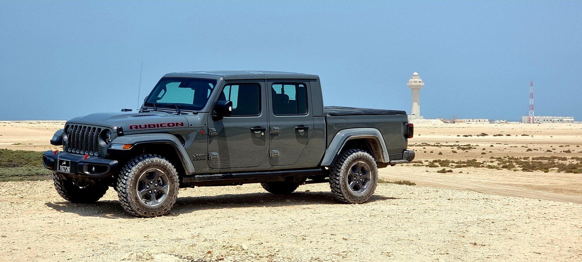

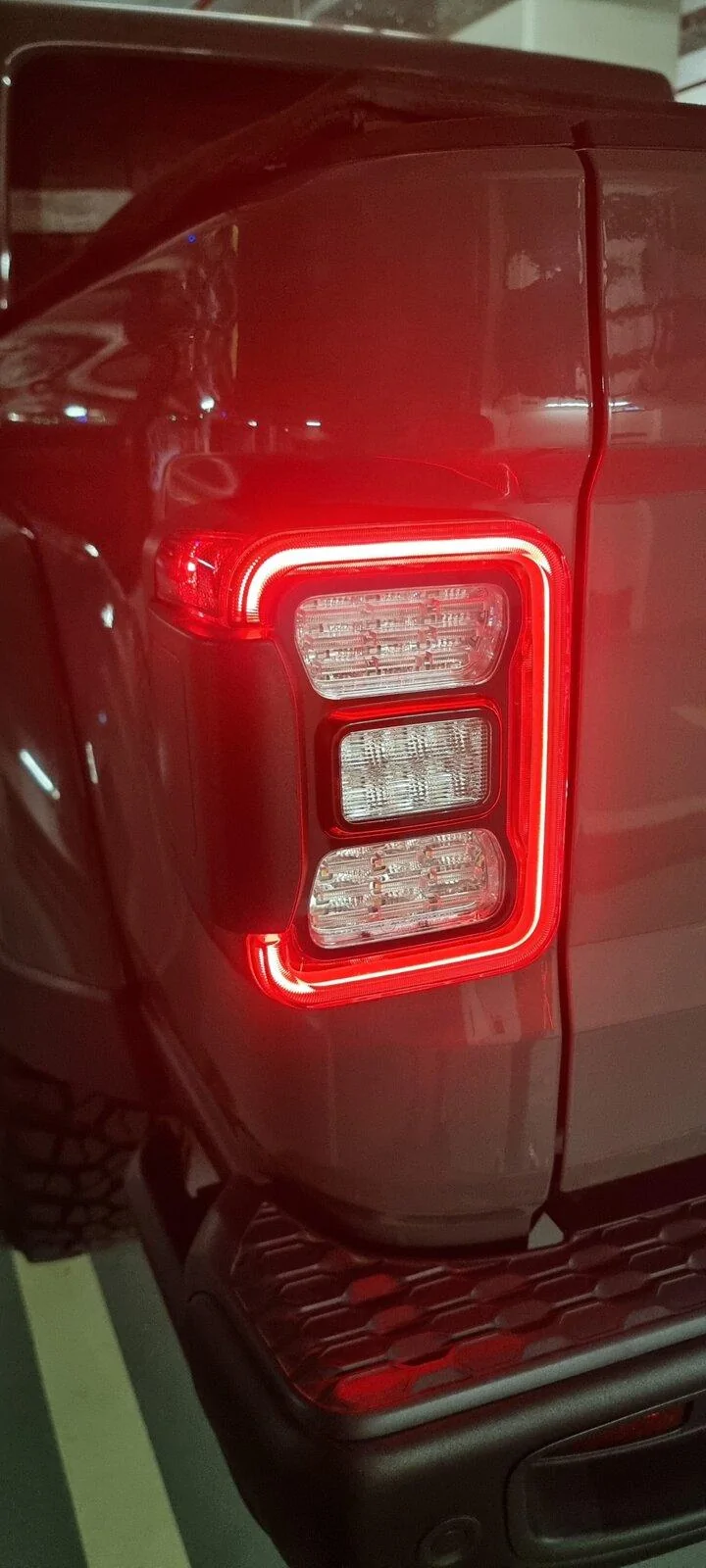

So taken collection and now 400km in. Observations? I don't like the BFG MT, noisy, wobbly and dig into the sand (35" ATs to come). Having always run diesels it feels a bit gutless but I'm not in a rush so can live with that.
I'm impressed with comfort off road, the level of 'tech' in it for a Jeep, Android Auto (how did we get by before it!), the feeling of quality (my JK doors never closed so solidly) and generally I'm very impressed and pleased.
Plans are 35s, levelling kit, mopar steel bumper and winch, some form of bed cover and a tent. I'll be driving this home from Qatar at the end of my time so want to take the opportunity to explore.
I love the rear lights (different from US) and the Euro wing mirrors. Glad to be here.
