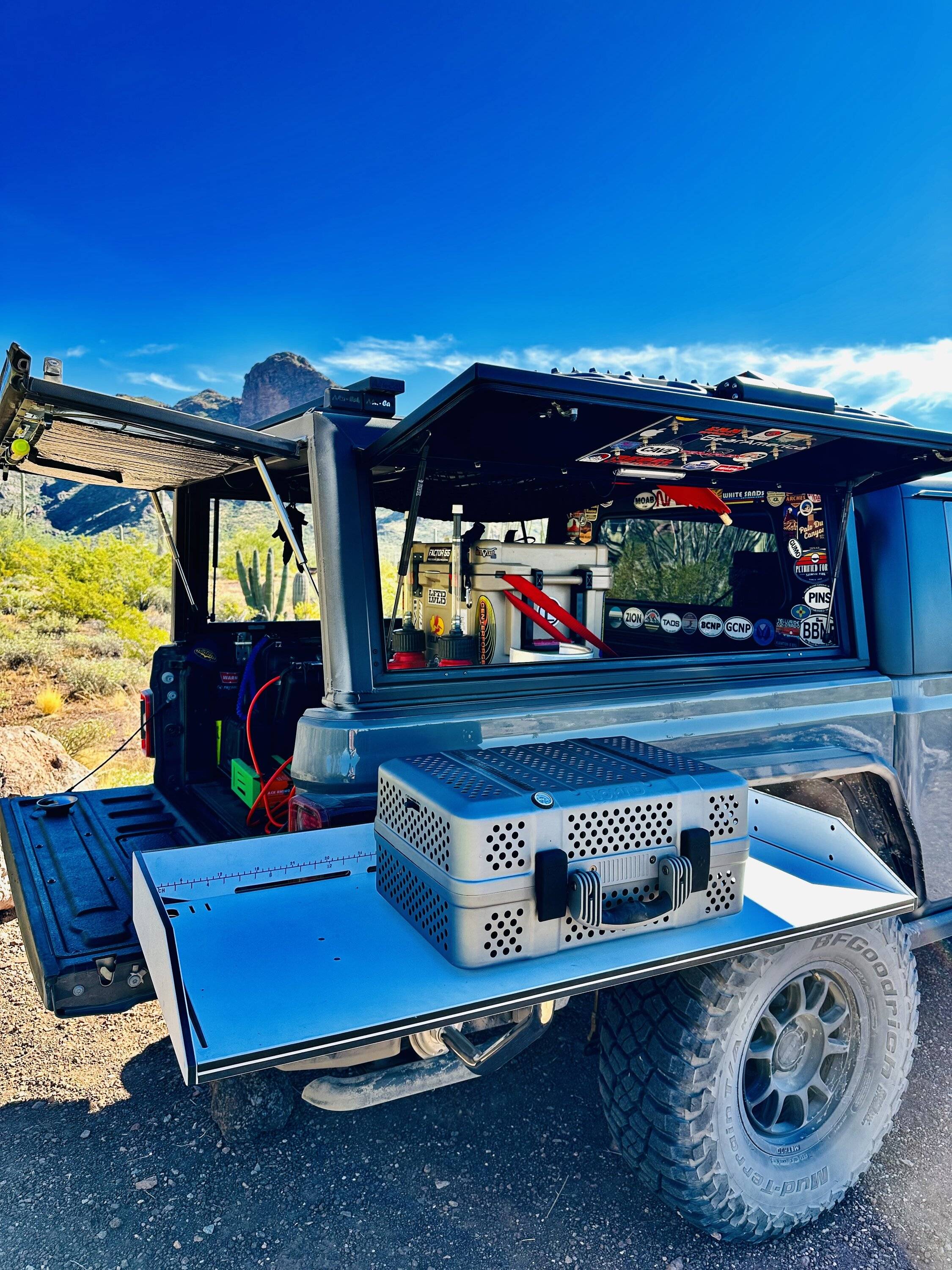

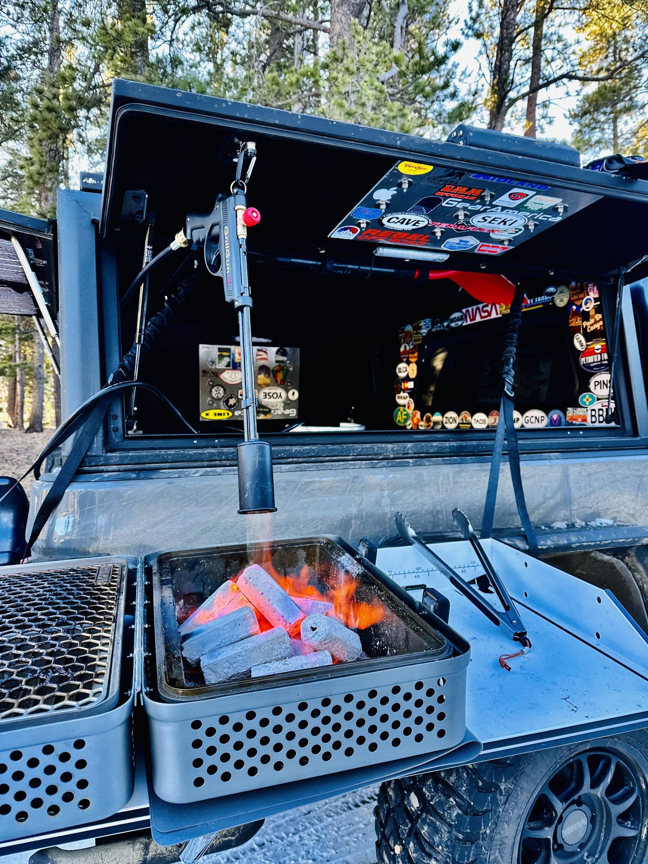

@Gringo&Gun , how do you like that Nomad grill?
Great product if your die hard coal guy. Produces very little heat on surface set over. I still run a silpat mat out of caution.

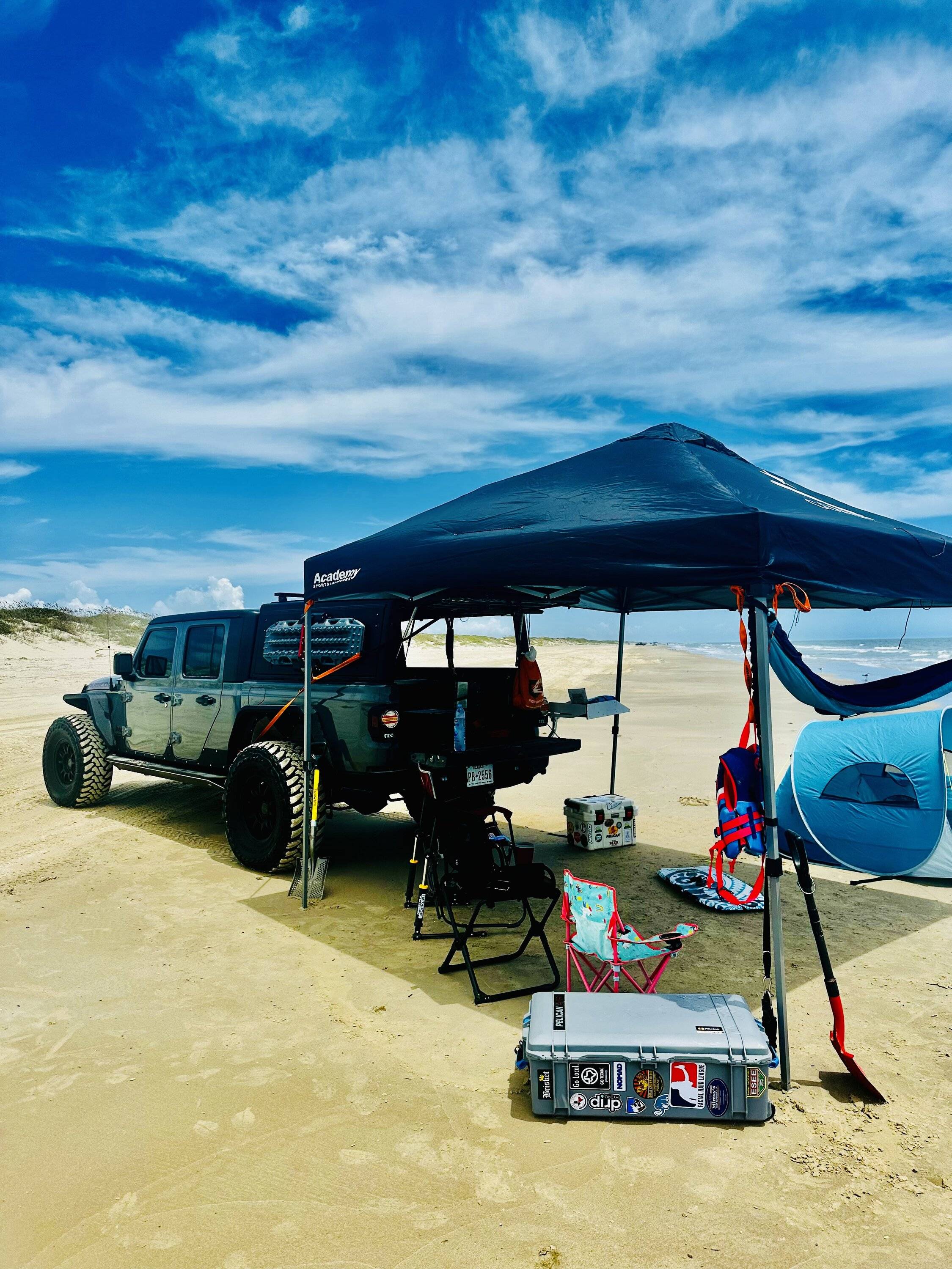

Sweet build. I’m surprised to see no awning though!? I suppose the doors on the alucab provide some coverage, but it seems like more coverage wouldn’t hurt!
No doubt. Haul a tent now. Been looking for a rear mount option. Below and tree hunt for now.

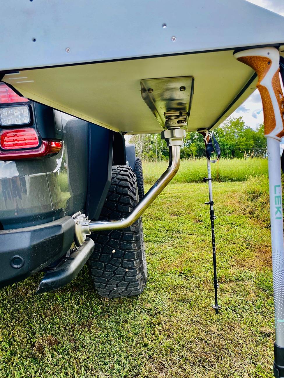

how did you connect the Magma mount to the lower side of the JT?
This is a great addition to my work truck JT as a table when I do installs.
Gringo&Gun
Gringo&Gun
May 4, 2020
97
303
Infiniti
Chef
Not a good pic. Stainless plate is custom. Mounted with the slider bolts sandwiching custom mount between slider and slider frame mount.
