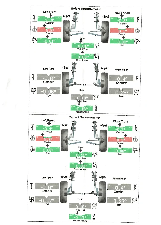

This is probably not helpful since I don't know what setting mine is at. AEV does not have 'holes' they use a cam instead. I'd have to look at it to see. But....with the 3" HD springs
Jeep Gladiator A Small Tip for Those with Geometry Correction Brackets Screenshot 2024-07-08 at 21.28.56
I need to have the toe adjusted though, it's not feeling as tight as it did with the 2.5" SD springs and nothing else changed.
