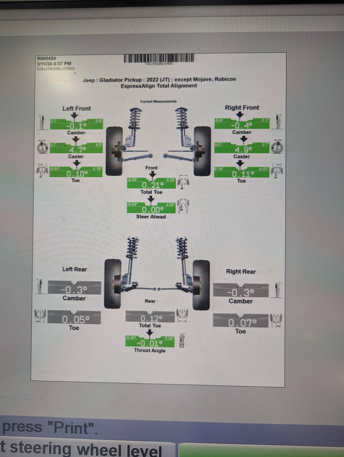

So I stood on the shoulders of greatness once again! Thanks to information here.
A little context, Installed the MOPAR lift with the LCA's and Bilstein B8 5100's netted a little over 2.5" of lift in the front. First 3 weeks, noticed a shimmy, did a bolt check and nothing. After the bolt check, when hitting bumps a couple of bumps ended up giving me full wobble where I had to stop. Had my alignment check and total toe was a little over spec at 21 degrees (10 passenger/ 11 Drivers side) Caster with the MOPAR LCAs was 4.9.
Jeep Gladiator Geometry Correction Brackets (my experience with the wobbles) PXL_20240311_214154941.MP
Added
  • JKS drop brackets,
  • Metal Cloak track bar (replaced a RC Track Bar), and
  • added a steer smarts sector shaft brace for good measure.
The truck was running really stiff, like a buckboard wagon before and I felt like I was beating it up driving down a paved road.
Caster measures around 6.5 on the first hole with the JKS brackets. It is a night and day difference. My JT did not like 4.9 caster and the change in control arm angle. The truck feels planted with the Bilsteins and I feel like the ride is better than it was when it came from the factory!
Shout out to the guys at Round2 Offroad in Cedar Park TX for entertaining my questions and the install.
