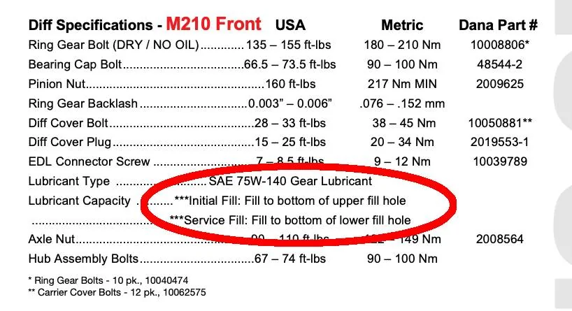

SPECSHEET-JL-FRONT-UD44A-42019 (jlwranglerforums.com)
IF that doesn't link doesn't work look up the AdvanTEK® Front Axles spec sheet on dana's site.
Lubricant Capacity ...........
***Initial Fill: Fill to bottom of upper fill hole ........................................
***Service Fill: Fill to bottom of lower fill hole

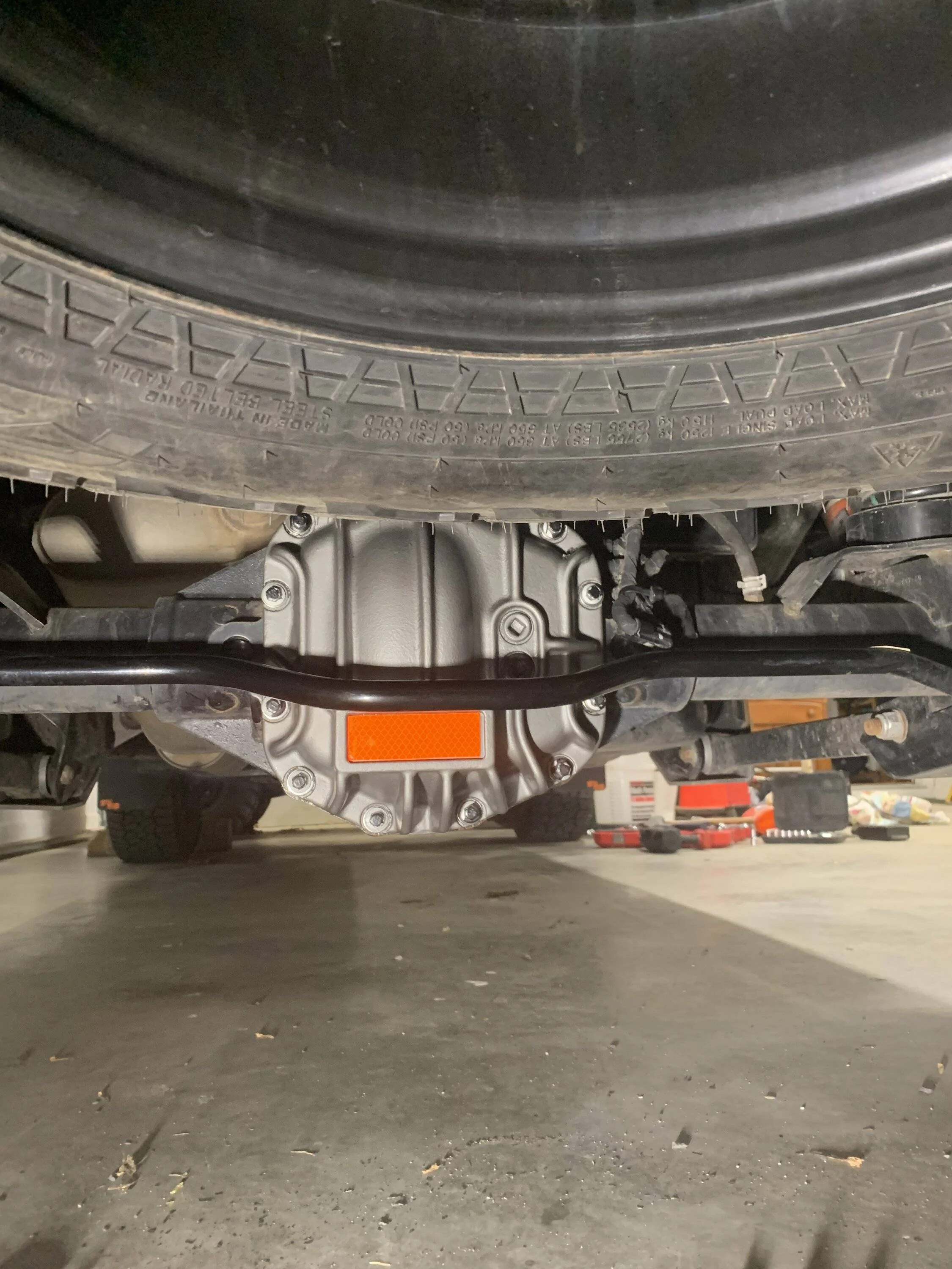

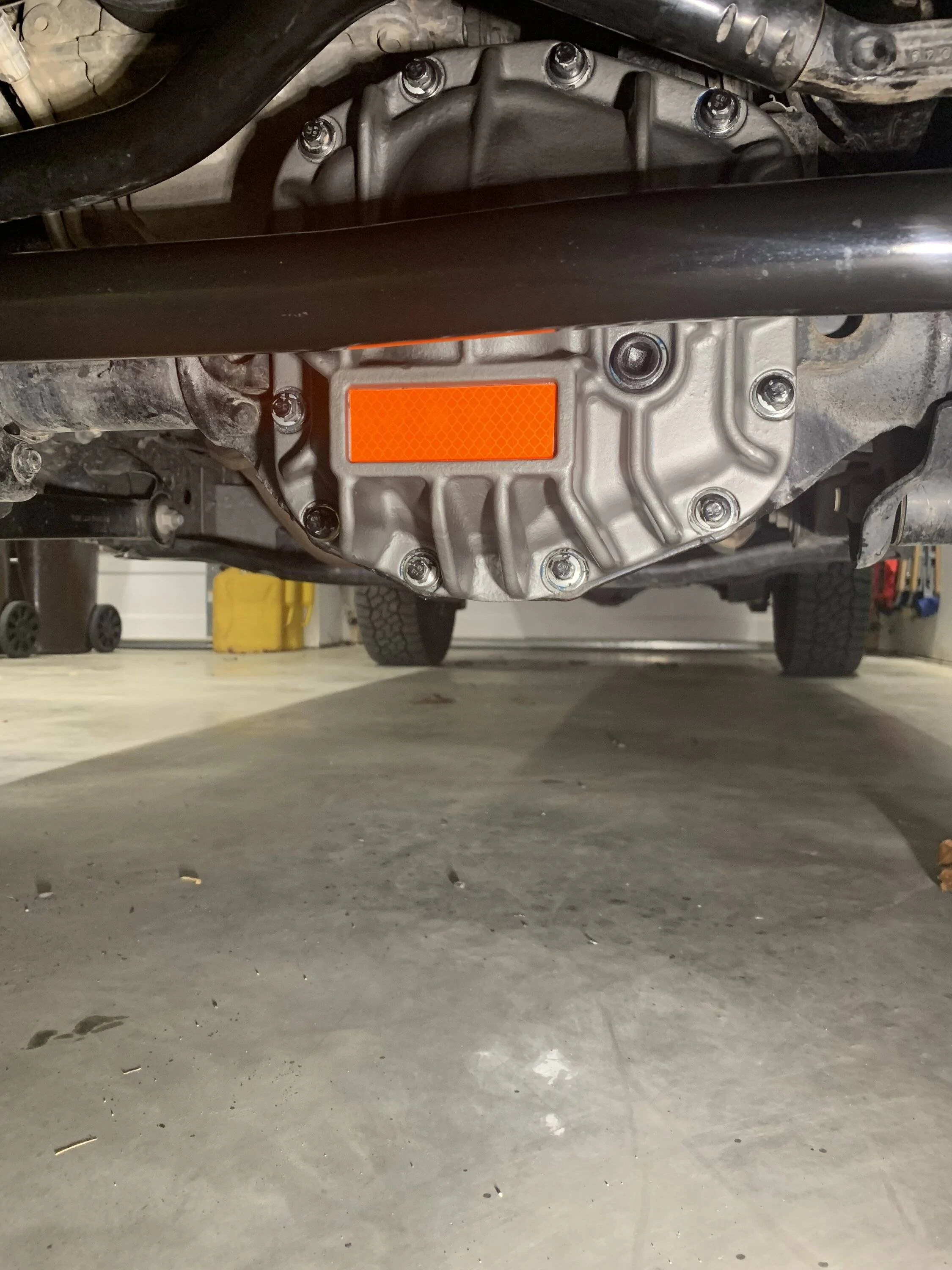

I have them on mine, use the lower hole, it measured the same as factory! I was gifted a set by a guy here “CrashEd” and sandblasted and repainted, and used permanent locktite on top plug and painted it when painting cover while other is black….Jack

Perfect, thanks guys! Wish I'd found that spec sheet earlier.
