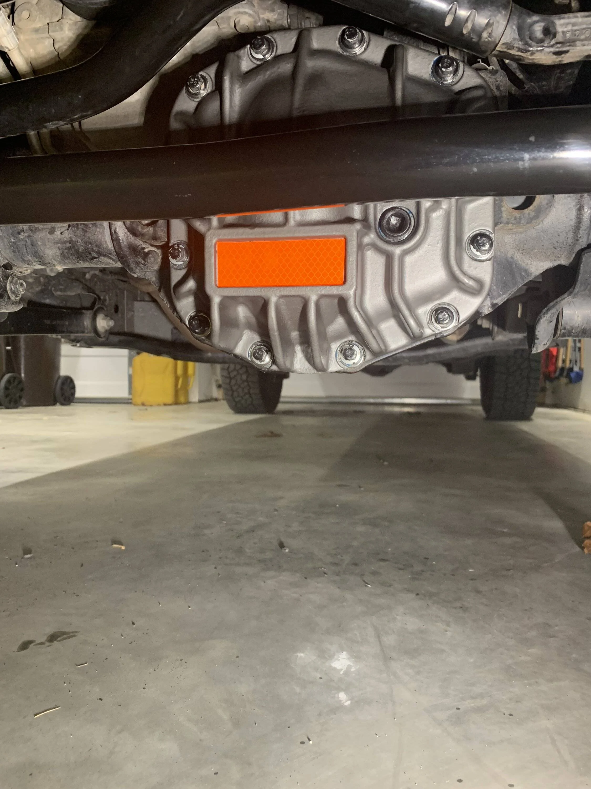

I got a set of used ones from a member here, no bolts included, had them
sand blasted and sprayed with “steel it” paint, reused the factory bolts, even added a thin stainless washer under the factory bolts. Playing with it and checking it had at least five threads on the bolt engaged , has held up good…..Jack
