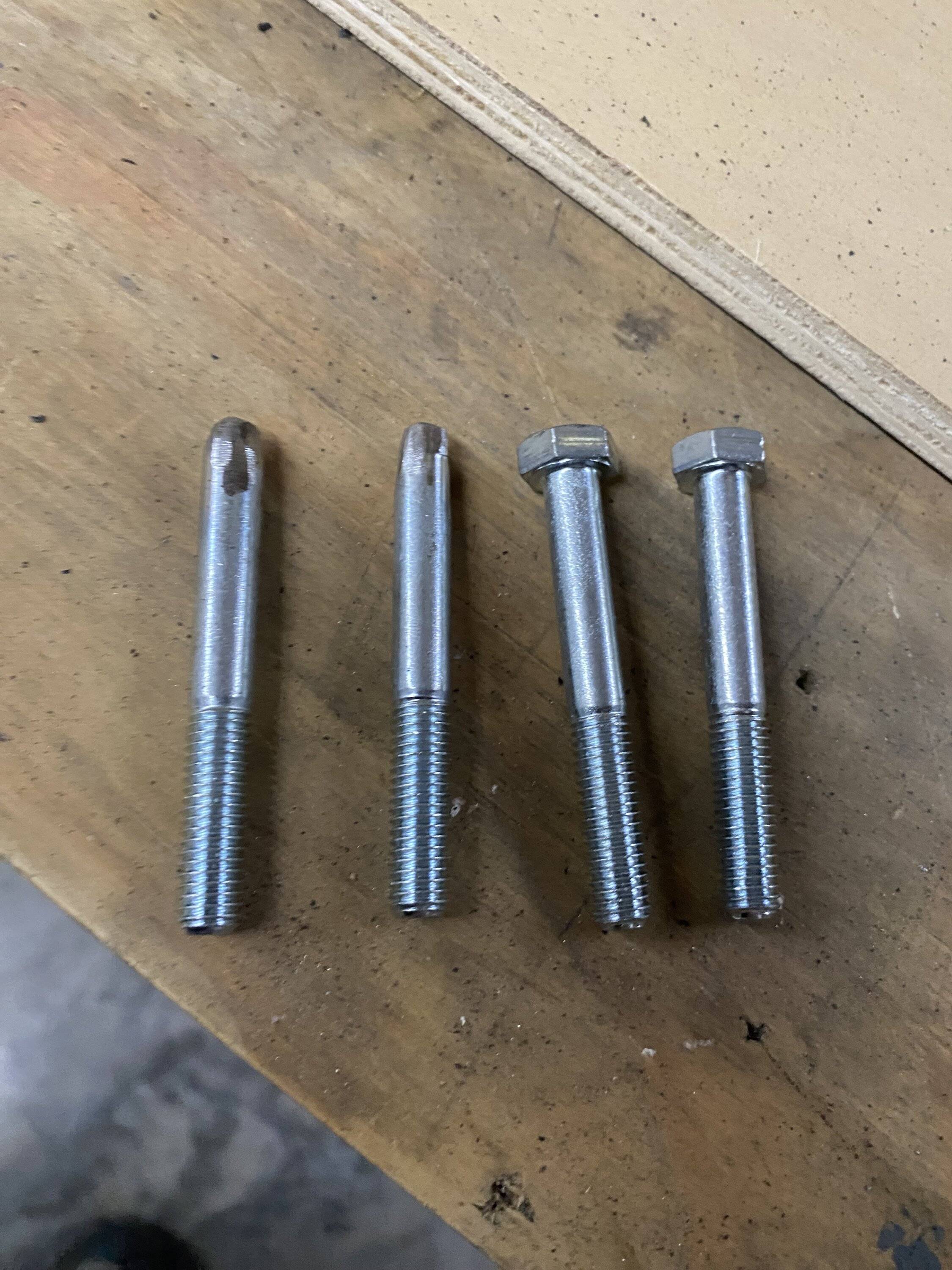

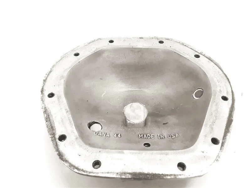

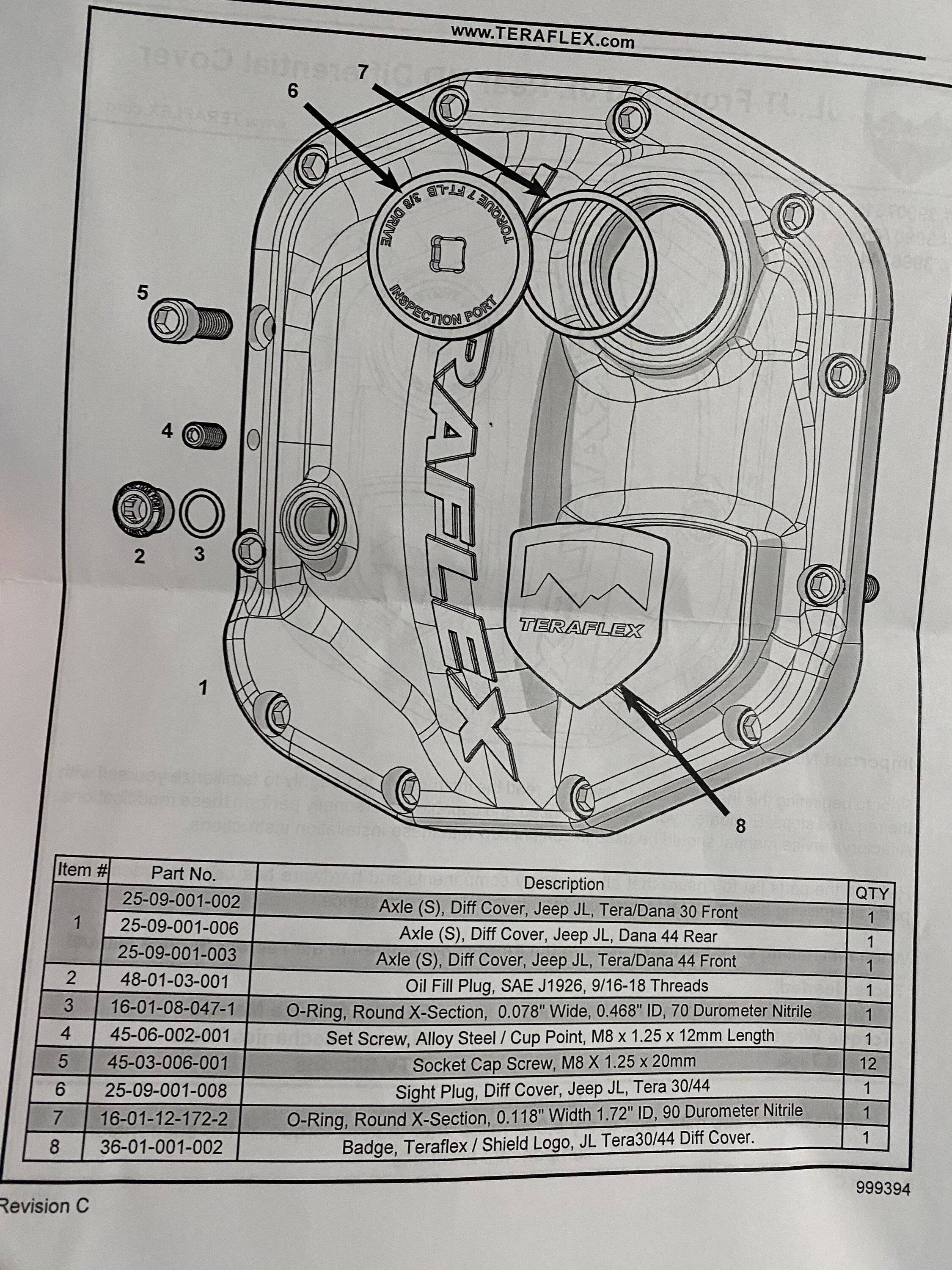

What is the purpose of the set screw?
When the cover is RTV'd in place and you want to take it back off, it acts as a release mechanism to break the RTV bond. Having serviced mine already, it works.

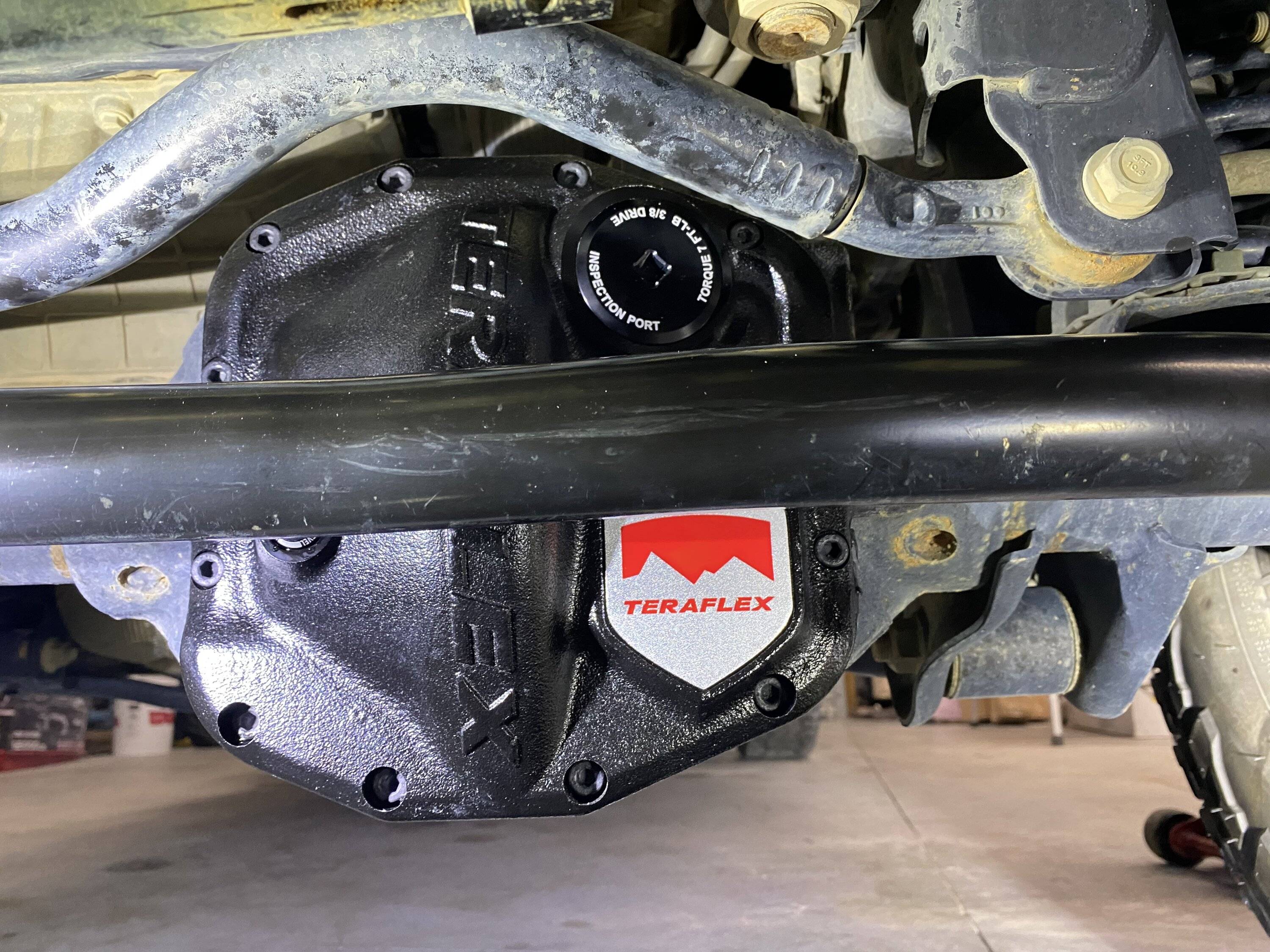

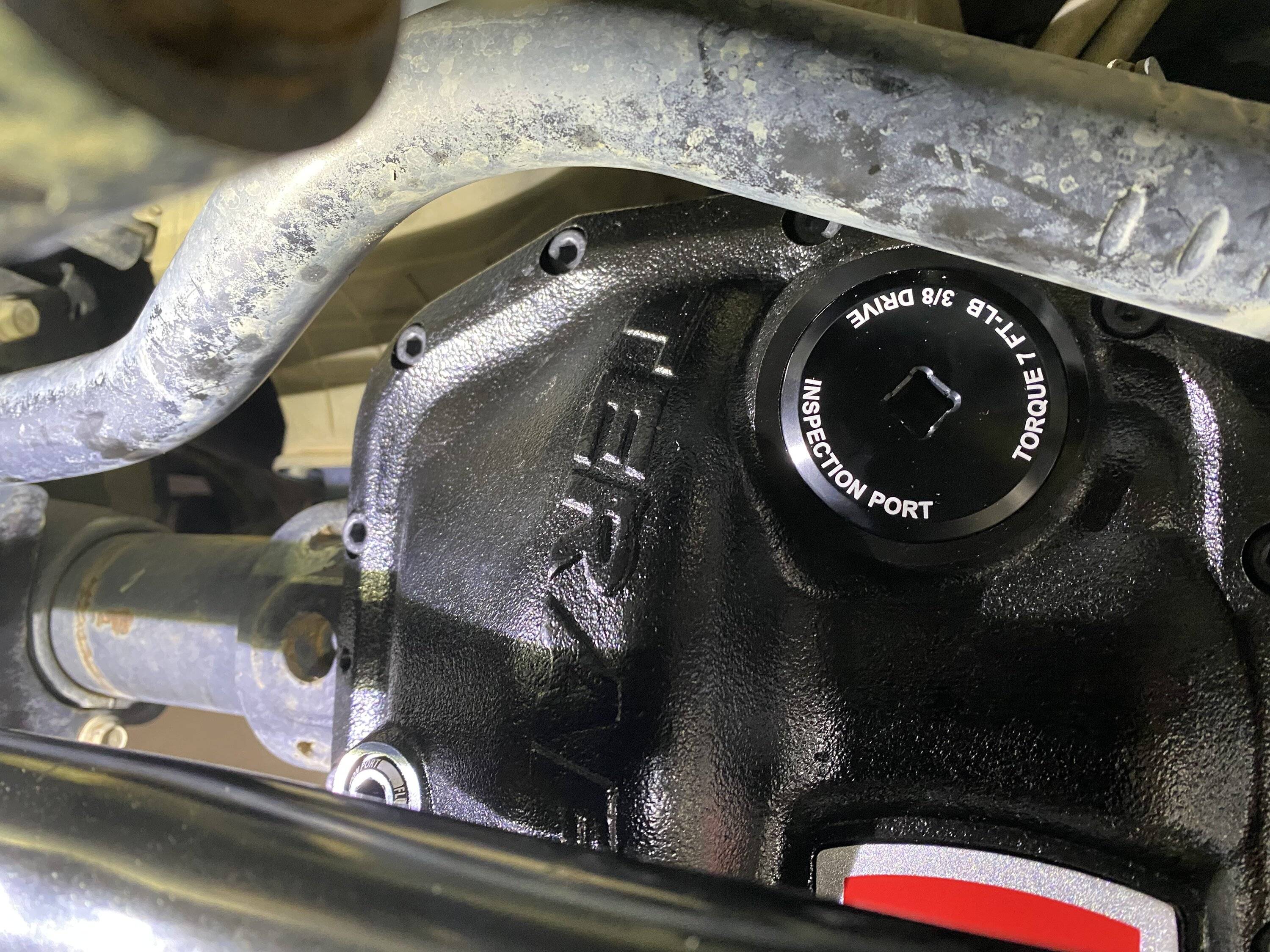

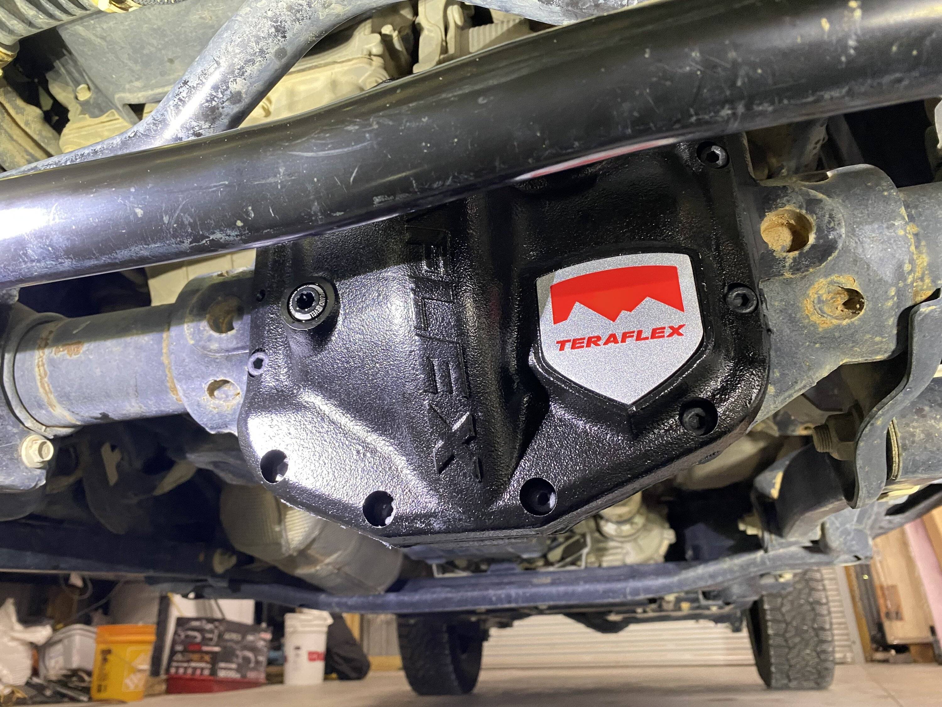

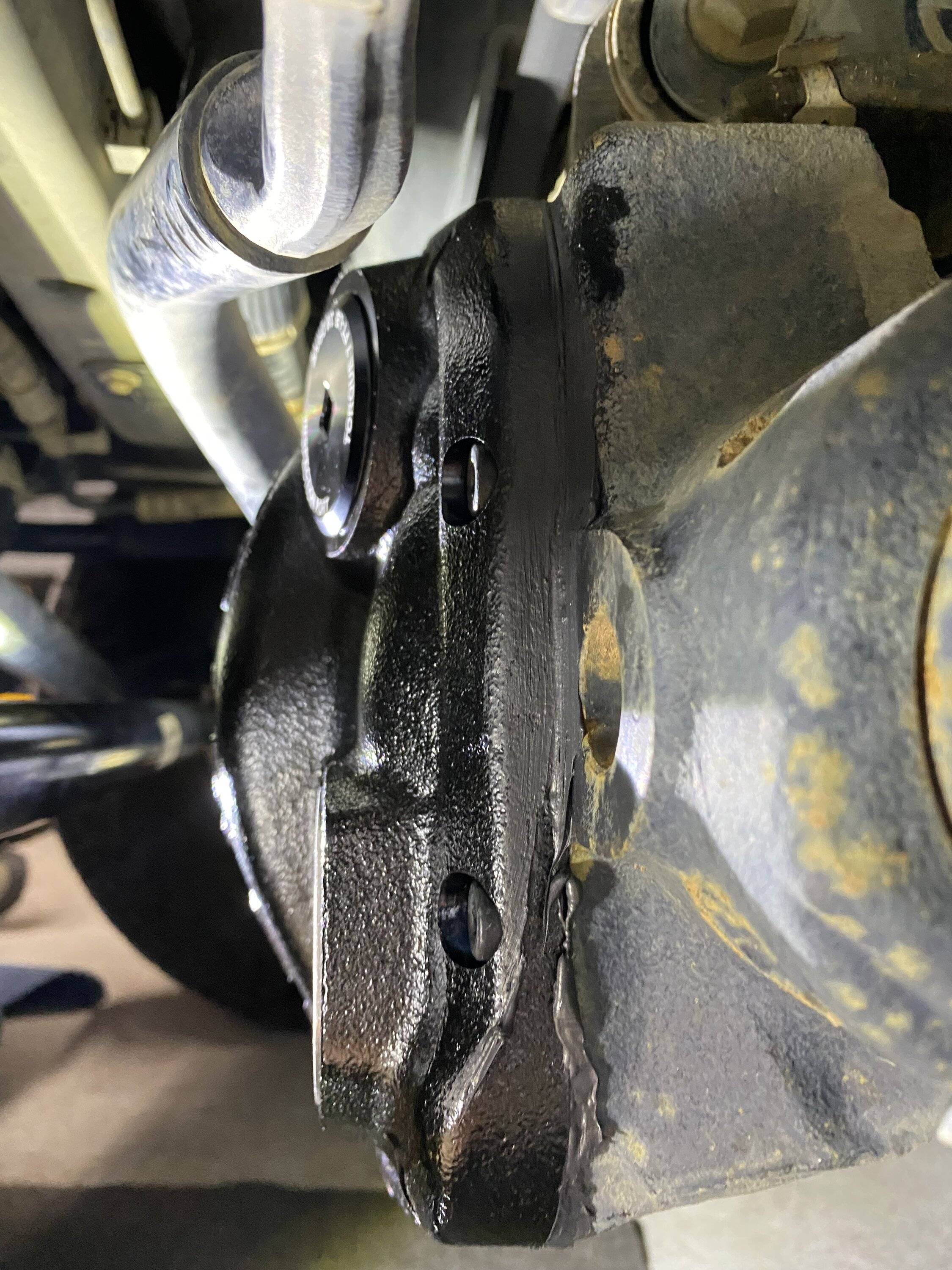

How about a picture of the installed cover?

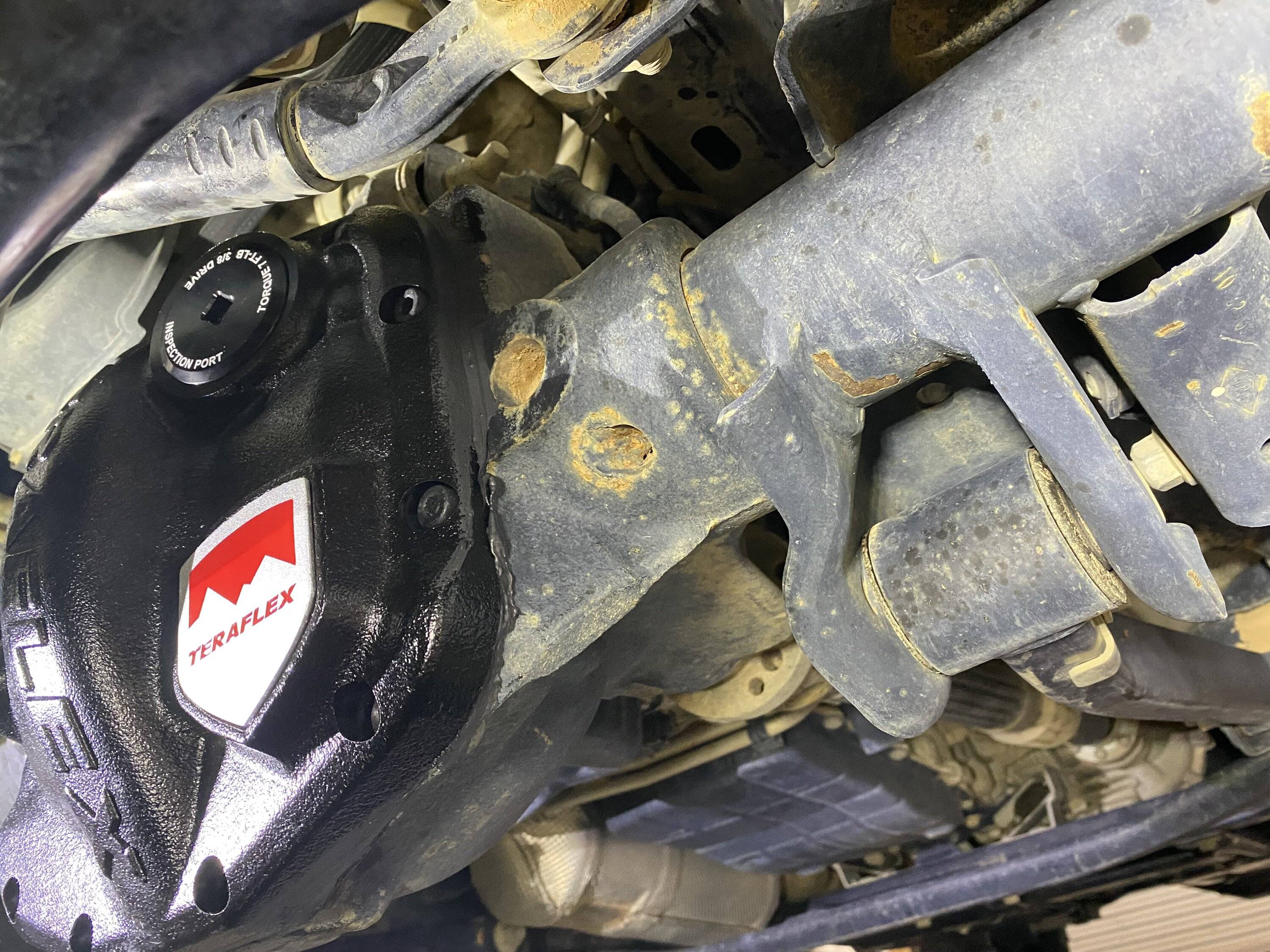

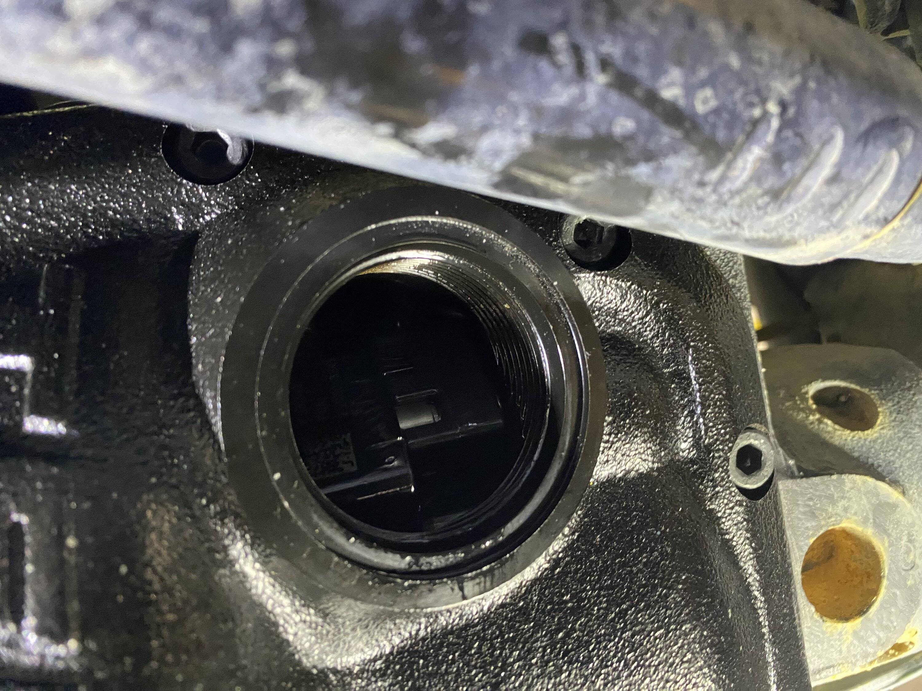

@Hootbro, do you remember your front axle locker protruding into view port? Granted, I was half asleep, but I again thought I was going to have to take it off and go back with stock. I managed to get the view port plug tightened up with no apparent contact. Then I spent an hour and a half looking for the lower plug. Thought I accidentally threw it away…project from hell.
Interesting how I can install a lift on a ‘89 CJ with 1 arm…other was in a sling strapped to my chest…with no issues, but something as simple as simple as a diff service…LMAO
Yeah, the locker is close in the top viewport but the inspection cover will fit. When I did my rear diff service last week and took the inspection cover off, there was nothing to indicated it made contact on the inside.
Forgot to add the photos…
Jeep Gladiator Diff Bolts IMG_1774
Jeep Gladiator Diff Bolts IMG_1773

That’s a nice cover. I like the large fill port/inspection hole.
250
40,611
54,304
Yeah, you aren't filling and trying to see how full it is through the same small hole, too often over-filling or at least making a mess - put some in, check, put more in, check again.........
Definitely a nice cover.

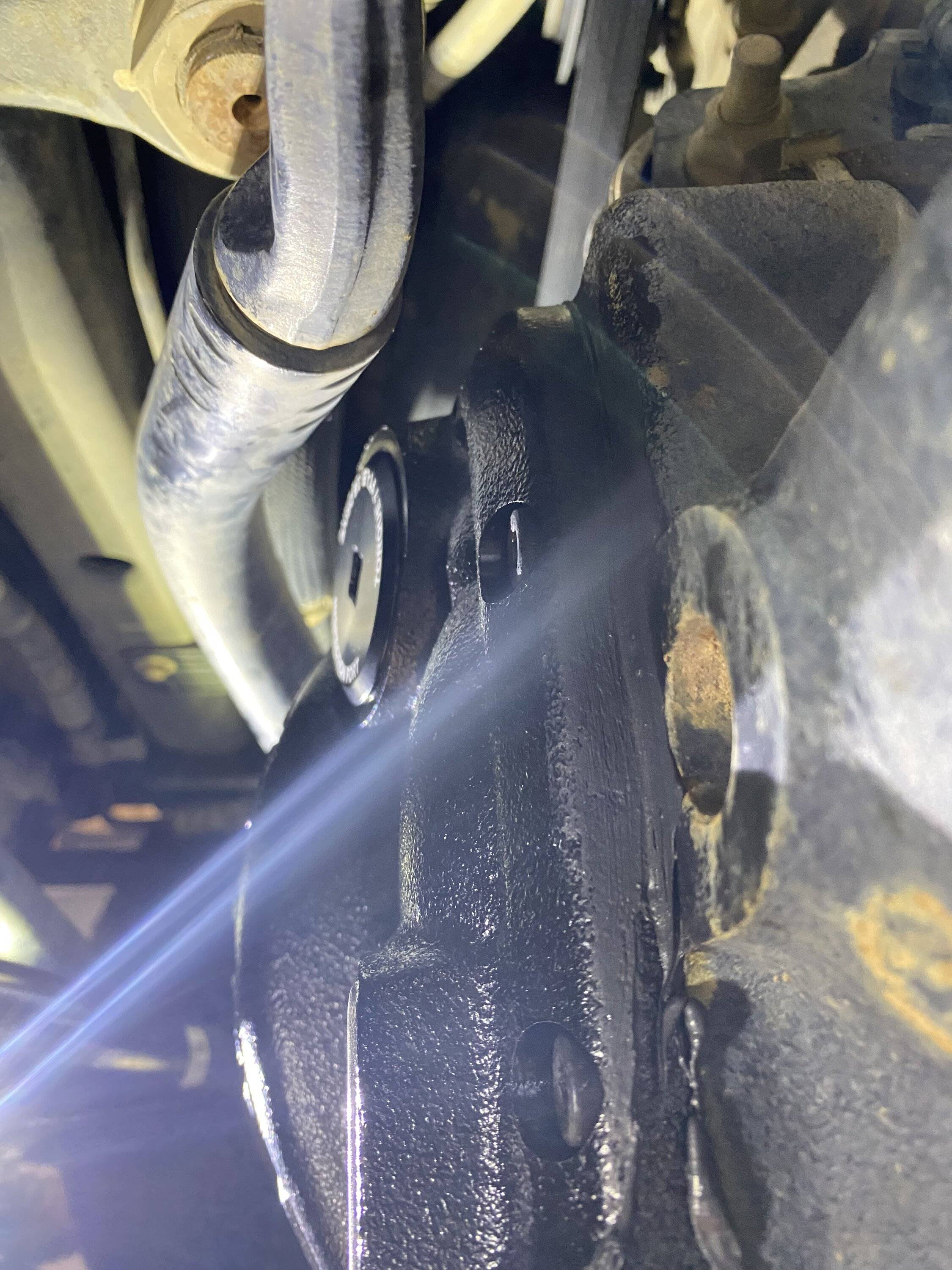

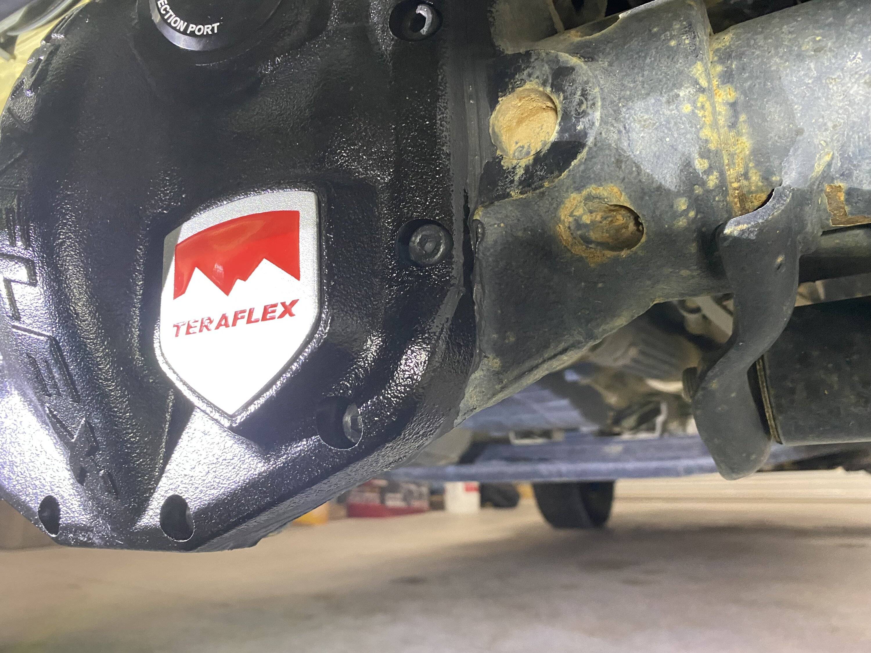

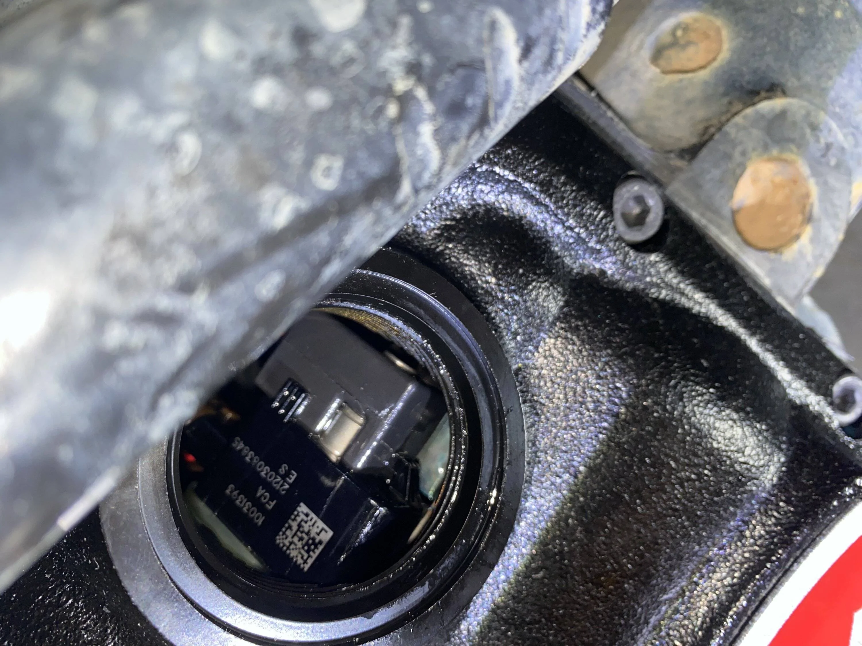

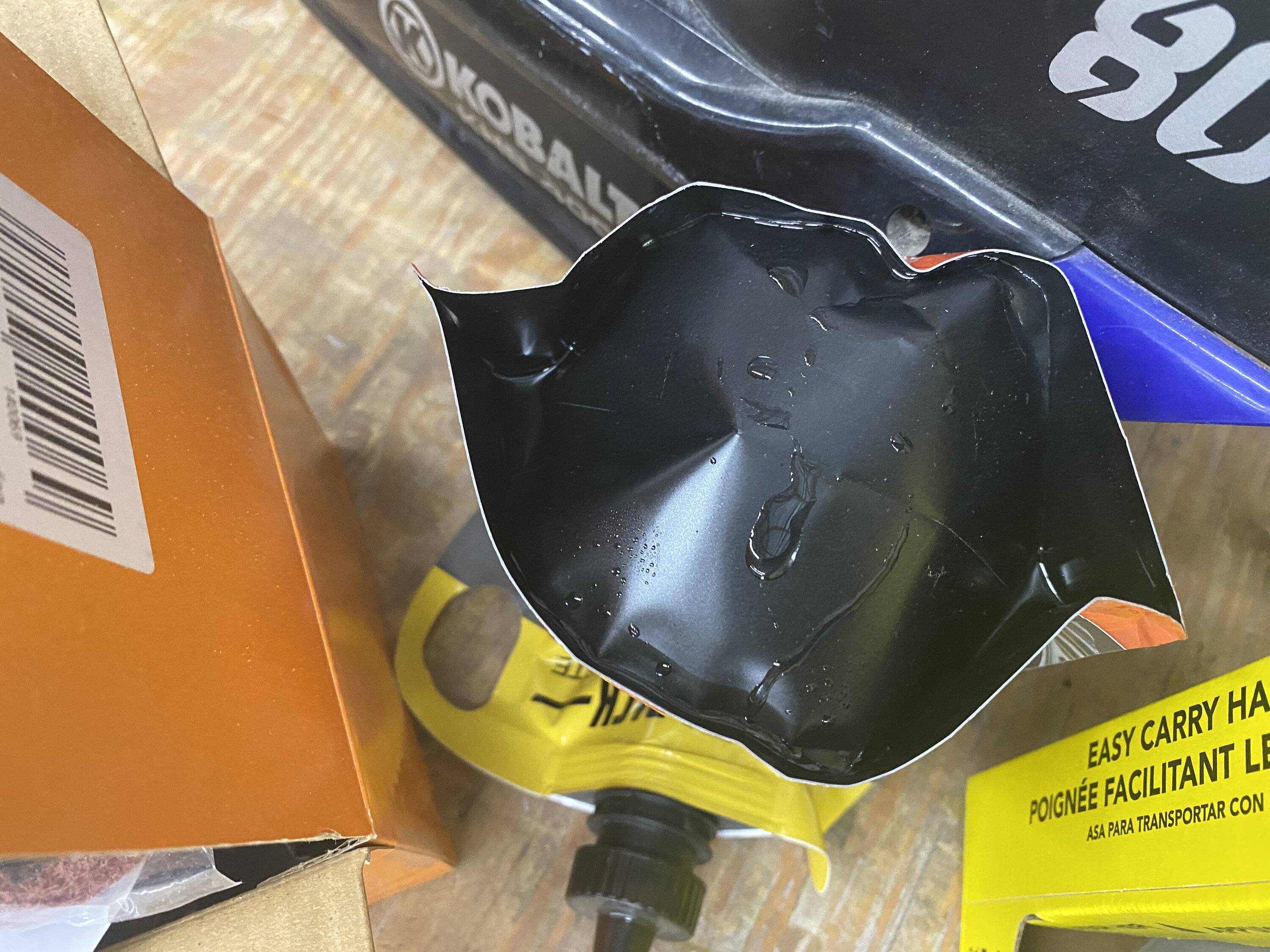

I'll say this, on the front cover, it's not much of an inspection port. The electronics box for the locker on Rubicon's protrudes into the port. It is how ever nice sticking one of the new flexible bags up there to fill through it. The best I can tell, the fluid volume seems about the same.
The down side to the bags...is that they're more fragile that they seem...
