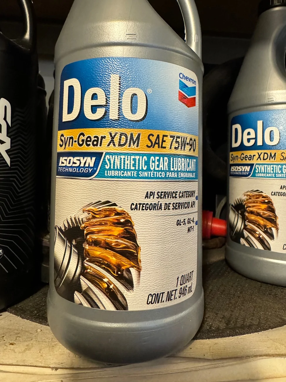

Torco RGO 85-140 all the way. It's a Dino oil used by Currie.

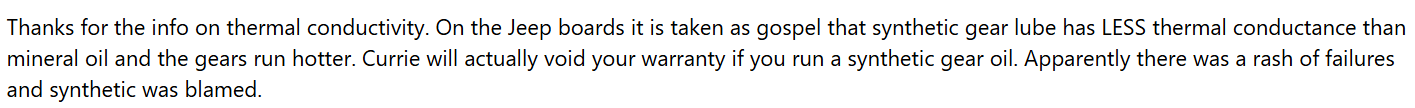

Just a note on full syn, it runs hotter than dyno.
Not modern synthetics. The film strength tends to keep the gear faces cooler thus the lube runs cooler.

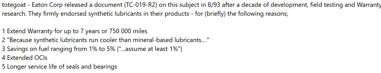

Digging deeper, even Currie was wrong.
Where are those image quotes from?
250
40,614
54,327
BITOG.
There is quite a discussion there and one guy threw in the math and science.
Seems some there take the actual measurements over repeated beliefs?

BITOG.
Thanks.
From what I read from Currie, they do not make the blanket claim that their recommendation of 85W-140 conventional will make the oil itself run cooler, just that it absorbs the gear surface heat and the gear surface will run cooler.
Currie also does not make the recommendation or infer it past just their axle and gear sets which they base most of it on the Ford 9" high offset gear for better shock loading protection which our DANA 44 Advantek are not high offset.

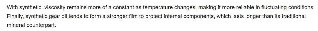

One place I found when digging into this a couple of years ago when people here were poo-pooing synthetics due to the heat suggested that places like that (Currie)are using old info, not current tests.
Jeep Gladiator Diff oil 1756910107052-a
Jeep Gladiator Diff oil 1756910208072-ei
If the film of synthetic fluid is better at reducing FRICTION, there will be less heat to deal with to begin with. People leave that part out - reduce friction, you reduce heat, regardless of the fluids ability to transfer heat. Prevent the metal-to-metal contact through film strength, no extra heat, no need to remove extra heat. Prevent it, don't deal with it after the fact.

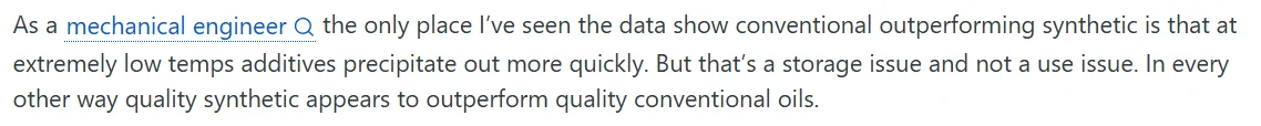

People keep loving to quote that Currie bit all over the place, even in engine discussions, but from my research, there's something fishy about their testing or results, or perhaps the very lube they were using was inferior (some say RP doesn't do nearly as good a job as Amsoil or other brands at preventing hot gears)
Odd how other makers say run synthetic, and the science supports it (less friction means less heat generated)

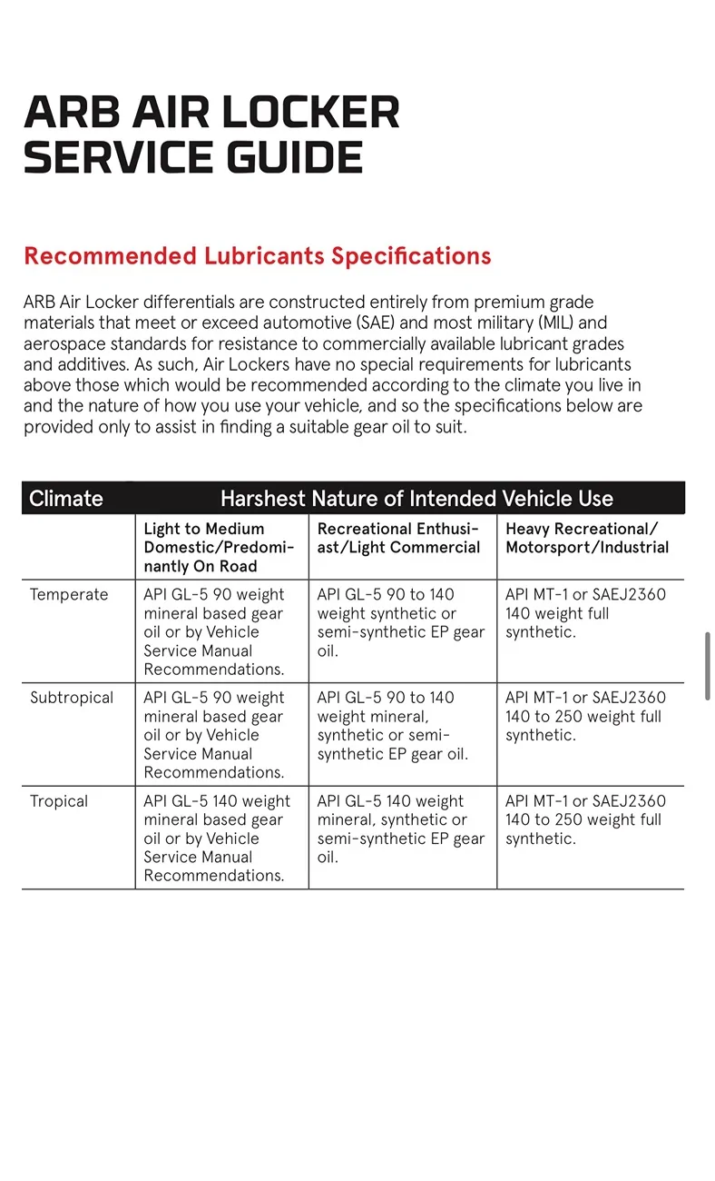

Interesting. I wonder what about the ARB lockers makes them recommend 75W140. It is usually the bearings & gears that dictate the recommended fluid.
TORQ lockers recommends 75W140 also ... as do all aftermarket gears kinda starting to wonder
