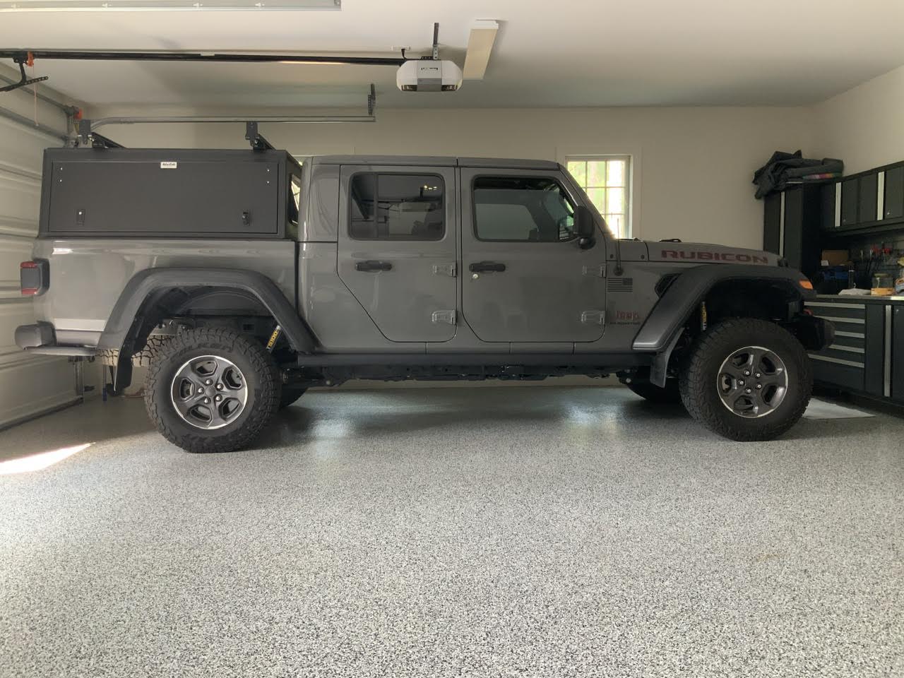

I debated long and hard as to which set of springs to get with my AEV lift. In the end I decided to get the standard heavier duty 2.5” set and so far am very happy with them.
My day to day driving includes an Alu-Cab canopy with a custom drawer set inside and a water tank which is usually empty. I also have a 17 gallon LRA auxiliary gas tank underneath which usually has fuel in it.
I bought the set up to be able to use my RTT and 270 degree awning although I haven’t used them yet but am sure that it will be able to handle the additional load.
The driving experience has been transformed compared to the stock Rubicon set up.
This is how it looks with the stock (and worn) 33” OEM tires on it…
Jeep Gladiator AEV High Capacity Springs with light load IMG_1275
