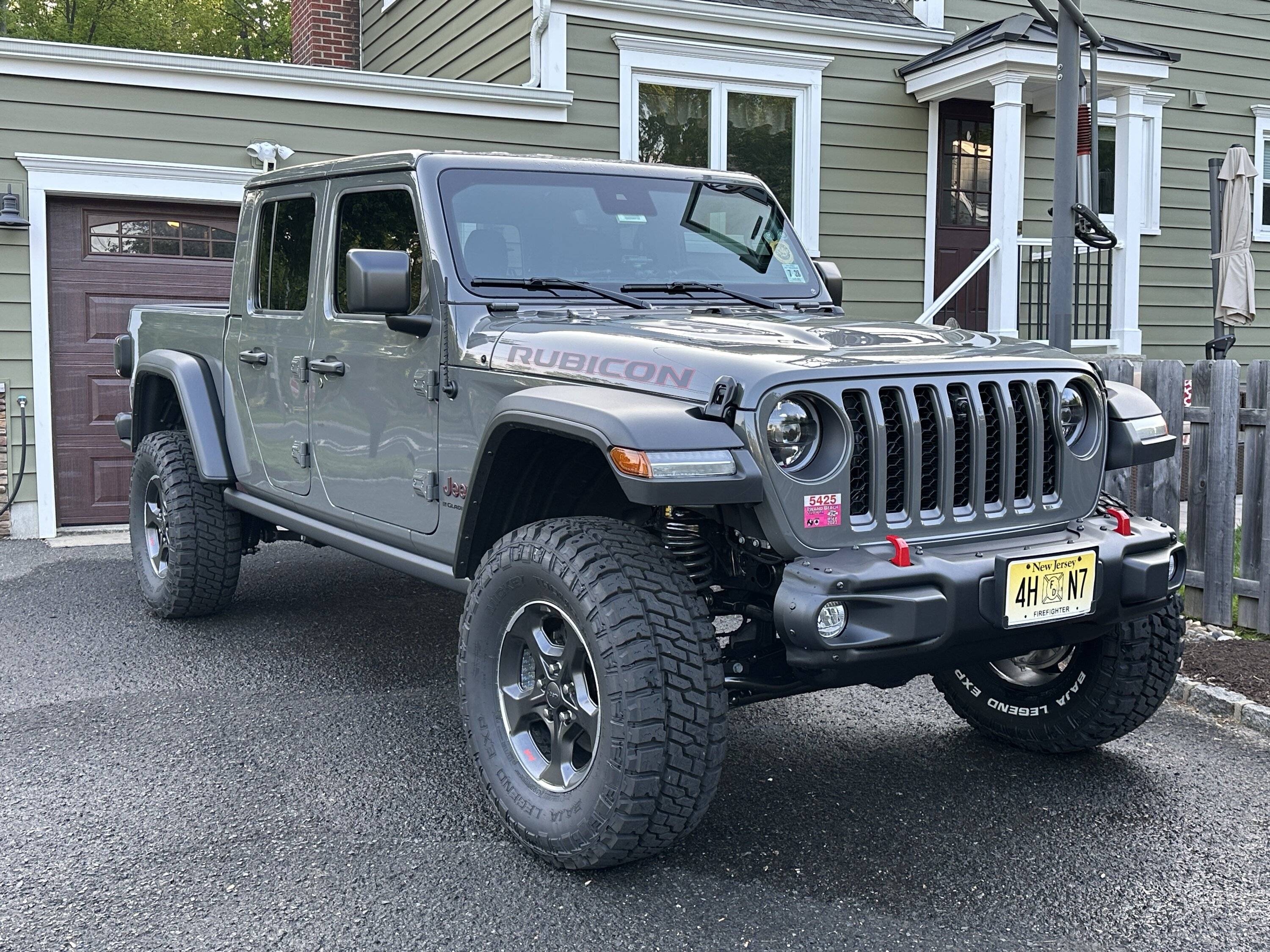

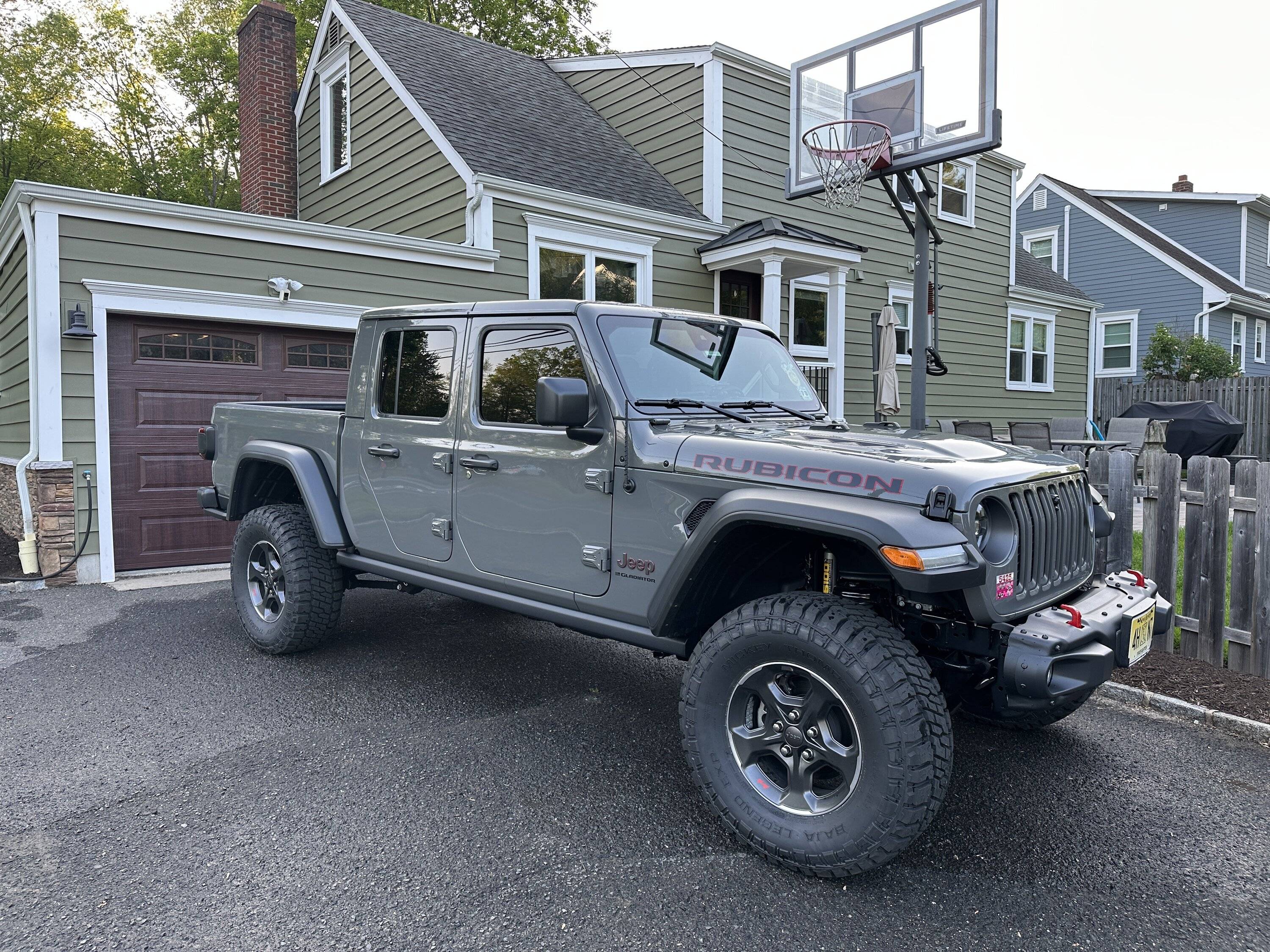

Quick update on my lift since there was some interest. I didn't take measurements all around yet, or pics for that matter. I'm giving it time to settle a little, but wow. If you didn't want too much lift, don't go this route (AEV 2.5" RT). I love it and think it rides great, but holy jacked batman.

your rig must be relatively unloaded then? I have had my AEV with the standard duty springs for a week now and loaded I not excessively high. did you torque the control arms with it on the ground?

Yup, everything done under load. You don't think it's high? Like I'm not tall at all anyway, but have to climb in. I knew this going in too though. I've heard others saying that you pick up much more than the 2.5" which I also believe AEV claims is the "loaded" height rating. I have the Smartcap on order and will be loading the rear so anticipating some drop there. Grateful I didn't do the HD though. Managed to grab a shot on approach last night at the train.

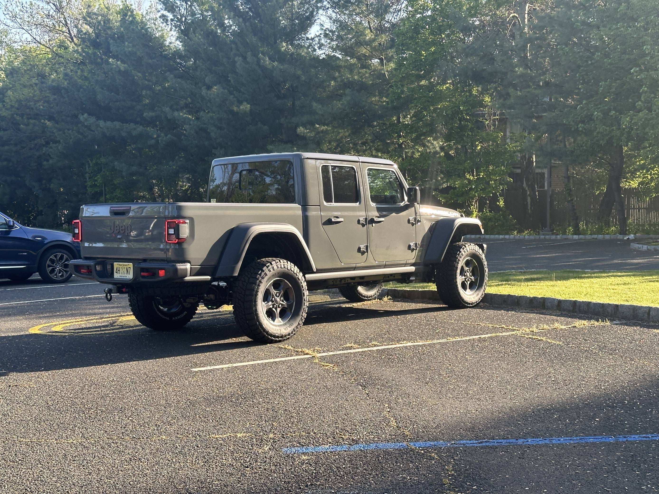

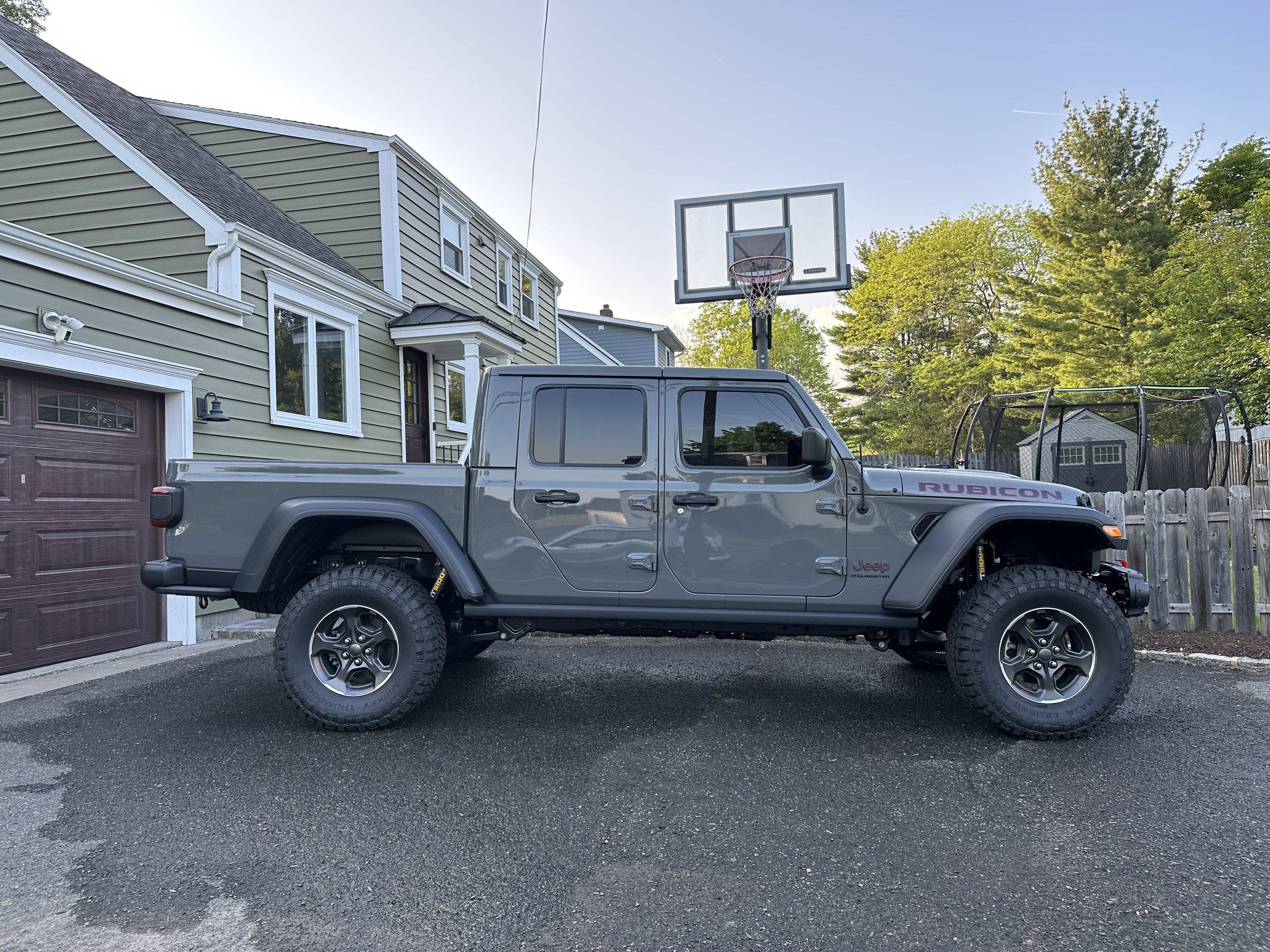

yeah see you are unloaded, so it does look high. I am also pretty short and did not want a super tall lift. I have posted about that in a few different threads after doing some extensive research on different lifts. AEV claims for the standard duty springs 2.5“ when fully loaded to that spring capacity. so being unloaded you are getting more than 2.5”. I myself am currently sitting a little under GVW, somewhere around 6,850 pounds, and have less lift than your picture shows. (Although I failed to take pre-lift measurements so cant give an exact number). As you load up it will not be as tall. It all depends on how much weight you have and if you have the SD or HD springs. At least its not like other lifts that advertise 3” and give you 4.5”. Thats a huge difference. I think AEV is more accurate to their claims than others.
if somebody out there has a unloaded stock off the lot rubicon with a hard top and willing to take measurements we could all compare and that would be pretty cool
pre lift bone stock and post lift loaded to a little under gvw
