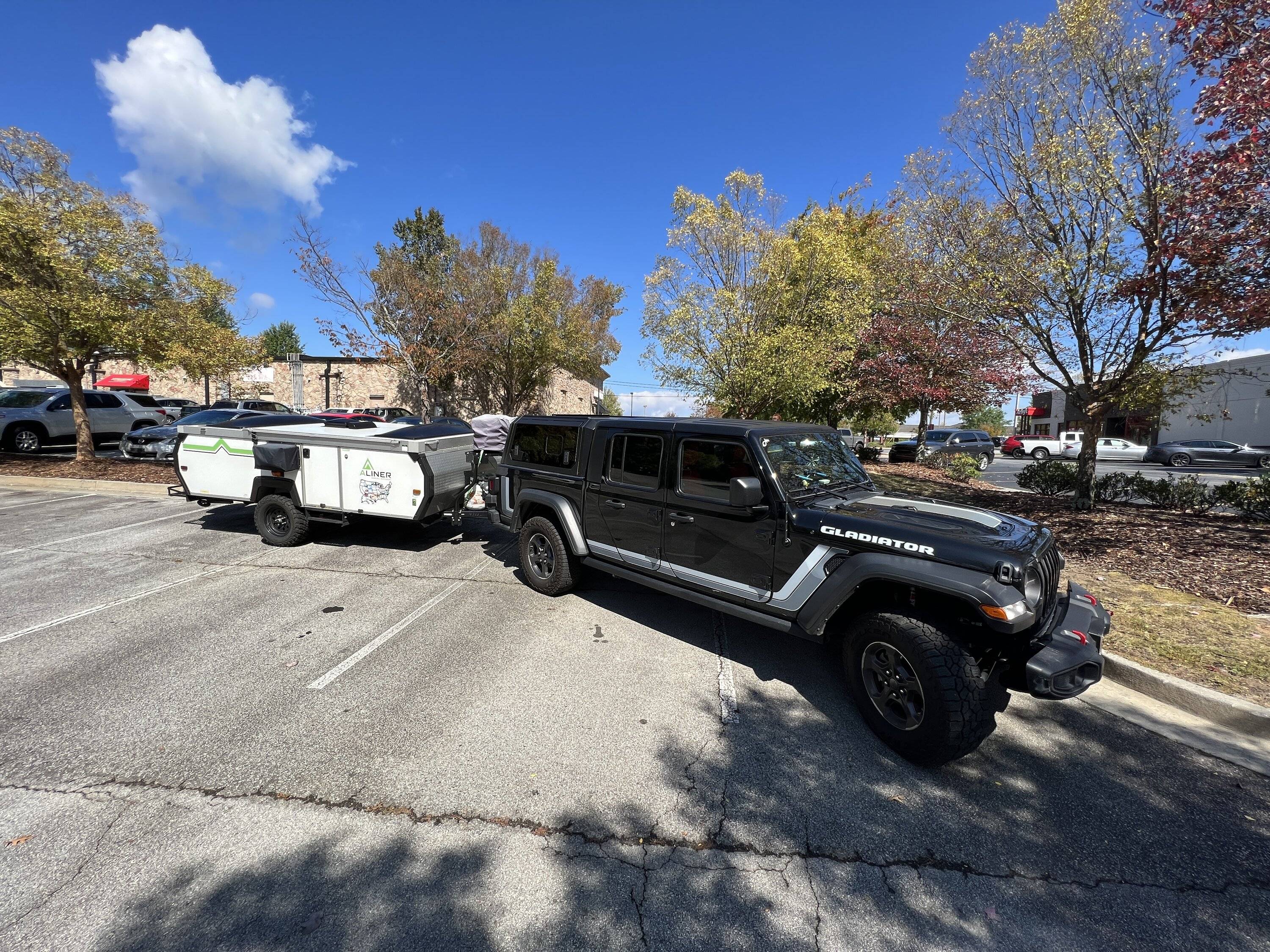

So I am not really "wanting" a lift for my 2022 Gladiator Rubicon, the current tire size is fine with me and I realize that puts me into the minority. What I am using my rig for is to pull my 2021 Aliner Scout camper (weighs approx 2000-2500 with generator installed, tool rack on back, etc) and looking at small sailboat (Catalina 22, 2500ish weight, 3000ish with trailer etc.)
I have added the RSI Smartcap [165 pounds] on the back, will add my starlink to the roof along with a couple of solar panels (and/or a hardshell roof top tent [250 pounds] with those on top of that) and I have installed the DECK system [200 pounds] in the bed.
So that is 600-700+ pounds of Decked / Topper / Camper/ misc tools and stuff plus say 300 or so on the tongue. I would say budget I have put 1000 pounds on the rear out of my 1200ish payload.
Upfront, will be removing the OEM plastic bumper and replacing with aftermarket steel bumper with winch. [Call it an extra 100-150 pounds up front]
I am seeing "heavy duty" springs as part of the various lifts, AEV, etc. The one that looks the most interesting is Clayton 1.5" Ride Right. Does anyone have other suggestions for near stock but built to handle the extra weight from towing and this gear?
It looks like I have used up my 1200 pounds of payload (1164) before I get in the truck, my wife, and nephew. I realize lots of others exceed payload on a regular basis.
After reading a bit more I am now leaning towards the Timbren Suspension Enhancement System (instead of airbags) to help with any sag when the trailers are being towed.

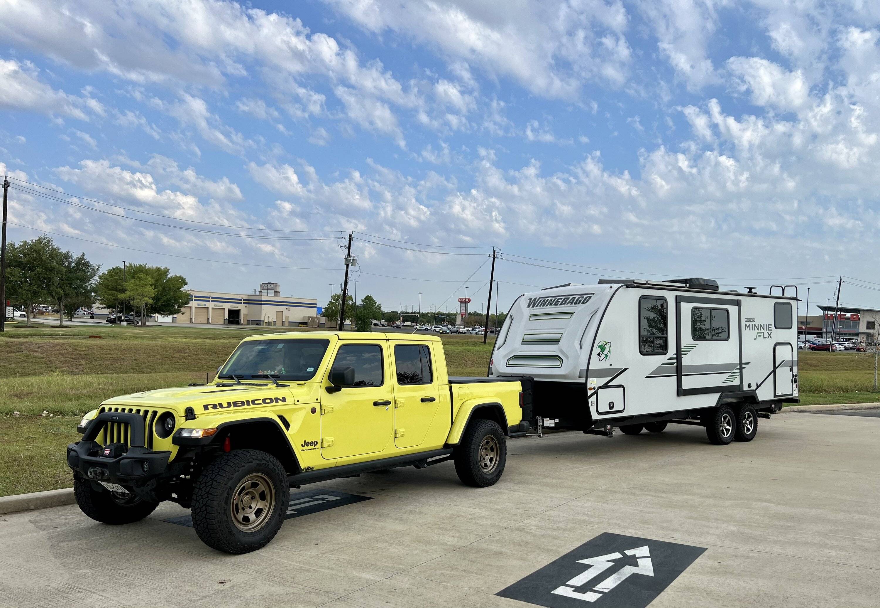

I use air-lift bags just to help out on my Rubicon and tow 5000# camper it does really well factory springs, and 1.5” spacer in front for winch and bumper weight.
