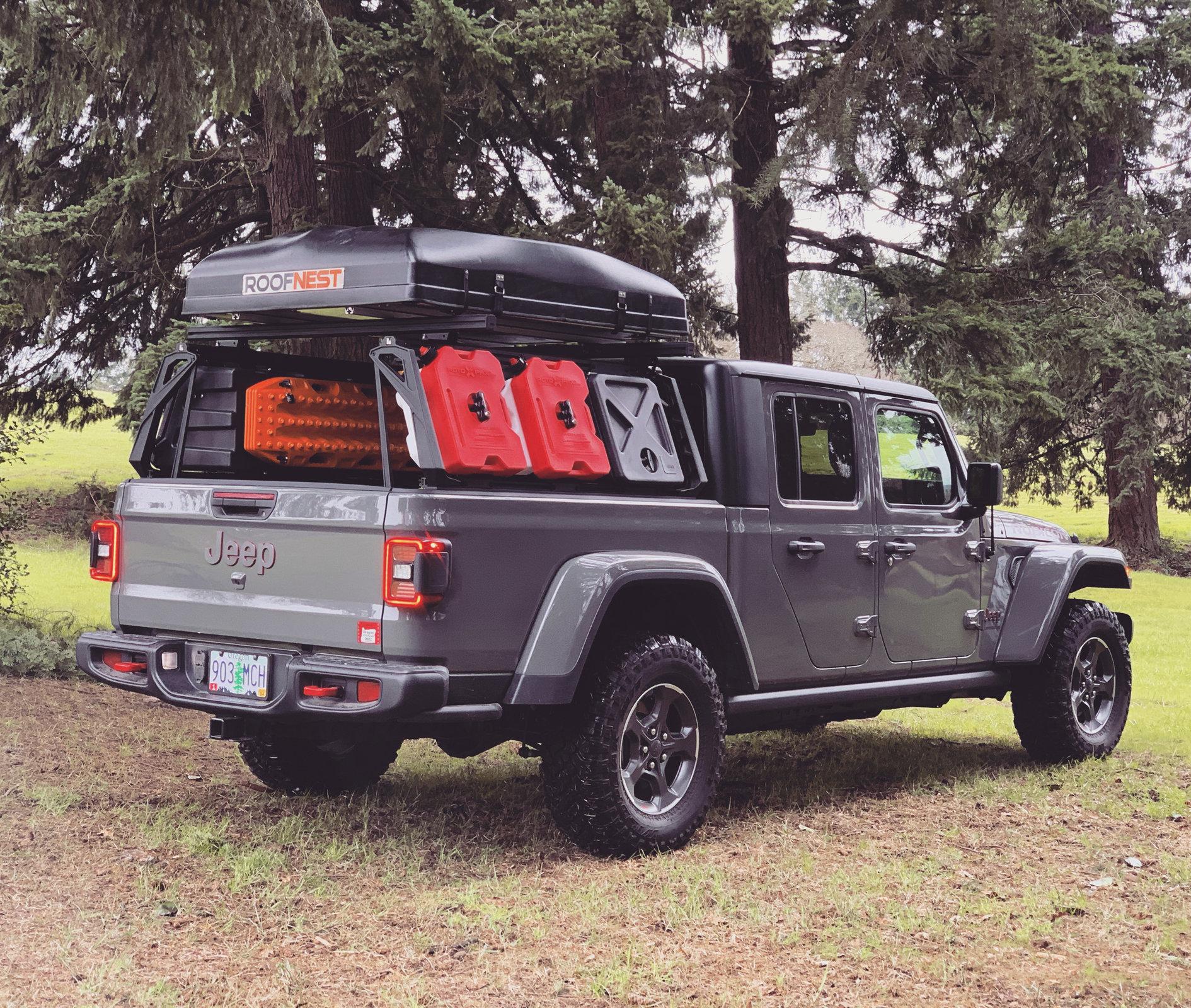

Thought I'd update you guys. A couple months ago I stepped up to the Clayton 2.5" springs and Falcon 3.3 shocks. It's finally a set up that can handle all the weight I am running with on the truck during my expeditions. I recently weighed it and I am tipping 7,200 pounds. It's a big boy!

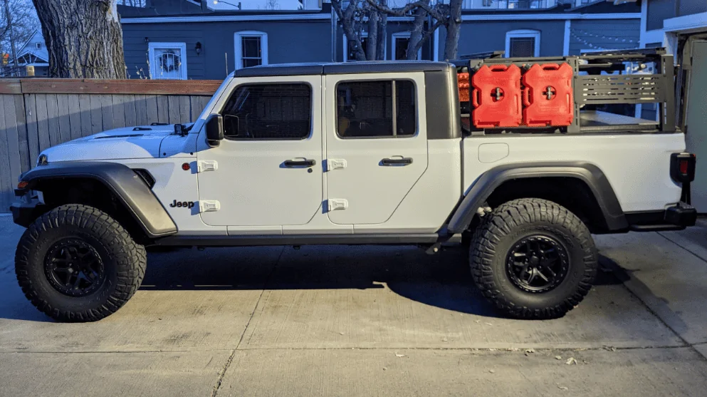

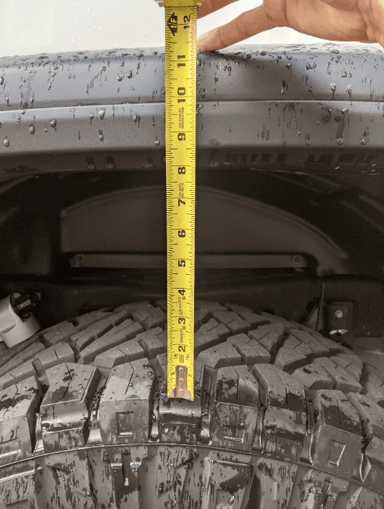

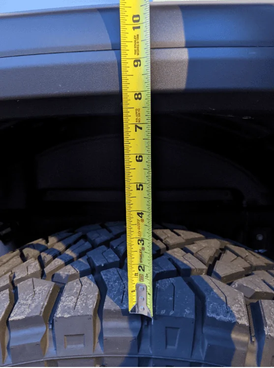

After removing 260lb listed above... (approx 1/2" rake F-->R; measured 21.5" at OEM rock rails at front and 22.0" at rear to ground)
I hope this helps people with their own constant load and spring decisions.
Thanks for the update John. That's definitely helpful.

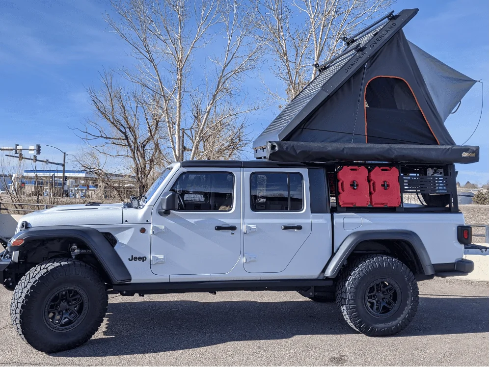

Any idea how much weight you have in the bed in the photo above? I have a 360lb camper on my truck, and I'm still planning out the rest of my setup. I'm leaning towards the 2.5" springs in front and 3.5" in the rear like you have. I like the stance of your truck in the picture above, and that it would have additional weight capacity before sagging in the rear.
Using your numbers above, that would give me around 3" lift in front, and 3 1/4" in the rear (with the 360lb constant load), so unloaded my truck would have 1/4" more rake than stock.
Hey there,
I'd say there's roughly 425lb in the picture. I think the Rebel Off Road Rack invoice from FedEx back in the day said 300lb with all the pieces. I also have the (2) RotoPax (30lb), Shower Box (25lb) and 63QT ARB Fridge (75lb) in that pic. I'd say anything over 350lb constant load your going to want the 3.5" rear springs to maintain at least a 1/2" rake.
