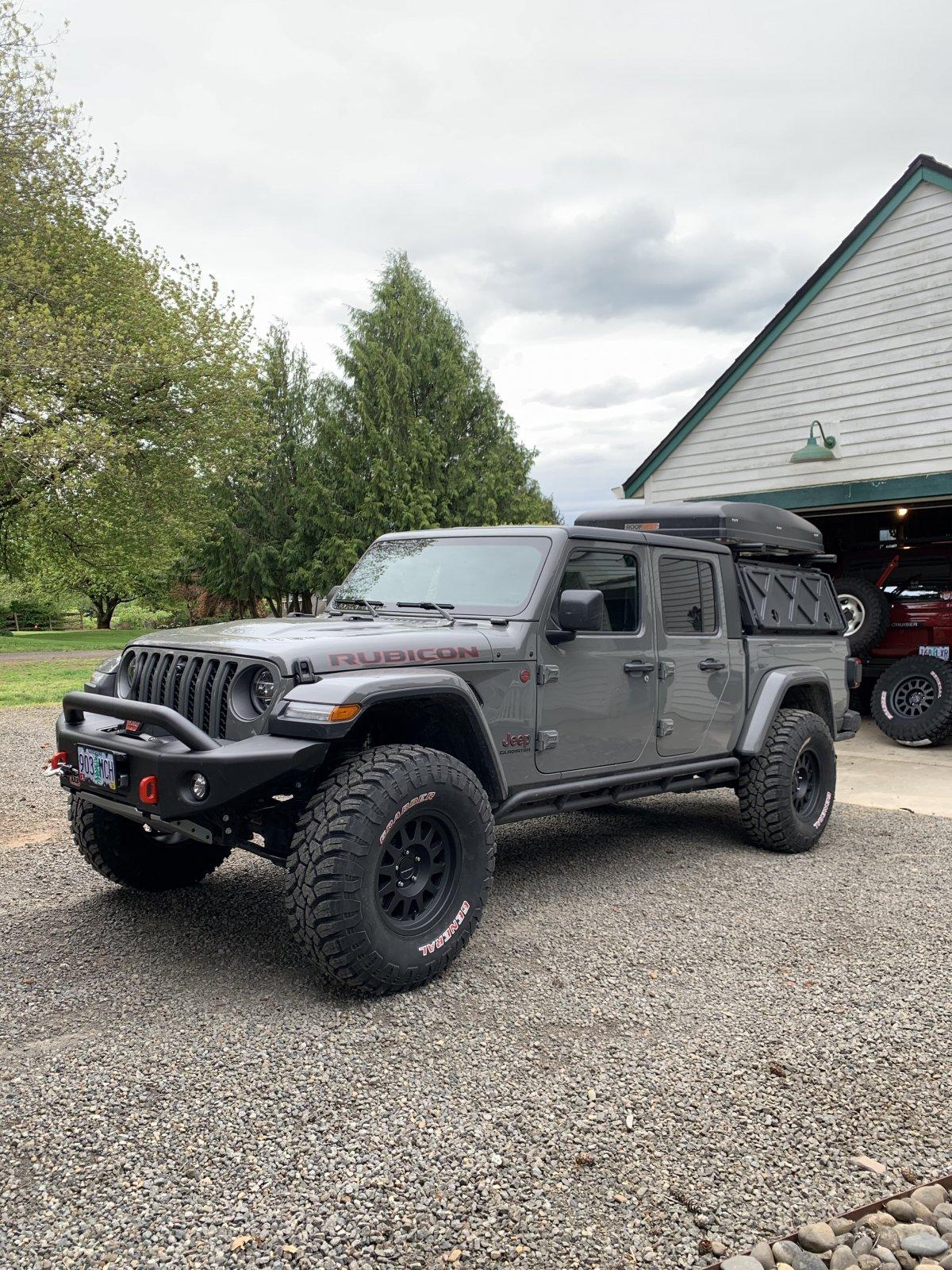

So after talking to a bunch of guys running 37s with lifts, I went with the MOPAR 2" lift. The rear shocks are still a bit soft under load. So I am going to swap out the FOX shocks from the lift kit with some Teraflex Falcon adjustable shocks. And I am going to add 0.75" spacers to the rear springs. I think with that set up, I should be right where I want it to be.
Here's the truck now — I upgraded to 37s.
Jeep Gladiator Affordable Lift For Constant Heavy Load Overland Rigs? IMG_5902
Very nice! Are you happy with the ride quality as well?

Yeah, the valving in the kit shocks are better than the stock FOX shocks. However, they're still a little too squishy. Otherwise, I have been really impressed with the kit. But that's not too surprising, since it was developed by the Jeep team.

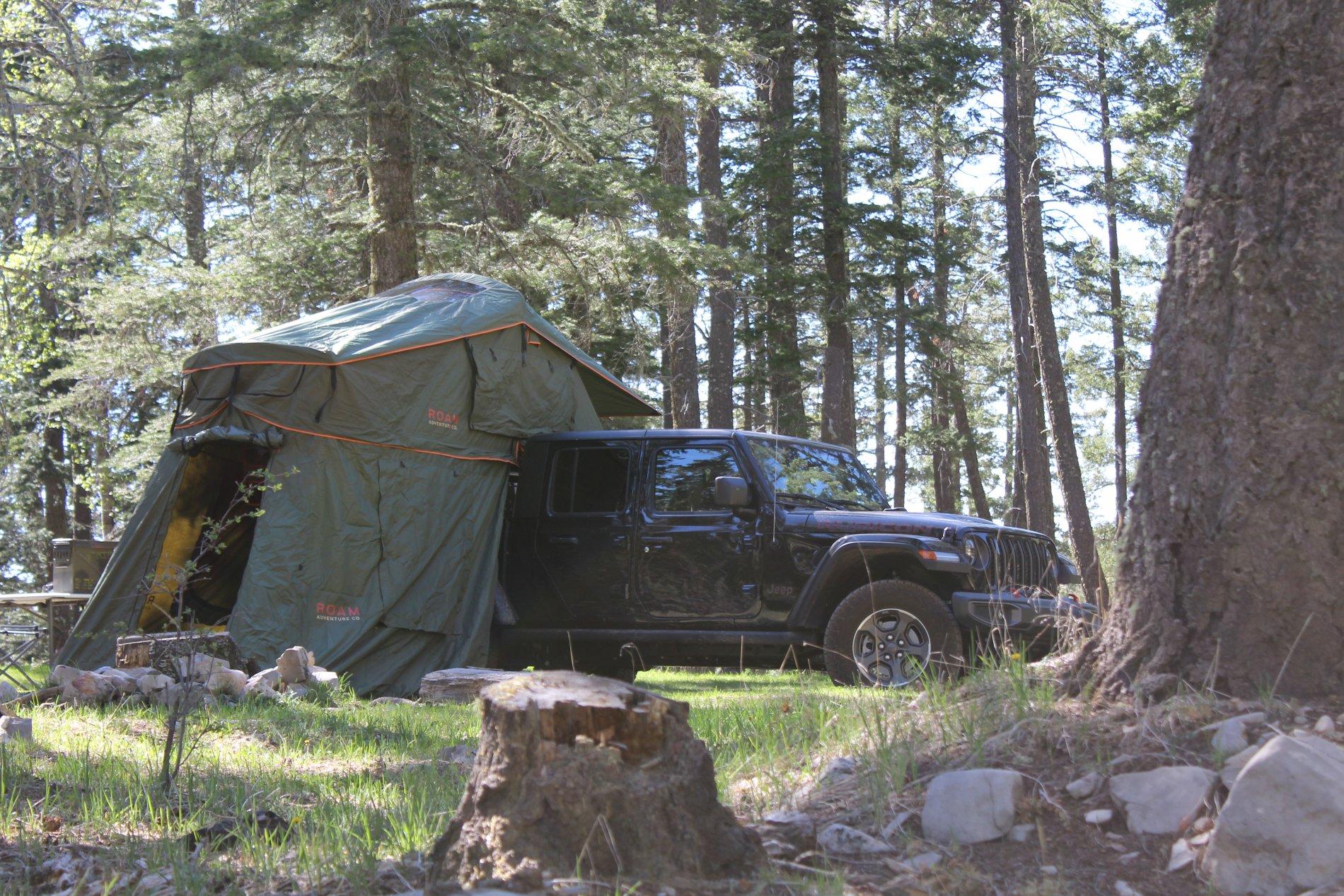

I'm in this exact predicament right now. I run a bed rack w/ Roam RTT and a bed full of gear for overland trips. I can't decide on a lift (2'' vs 3.5"). Your rig looks really good with that setup, are you pleased with it? Is there anything you wish you did different? Did you measure the actual lift you got from the 2" kit? My biggest concern is if I lift too high, the Roam annex may not sit flush/on the ground. I appreciate any input, cheers.

I didn't measure it, I'm sorry. Like I said before, I am upgrading the MOPAR 2" FOX shocks to the TerraFlex Falcons. I haven't swapped them out yet, though.

Just to close this out, I went with the MOPAR 2" lift. Then I swapped out the shocks for Teraflex Falcons at all four corners. And I installed 0.75" spring spacers under the rear springs. Rides like stock again, as if the weight weren't there!
