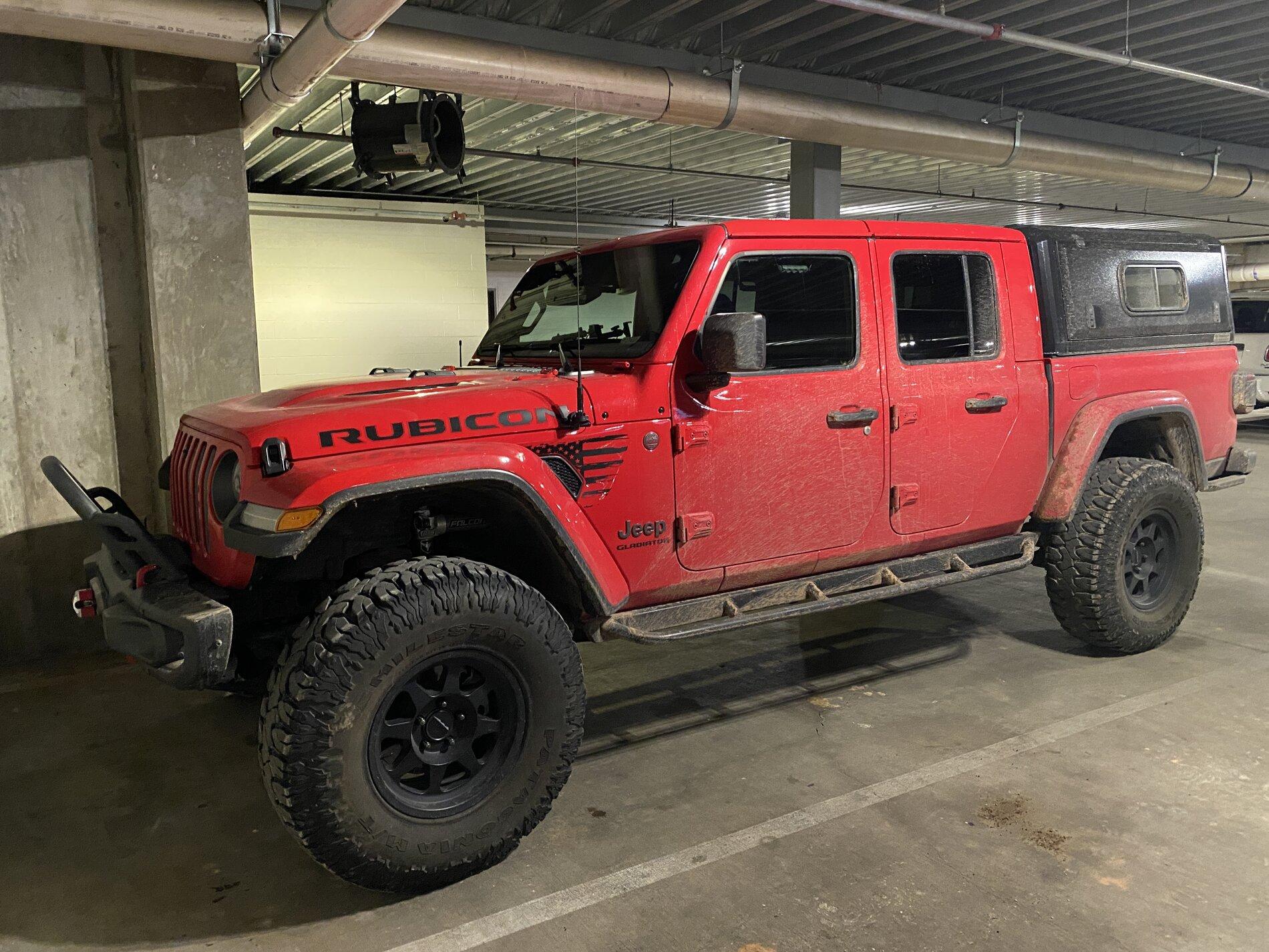

I have a ton of overlanding equipment that I permanently run in/over my bed. I also have an ARB front bumper and WARN ZEON winch up front.
With the extra weight, I have found that the Fox shocks on my Gladiator Rubicon are entirely overwhelmed by the constant load. My ride is so springy now, it's as if I have no shocks at all. Essentially, the stock Fox shocks are valved WAY too soft for my needs.
So, I am looking for an upgrade. And, if I am going to replace shocks, I might as well lift it a bit, so I can stuff some 37s underneath it. I overland as well as take the rig wheeling. But getting it feeling more stable is my primary concern.
But, of course, since the world is going into a recession, I don't want to spring for a $2500+ kit. I was hoping to find some heavy-load shocks some new springs, or maybe even some spacers on a budget (at least for the time being).
I found the cheap-as-hell $499 Rough Country kits: https://www.roughcountry.com/jeep-suspension-lift-kit-63730.html
I also stumbled upon the $1,000 Rancho kit: https://www.gorancho.com/products/s.../x-lander-rs3-suspension-system-rs66128b.html (but can't find Rancho shocks to match)
Then there's the $599 Teraflex kit (would need to add $800 in shocks to complete the kit): https://teraflex.com/shop_items/jt-3-5-coil-spring-base-lift-kit-no-shock-absorbers?vehicle=JT
I like that the Rancho is listed as an overlander kit, for heavy loads. But I don't know what shocks I'd run with it. I like the price of the Rough Country kit, but it feels a bit silly putting a $500 lift on a $47,000 truck.
I'd love your thoughts. I've added pics of my truck below, as example of what I'm running.
Thanks!
