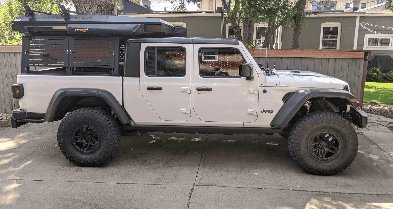

Clayton 2.5"f/3.5"r spring combo:
Jeep Gladiator Clayton vs Synergy - coil spring review with 600lb constant load overland build 1645823173929

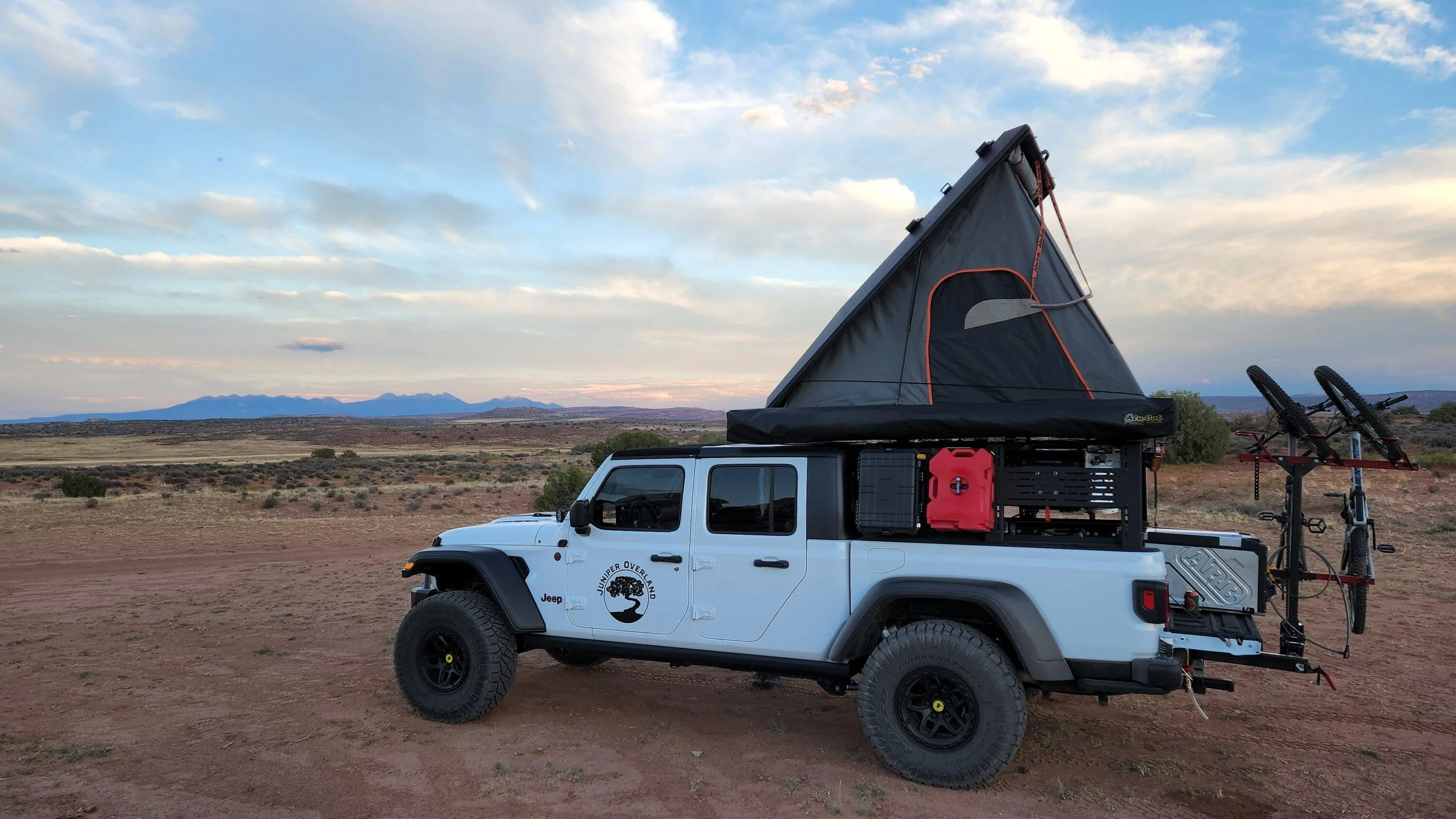

First and foremost, I love the Synergy springs. They provide the softness and compliance I was looking for after switching from the Claytons. As I reminder I have a full set of 3" Synergy Springs front and rear with the addition of 3/4" Daystar spacers in the rear too. I've slacked on getting pictures uploaded of a full loaded rig but when I'm in full camp/MTB mode the truck sits level. (see photo below)
