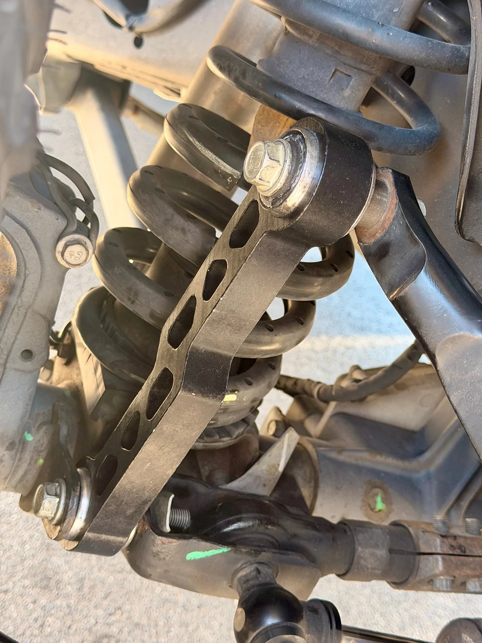

After many years of Snap Crackle & Pop in my steering and suspension...

... I finally tracked it down to the front swaybar links. Replaced them with SteerSmarts Yeti XD links
Oddly enough I diagnosed the problem from watching this guy working on his Honda
Jeep Gladiator After many years of Snap Crackle & Pop in my steering and suspension... IMG_4277

So I was having similar noises on mine. I was tired of the end link hardware with the damn Allen keys. And the bolt seized up so I had to saw zaw it off. That was after many attempts with soaking pb blaster and heating the bolt up. After I finally got it off I went to install the yeti end links this morning. Well it seems the bushing is too wide for that bottom mount in your pic. Did you have the same issue as me? Did yours slide right in?

Well nvm, was able to grab a pry bar from my neighbor and got it in! I don’t think it’s placebo, but it feels way more stable now! And the noise is def gone.
