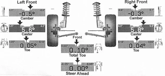

Finally, because someone will ask, what alignment specs are you at for caster and toe? I personally run 6 degree caster and 1/16" toe in on 37s and this has always treated me well.

Yes, check the Caster. I am running 6.5 - 6.8 deg. of caster and it is a great ride. Note: I have an Adams front drive shaft.

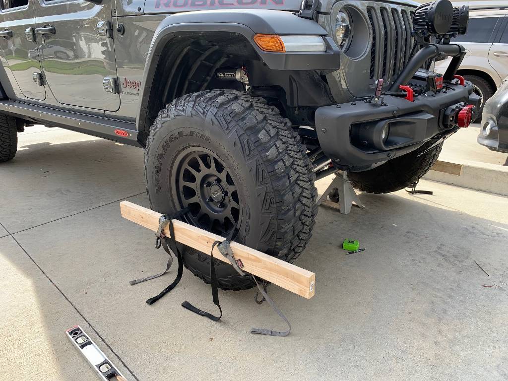

Also, it Might be too much toe in. Try going to zero toe in. Here is an easy way to measure with 2 straight 4x4s, 2 straps, 2 jack stands, level, & tape measure. Use a paint pen to mark the degrees on the RPM Tie rod, so, you can go back and forth to get the best toe in for your ride.
