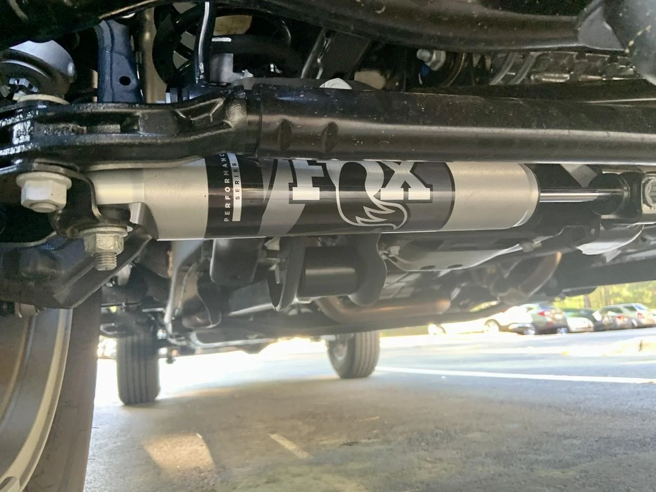

whats the install like on these? do you need a "kit" or does it just bolt in stock? seems like a worthwhile upgrade for a few hundred bucks
NC_Overland
Feb 21, 2020
3,402
4,187
Raleigh, NC
2020 JT Overland
It’s just two bolts. I did it in my driveway in like five minutes. It only goes on one way. Like this.
