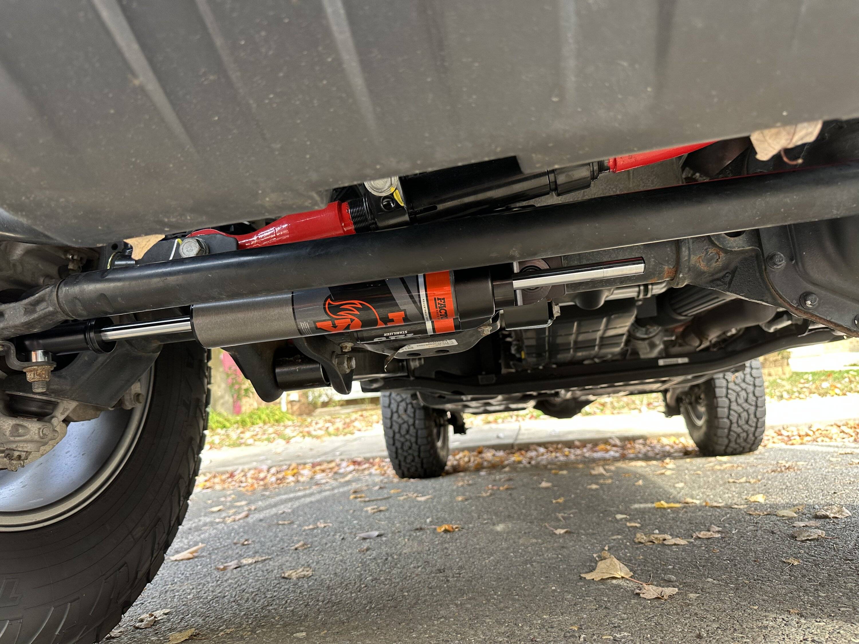

it was a pretty straight forward install. Nothing most people couldn’t do on their own.

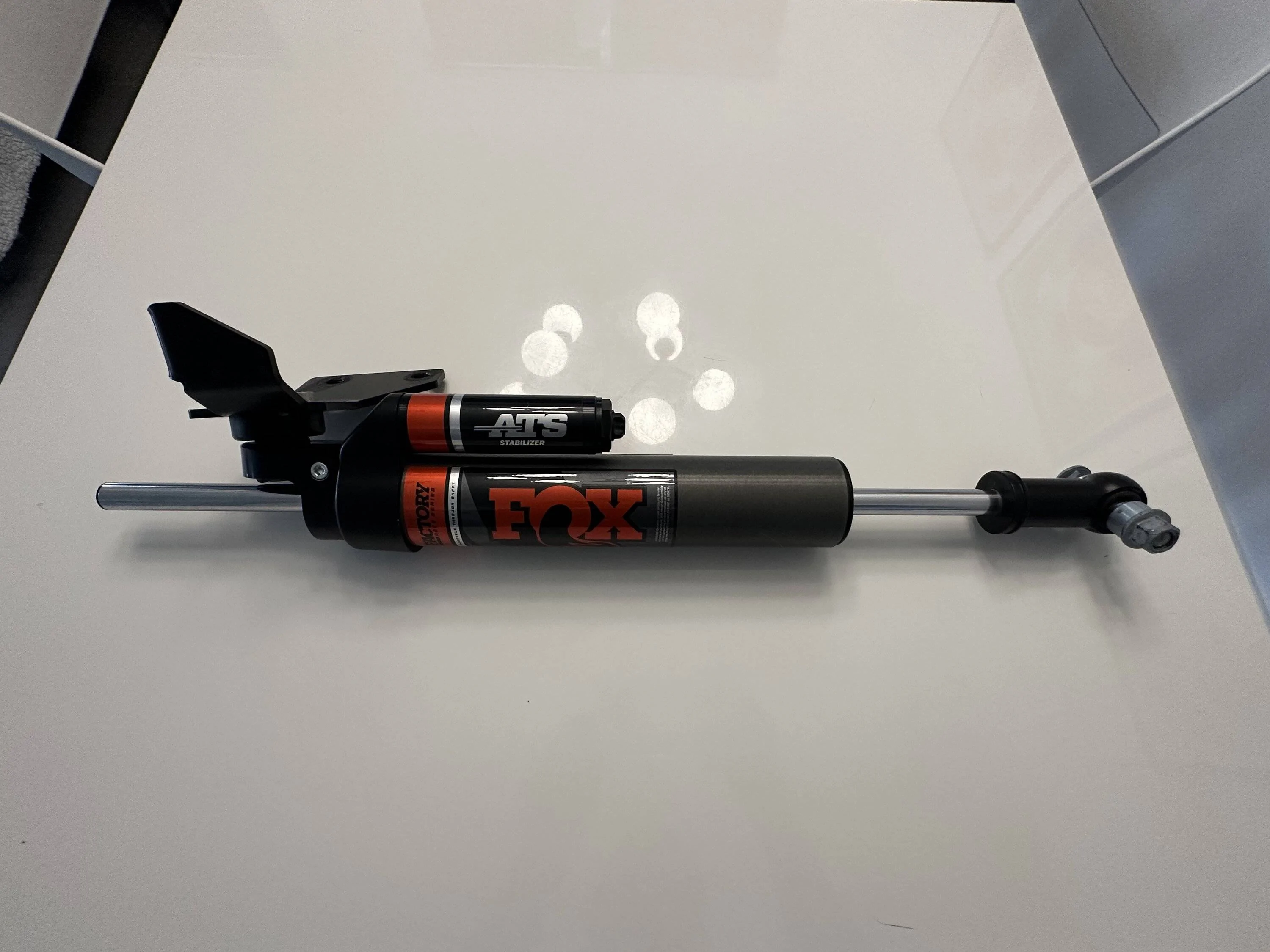

I am selling mine that has only 2000 miles on it. My Mojave got rear ended and totaled.
Jeep Gladiator Fox ATS Steering Stabilizer Install Question IMG_8659
