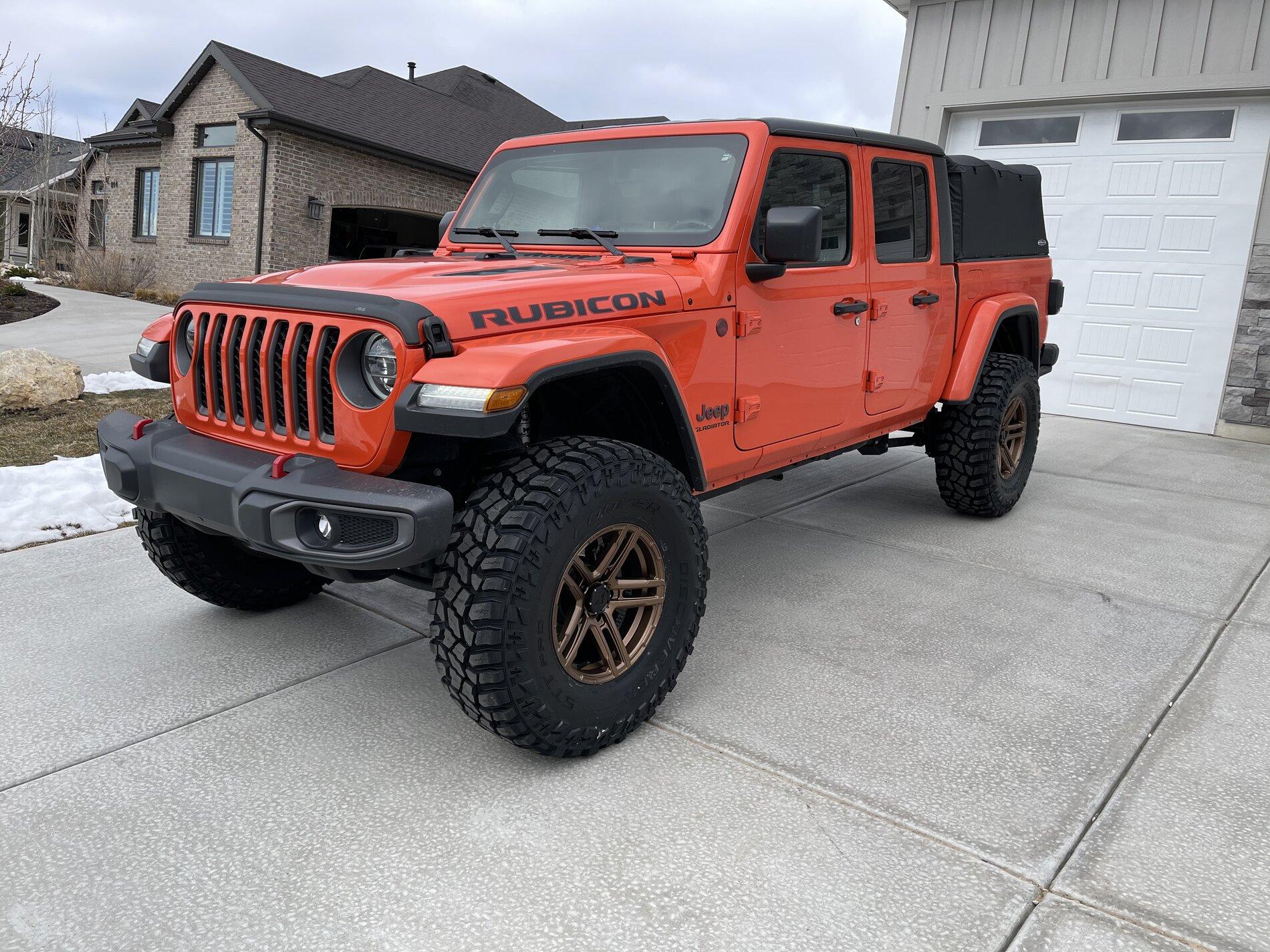

I was moments away from heading back to the tire shop and trying to swap out the STT Pro’s for some AT type tire. As a last ditch effort to keep running the Coopers I decided to go ahead and put an adjustable track bar on the JT even though the Jeep customer service folks ensured me I didn’t need to with the Mopar lift. I ended up pushing the axle over to the passenger side a little over quarter of an inch. Wow, what a difference it has made. I can now go down the road without fighting the steering wheel. These 37’s still wonder a little more with the pitch of the road than do the stock 33’s but I will chock that up to the cost of running more aggressive tires.
