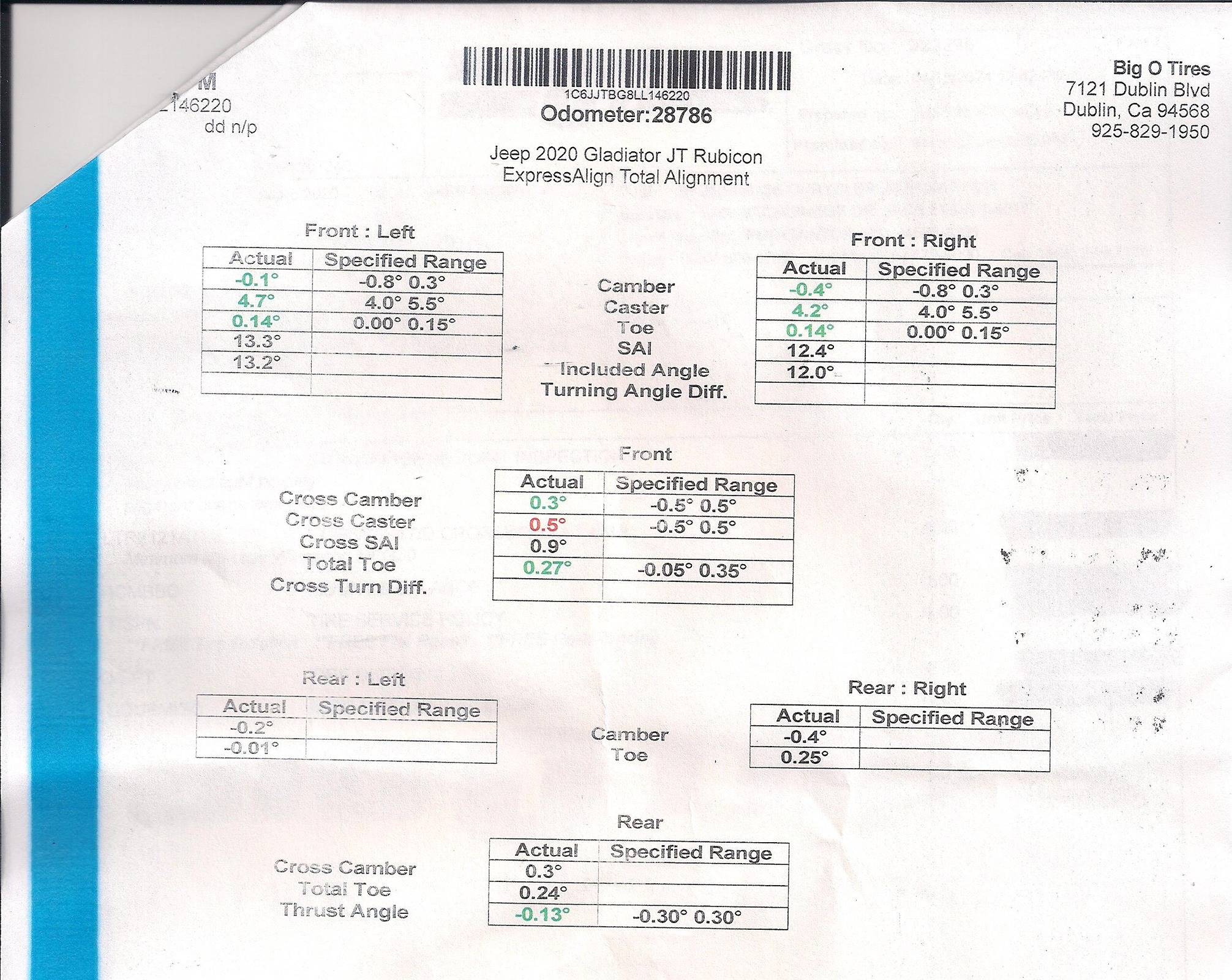

Hi there, and thank you for your input! I am learning as I go.
It is is a pull, as I must almost constantly correct it. After Trixee came home from the dealership, it’s been better, she will track straight without holding the wheel for a couple hundred feet then pull right and as I drive the curve increases.
I have carpal tunnel in my right wrist and an old shoulder/neck injury on my left side, so if I fight the wheel too much I end up in pain, both sides. My wrist hurts and my neck/shoulder hurt and start spasming.
249
40,506
54,093

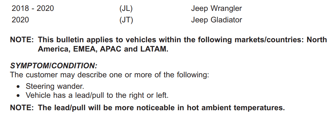

Absolutely not normal on these.
I've had two Gladiators and a Wrangler, and have driven them each across the country (some trips were literally almost non-stop, save for fuel). No pain, no aches, other than sitting too long on a 20 + hour drive from Florida back to Iowa.
It's going to require a dealer who will spend the time and effort and energy as all of the possible causes have pretty much been listed.
One thing to have a dealer check is to see if your 2020 Gladiator still has the original steering gear.
the reason I mention is because there is a TSB (technical service bulletin) that describes a lead or a pull as one of the symptoms - note the words below "has a lead/pull to the right or left". So it's possible a steering gear can cause this according to Jeep.
Jeep Gladiator Still pulling to the right (slightly) after front end alignment 1713754404230-bl
that is great information! Thank you. I kinda hammered the dealership on price for Trixee, they don’t seem willing to do much more for me after new tires and an alignment from a shop down the street, as these issues are happening not 2 weeks from purchase and it’s supposed to be a “certified” vehicle. They didn’t even replace the visors that keep popping out of the frame (was gonna chat at y’all about that one too, but I saw a fairly inexpensive solution online today, and it’s apparently a common problem), they just tapped the visors back in place and the first time I touched them they popped out again. Ugh Actually the visor popped out during my test drive. ?

So,,,, what is the cross castor?
What is the toe?
Too bad y'all live so far away. I wish I could have someone help to educate me and coach me in person on these issues so that I know what y'all are talking about! ;);) I eventually would like to do the work myself,, if I ever learn enough. :fingerscrossed:
THANK YOU to all who have answered!! ?
here, ask the dealer to loosen all the front control arms and retorque to spec. this should realign all the arms. then get an alignment to center the wheel. after that it should only have pull to match the grade of the road your on. grade being the slope they build roads to assist water runoff. you'll never get away from that counter steer to stay straight on some roads. Thats just the nature of Solid axles. I hope they resolve your issues. but tbh this is one of those thing where internet diagnoses can only go so far. we can't turn the bolts, or get eyes on the actual problem. This is all just imaginative speculation on our end.
edit: After looking at @ShadowsPapa respones (educational and informative as always). And noticing your truck is a 2020. I would also like to suggest having them check to see if you have the aluminum steering box that may be going out, or the the steering gears like others have mentioned.
