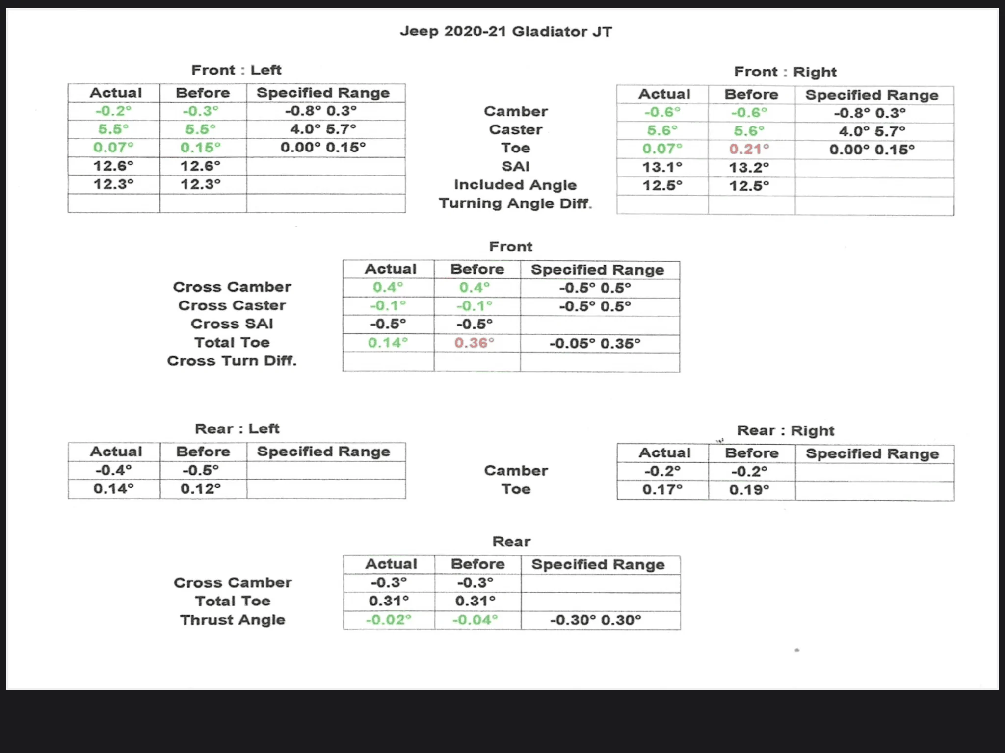

After my 2.5" lift and 35's went on my JT's wandering was much worse and had a pull to the right. It was really bad to the point it made driving it not as fun as it should be. This is my first Jeep and first truck with a SFA so I thought it was a Jeep thing but it really bugged me how bad it was. After looking into ways to possibly fix it it seemed that half of people said get an adjustable track bar and the other half said adjustable lower control arms. I have a friend that works at Off Road Warehouse and he gave me a really good deal so I said screw it and got both the track bar and lower control arms. I have a Terraflex lift so I went with Terraflex Alpine track bar and LCA's. After installing those and giving it a good alignment holy crap what a difference it made. It was like driving a totally different truck. No wondering, no pulling, the whole front end just feels tighter and I really can't believe how much of a difference it made. I expected to feel a little difference but it made a HUGE difference. This thing drives amazing now!

What were the caster numbers after the alignment?

Iā€™m glad your rig is driving better but the only difference in those numbers is the toe. Thatā€™s a lot of money to have someone adjust the tierod.
Iā€™m on my phone though so maybe Iā€™m just missing something.
maybe it was the track bar along with some toe that made a difference. I dont know if any of those numbers reflect a track bar adjustmentā€¦I have a hard time believing it was just toe that made the difference I feel but if it is than that was the best $1000 alignment I ever had šŸ˜†

Were the before alignment numbers were with the new parts? based on the OPs description it read like the before specs were with the new parts and they just adjusted it from there. My guess is the caster made the most difference.

The big takeaway here is the Solid Axle does not have inherent wander and pull. Its one of those myths that just wont die.
I do wonder if the bolts may have been loose and in the process of installing the terraflex parts that was corrected.

The "before" measurements were likely taken after the new parts were installed, so the caster numbers were probably lower before the new control arms, plus centering up the axle with the new adjustable track bar. Those two things plus getting the toe set right would def make a lot of difference.
Good point. The before numbers had to be with the new parts, they wouldn't get the truck all set up on the alignment rack just to take before #'s with the old parts.
