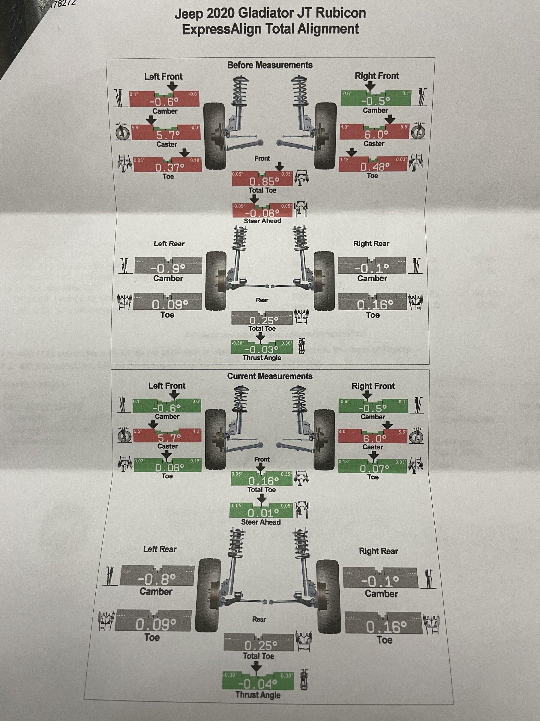

Well not to hijack the op’s thread but I am also having the same right pull on my JT. I am running a MC 3.5” lift, 35” tires. The Jeep has been aligned and the tires have been rotated and balanced twice now with no change. I pulled my factory SS and the pull is not as bad but is there. I don’t seem to have to fight the wheel as bad with the stabilizer removed. I just don’t know what to look at or fix at this point. I was about to purchase a through-shaft steering stabilizer as I have heard that it has helped others. But I may look at holding off!
the only thing I can think of is to check is to see if your axles are centered Since the Metalcloak kit comes with both adjustable trackbars.
Well the pull started originally after installing a Tera flex 1.5” leveling kit and the tires. Leading to what I thought was a radial pull. But even rotating the tires around there is no change. But the axles are both centered up. But will remeasure again. But as mentioned I know of 2 JT owners personally that have corrected their right pulls with new SS. I am also waiting on MC to get back with me on some recommendations. I have also sent them the same information I have provided here.
If the axles wasn't centered. It would show up on the alignment. The Thrust Angle would be off.
