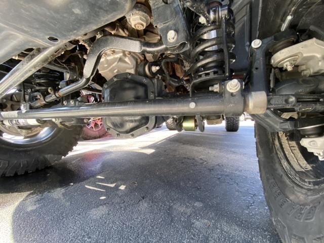

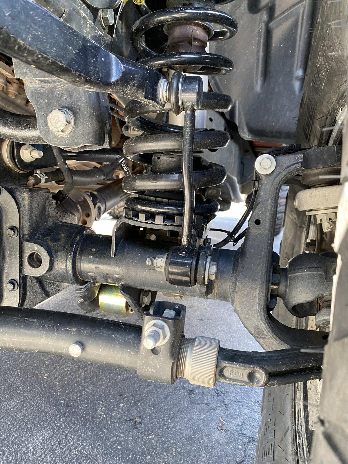

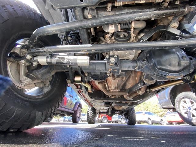

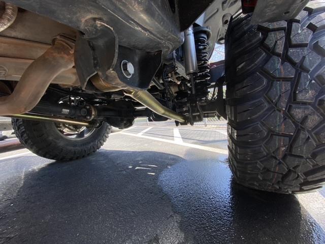

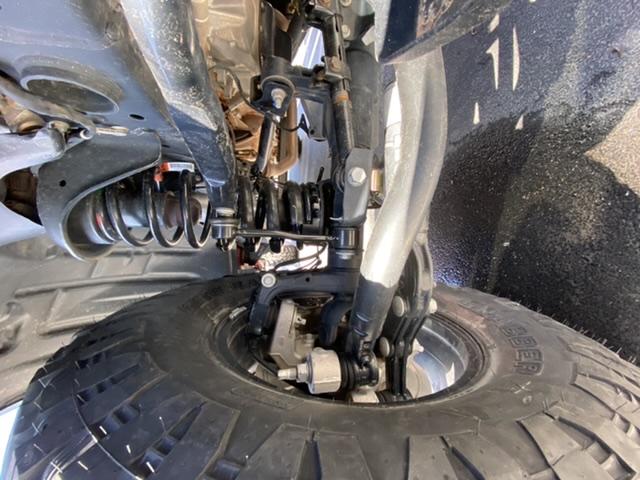

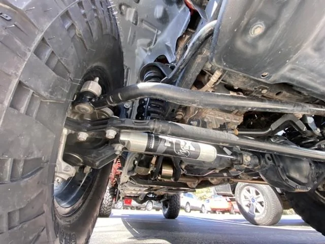

Here are some pics not sure how helpful they’ll be.
