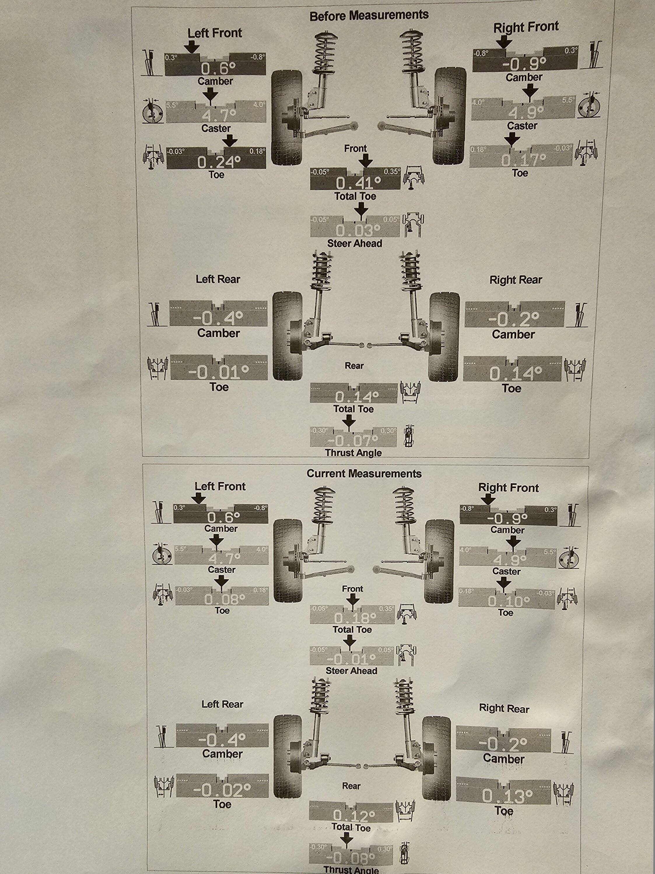

If I took my hands off the wheel it went hard right and I'd be off the road very quickly. To keep it straight I had to hold the wheel turned to the left.
They test drove it after the alignment and said it was done. Issue remained.
Could they have adjusted the steering wheel in the wrong direction?

This is EVERY road 100% pull to the right, its not me pulling my own truck off the road lol It requires near constant correction. I have had the tires rotated and balanced several times and nothing ever changed. I waited for warmer weather figuring tire pressure inconsistency. I dont know what else to try or do about it.
I get what everyone is saying, correcting the steering shouldnt change the tire direction. Im just wondering if they didnt adjust it the wrong direction. It was worse after the alignment. These guys literally had it done and test drove in 10 minutes. I know there isnt a bunch to adjust here but it didnt seem right. Hell they wanted me to pay before they even gave me the results.
Im still going to try and get the tires swapped and confirm it doesnt follow a tire.
Im also still going to torque all the steering and suspension components.

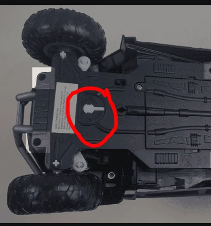

if you climb underneath there's a plastic tab for adjusting the steering. Just click it a couple times in the direction you want it to steer and drive a short distance to verify if it worked.
Reinforces my suggestion for more toe out.
